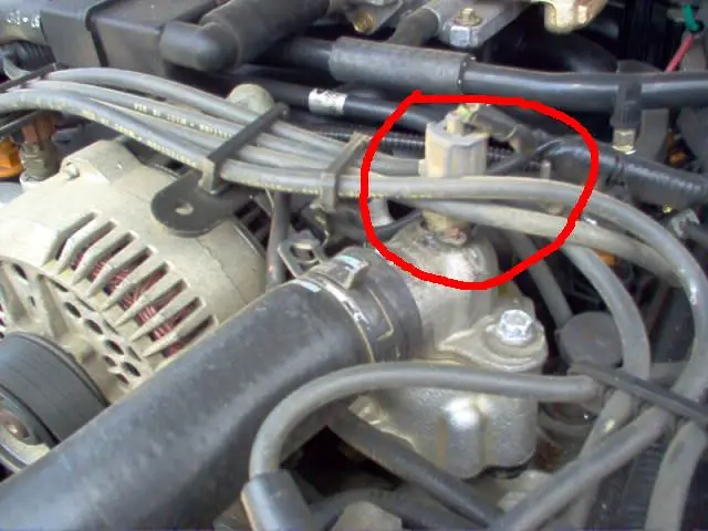

i think there are a few places to tap into for the gauge.my friend tapped mine into the thermostat housing on top.as for the extra one,i'm not real sure.where is the extra one located?

mrvax said:
On my car they just tapped right into the t-stat housing. The gauge works fine.
you have an all plastic intake? this guy swapped a 2000 engine in...they have the all plastic PI intake and I haven't seen anyone tap that yet. If you do and you did....please let us know how. I know a few people with this problem. Thanks
yes tapped into the t/sat housing and all is fine.here is a pic to show you where mine is.pay no attention to the dirty motor,i live down a gravel road so its only clean on the weekends :shrug: .
