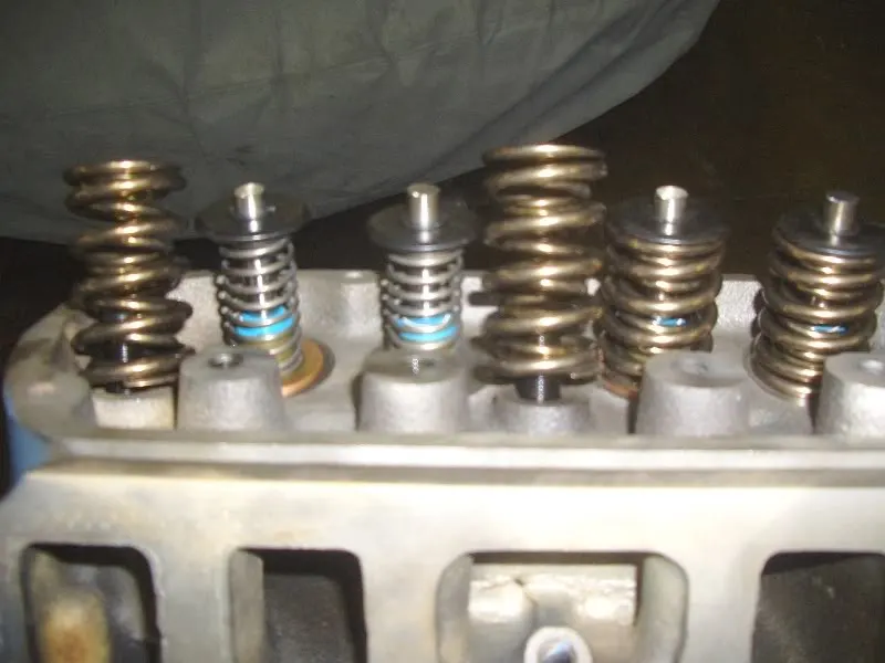

TFS stage 1 cam and Trickflow spring kit for Ford iron heads. The TFS spring kit comes with the different height retainers to make up for the height difference between the exhaust and intake valves.

I used to have a Bcam with the gt40p heads. It was a nice cam, sounded real good and pulled hard. I know the heads had some kind of machine work dont before I bought them, and the valve seals on them were definately changed, but the retainers were stock, so I cannot confirm whether the springs were the stock explorer springs, but I never had a problem with them (from what I can tell) but it really wasnt the best Idea, I should have changed the springs, 130 bucks is nothing for insuring your motor.

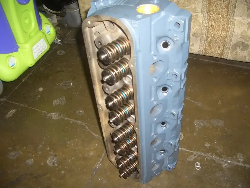

I just ordered a tfs cam and I ordered that same tfs spring kit ryc cukr posted a link for. The kit is real nice, it comes with everything, springs, retainers, shims, seals, keppers, and spring height tool so you can install them yourself. I just finished assembling one of my heads yesterday and it took me about an hour. Theres a forum on corral talking down about the tfs spring kit, and the keepers they use, but I have yet to see someone have a problem with them or destroy a motor using that kit.
I dont know how it runs yet though as it is not put back together, but I am going to assume it will run ALOT better.
