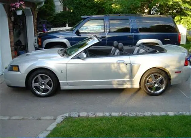

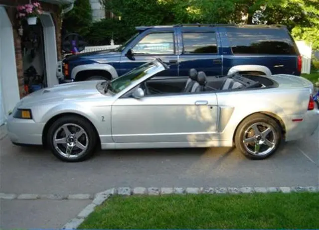

I gave him the idea to wait until the warrenty is up, especially on a car that is the first year of its style. Who knows, at 42,102 miles the fuel pump in every car may explode. :rolleyes:
Anyway, I only have one good picture of my car (I really need to take more), so I'll just post it up here for you:

Nice 'Bra 03 SVT! Mmmmm...
