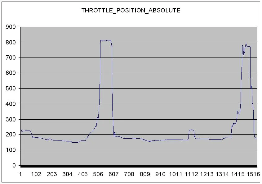

Ok... for future reference... incase anyone else ever has this issue... LOL!
Here is what my X-Cal2 capture on the Throttle Position.... The 2nd WOT is the one that had the problem...
