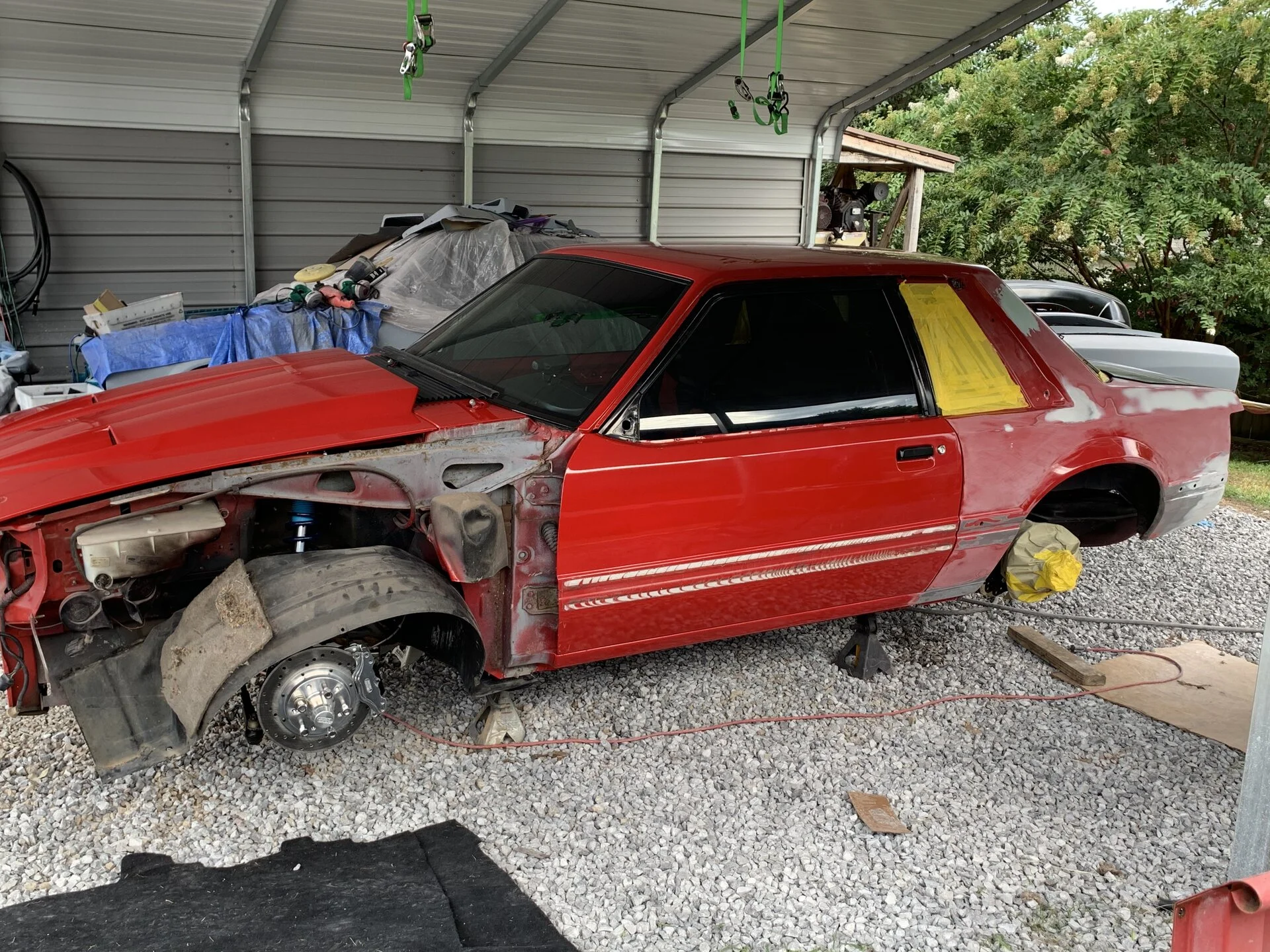

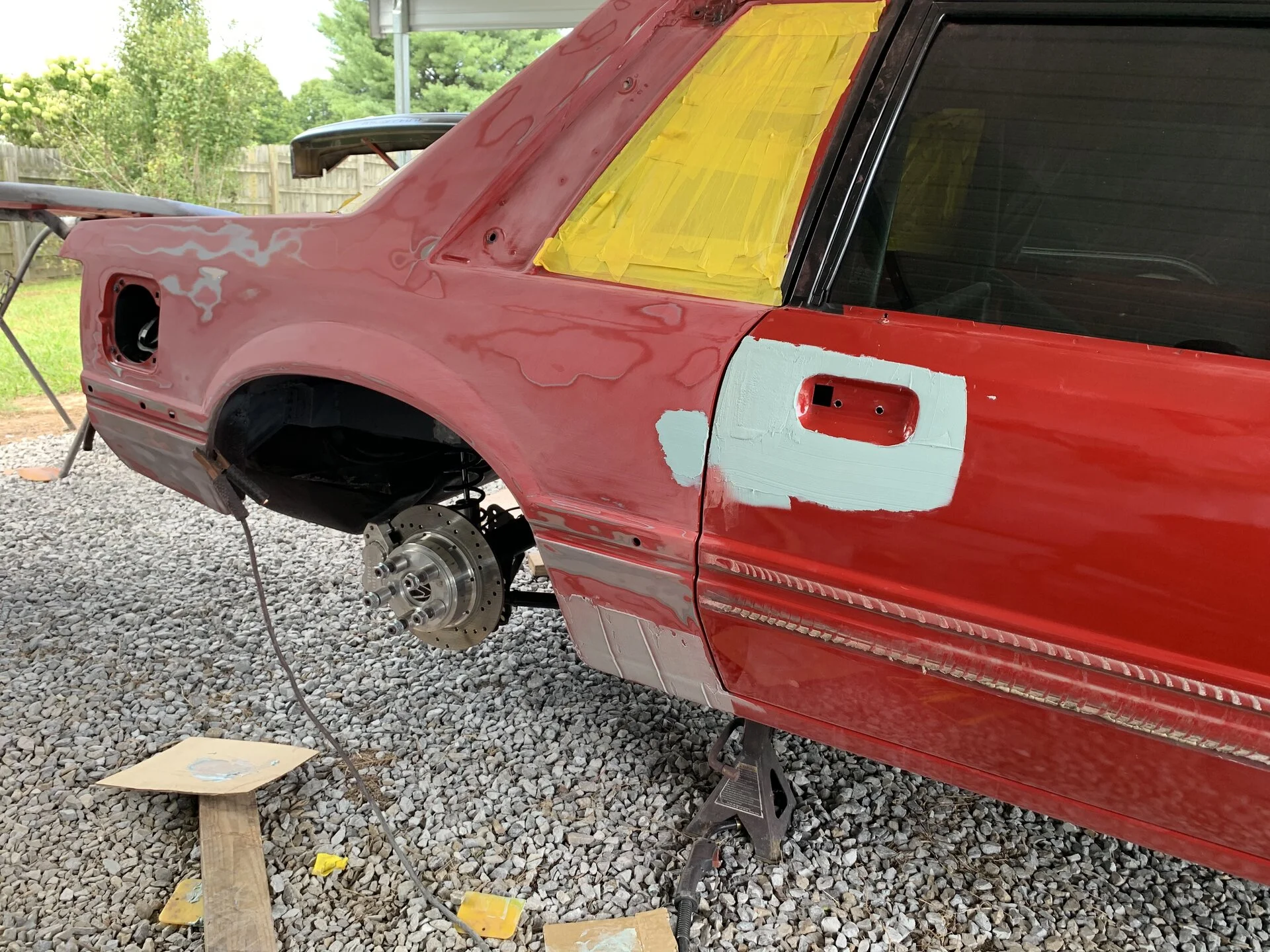

Progress Thread “Rising from Ashes 4” 93 Notchback build

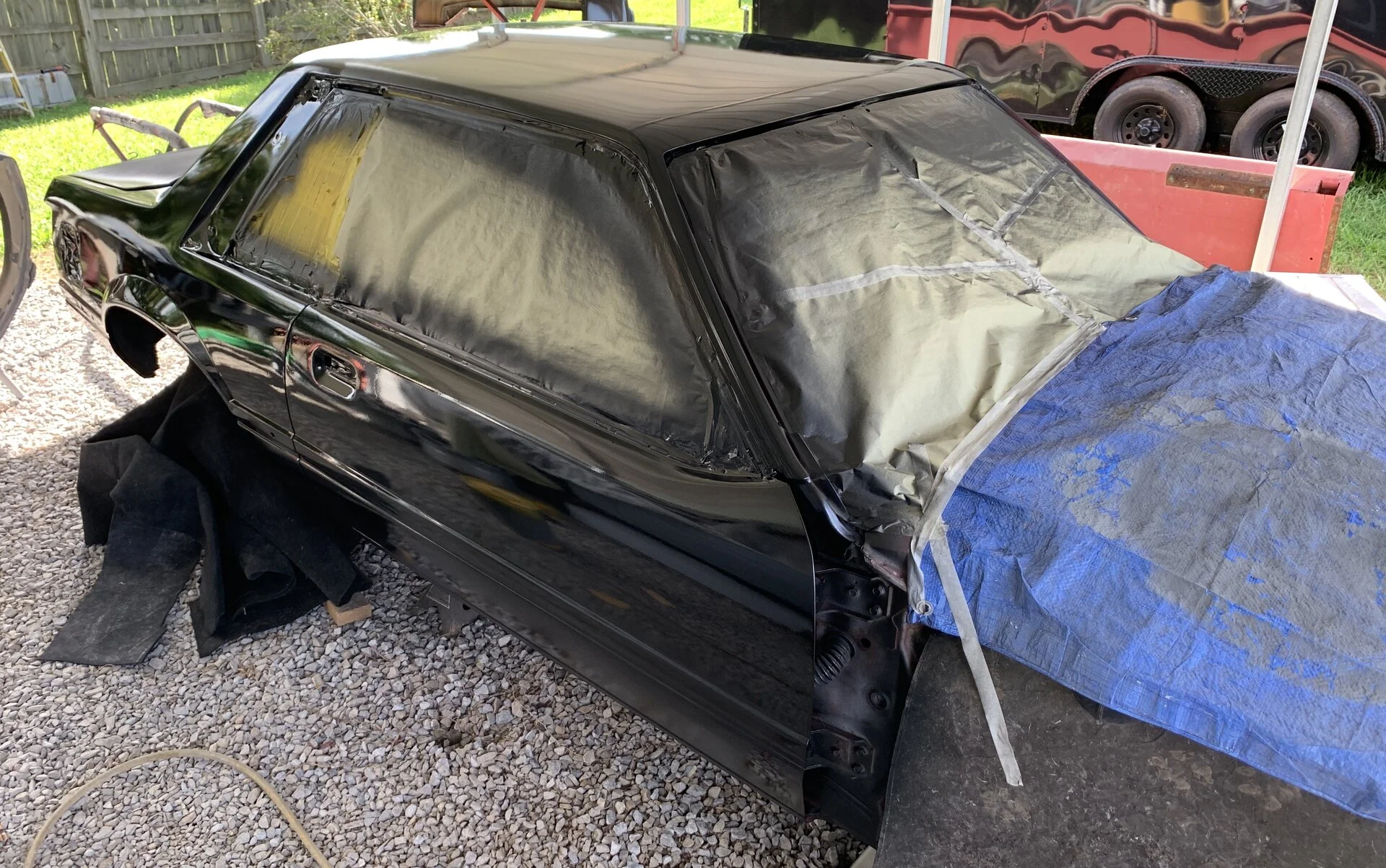

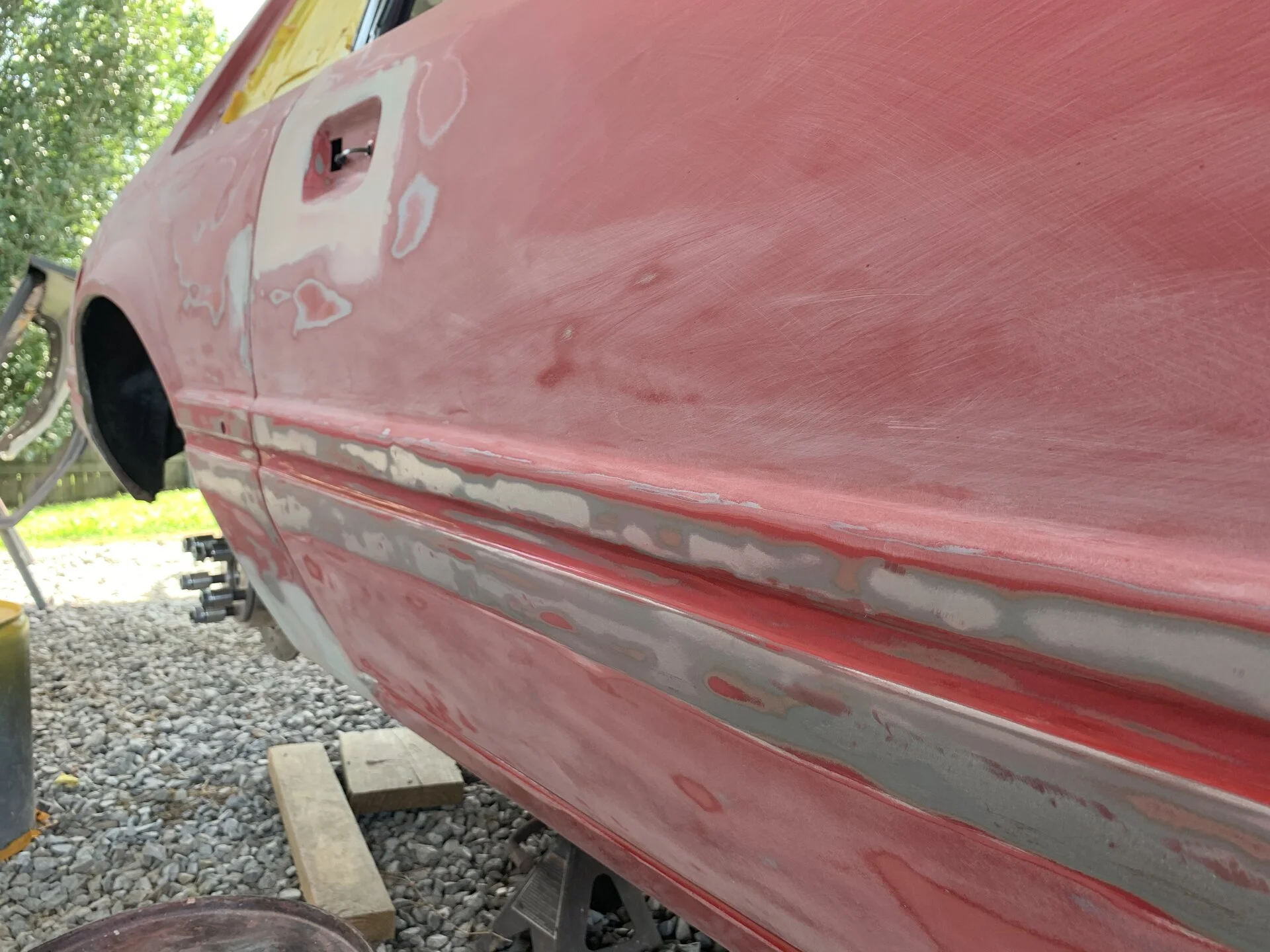

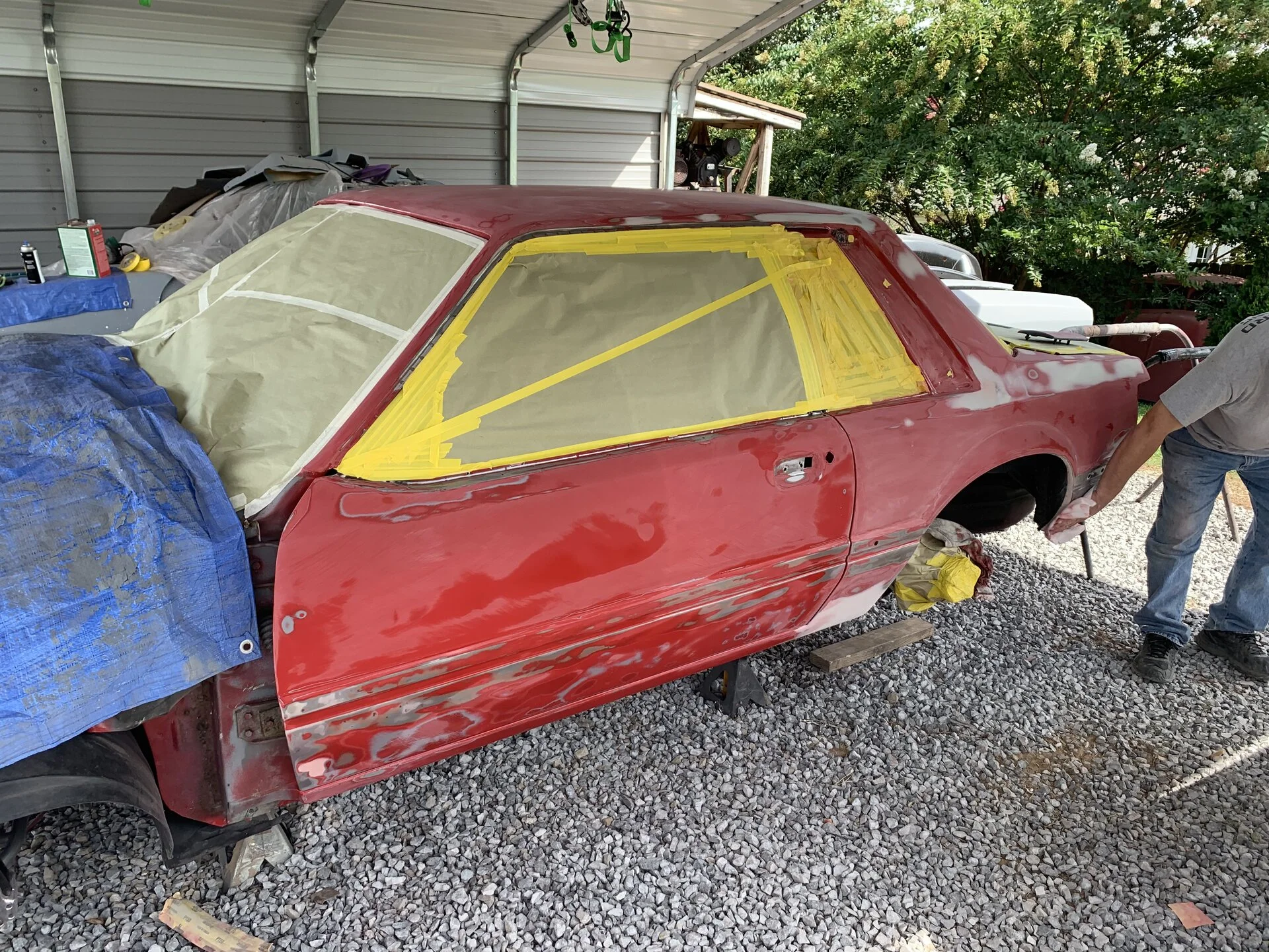

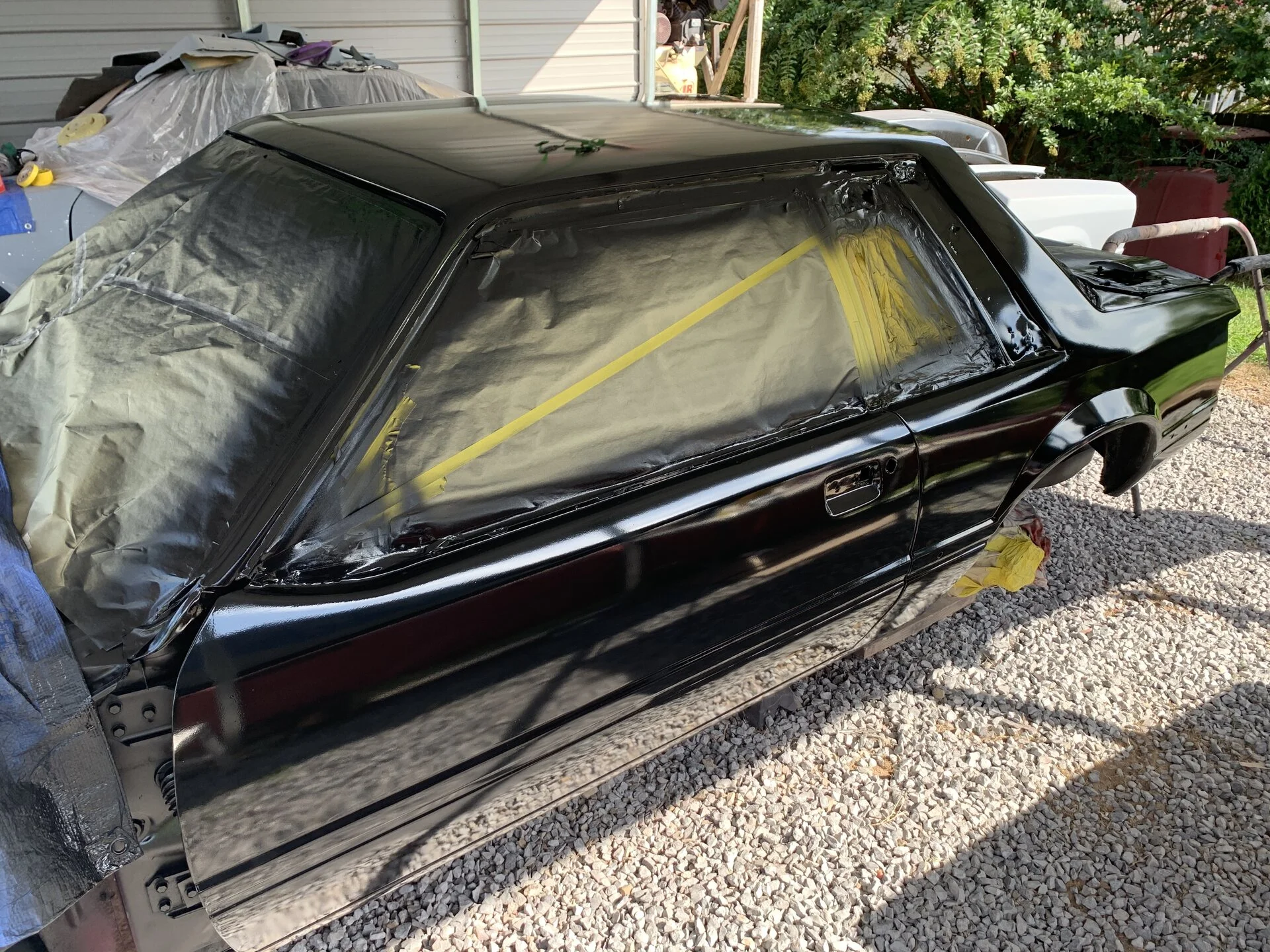

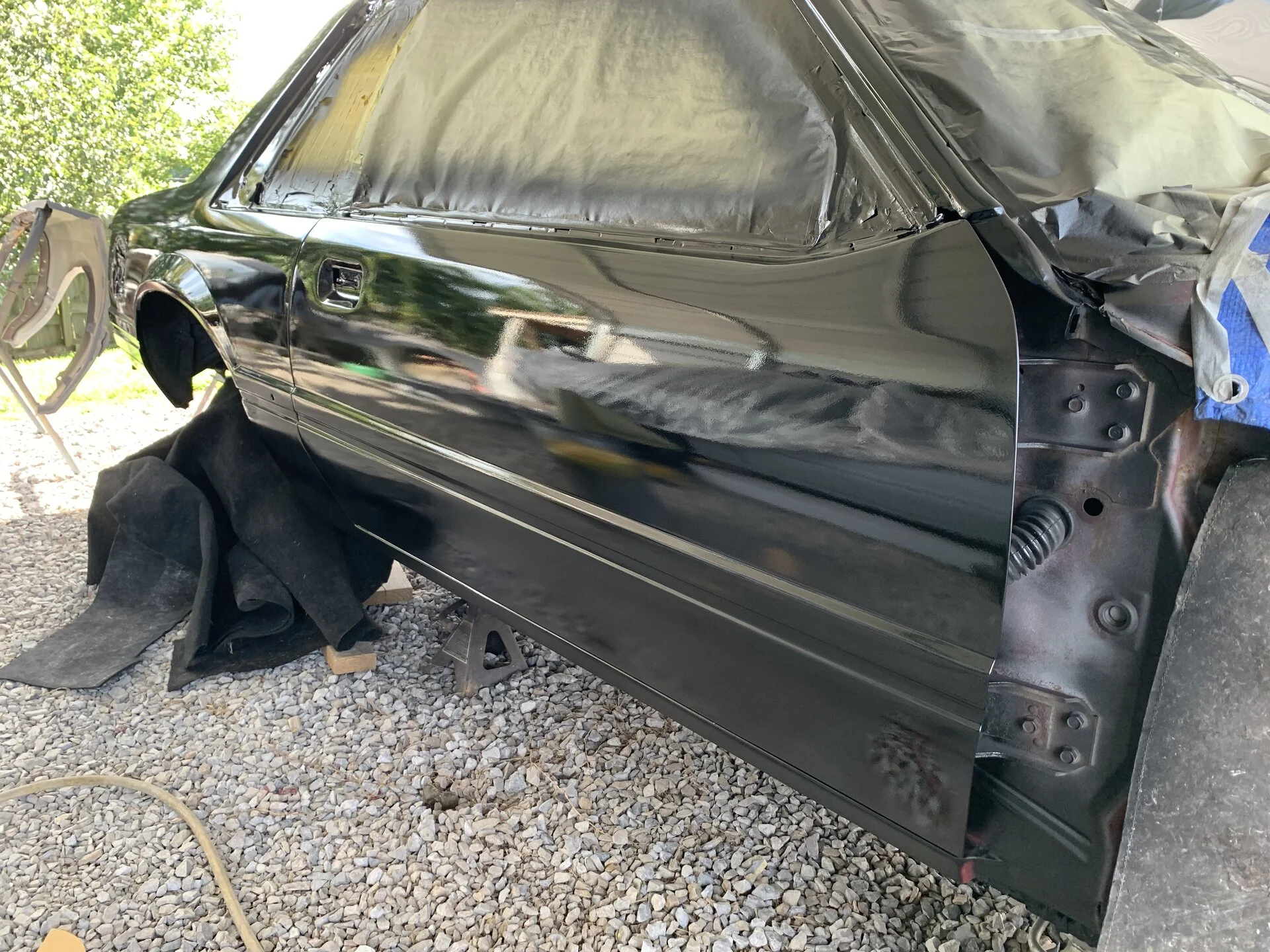

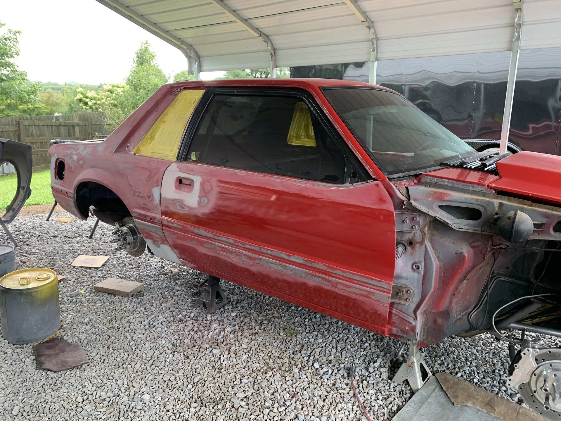

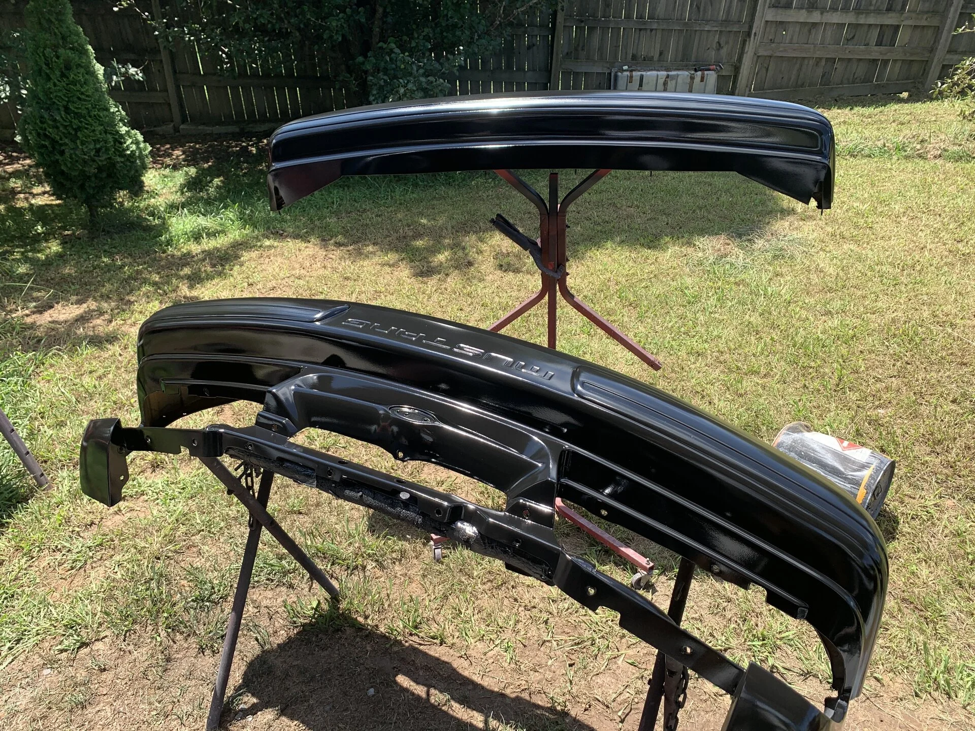

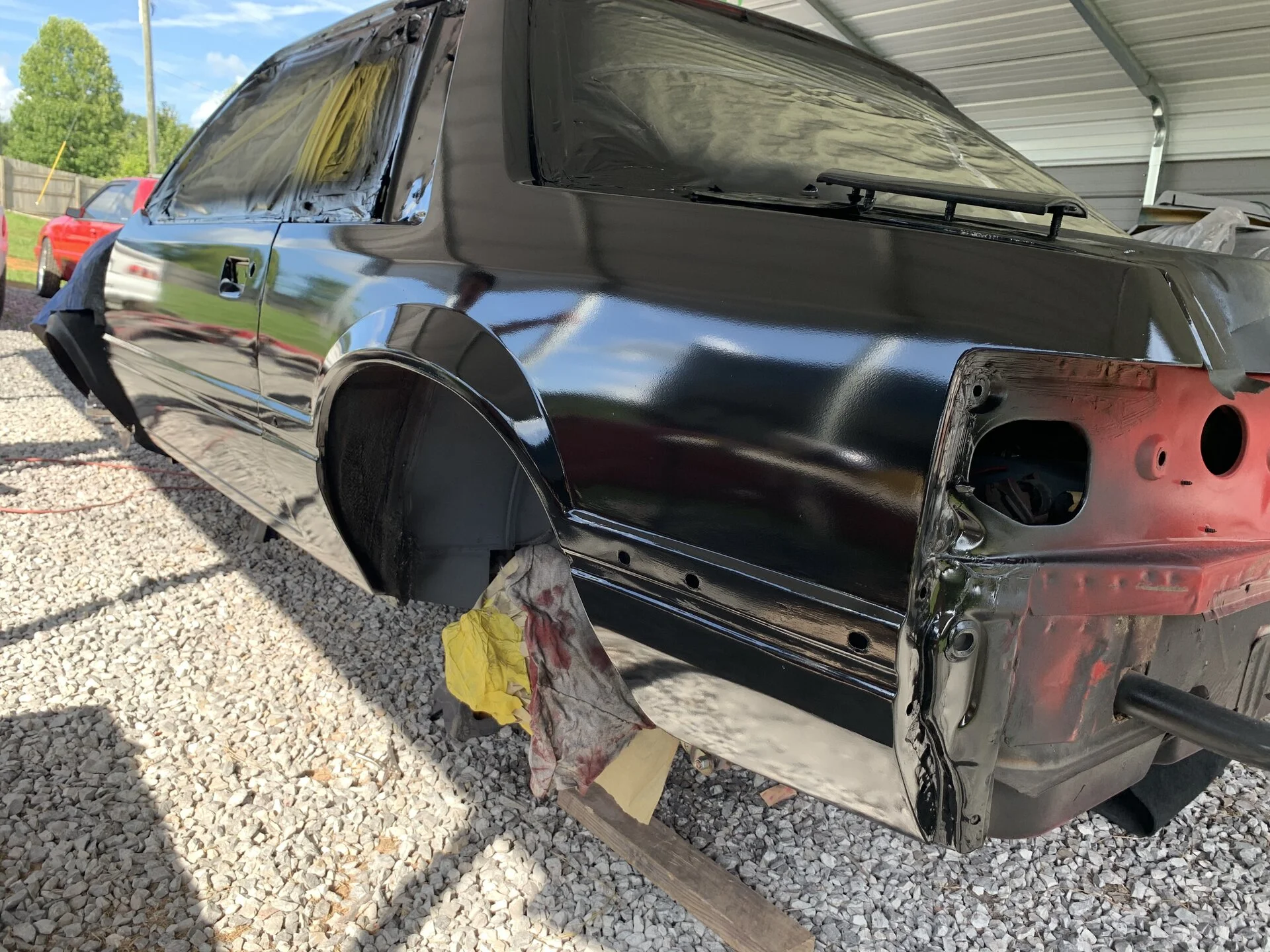

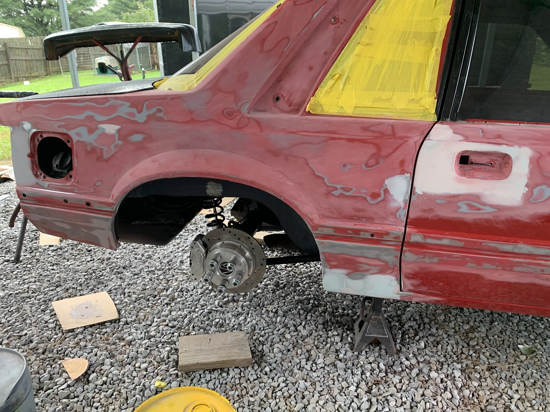

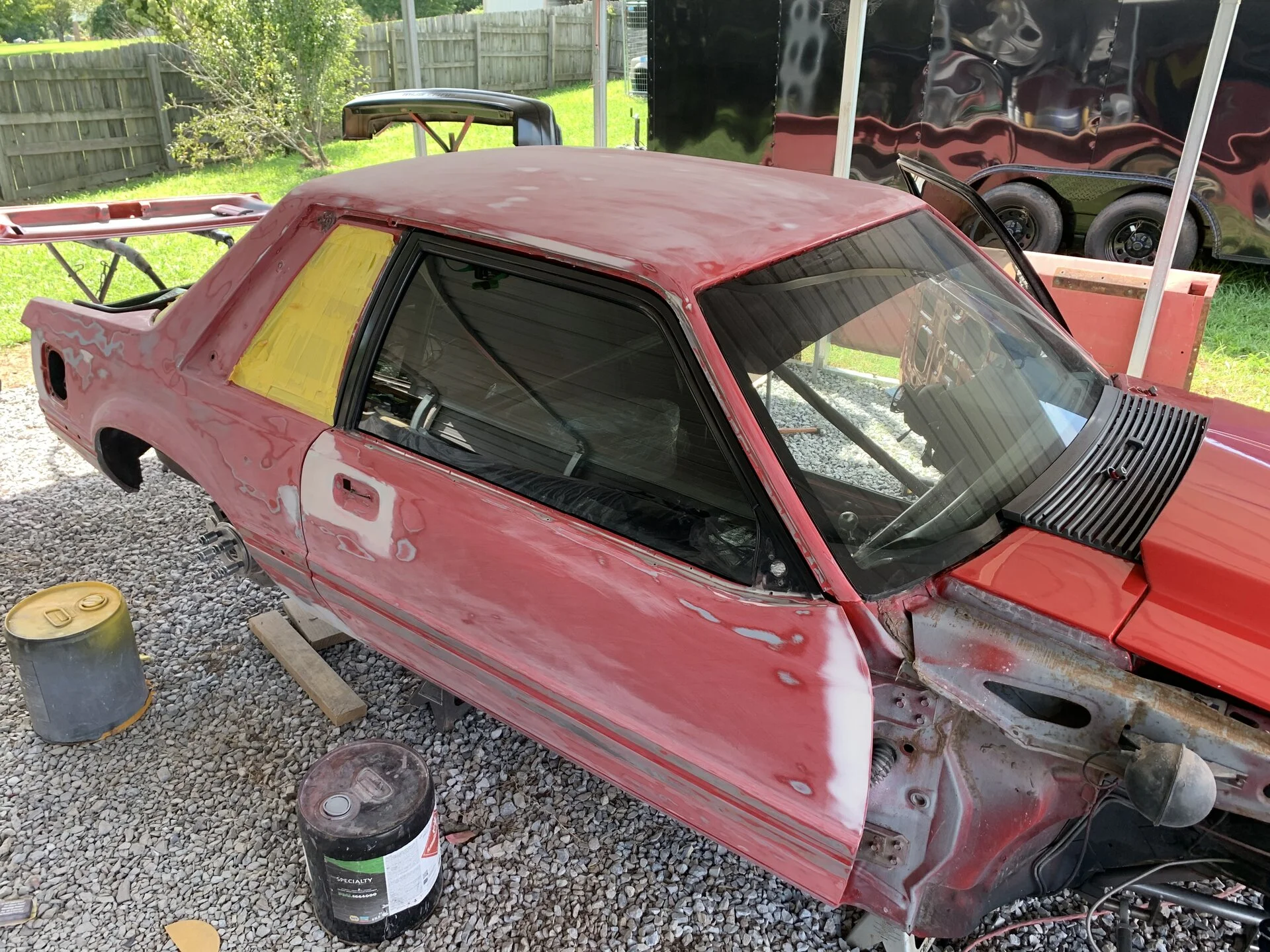

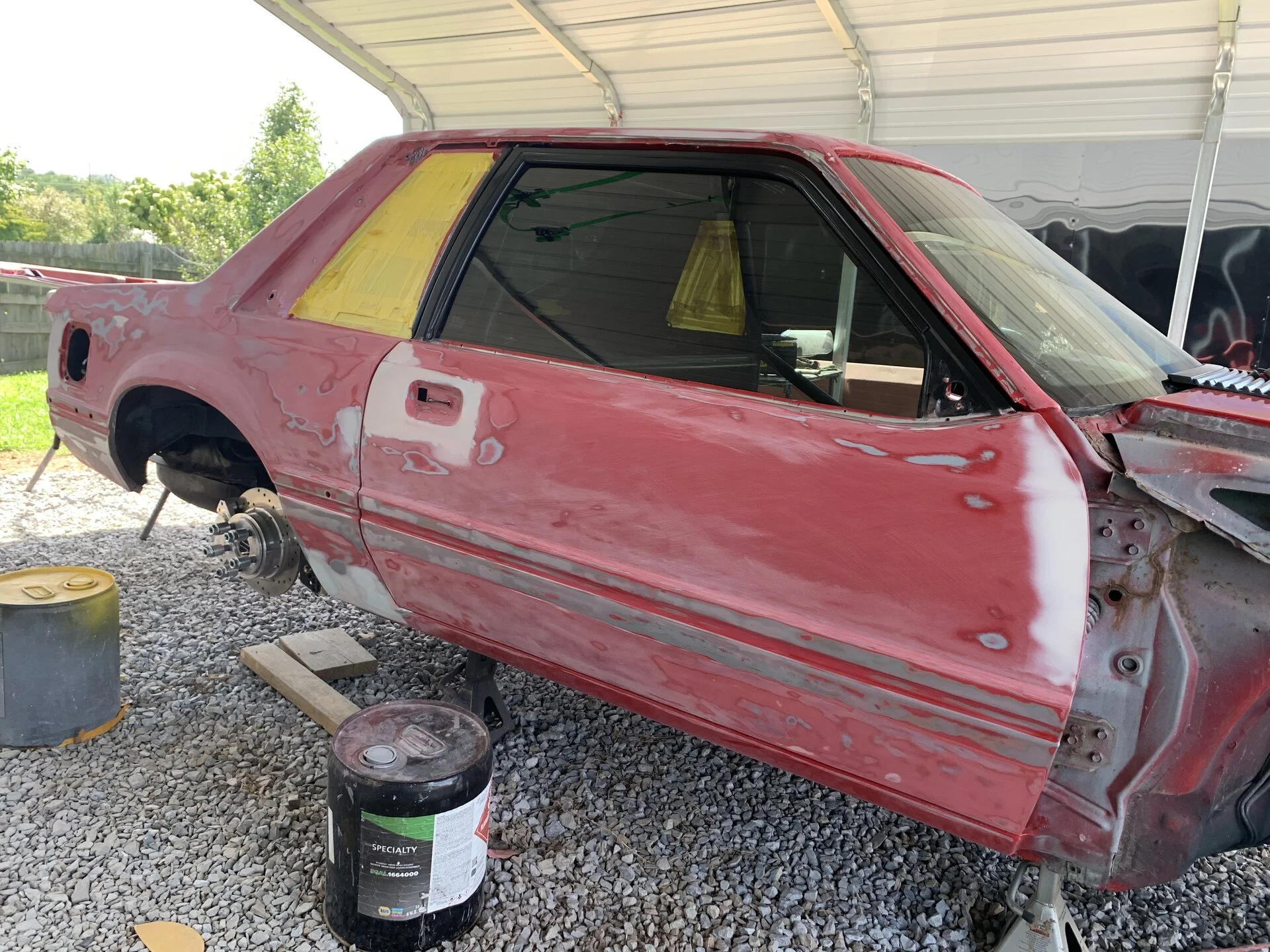

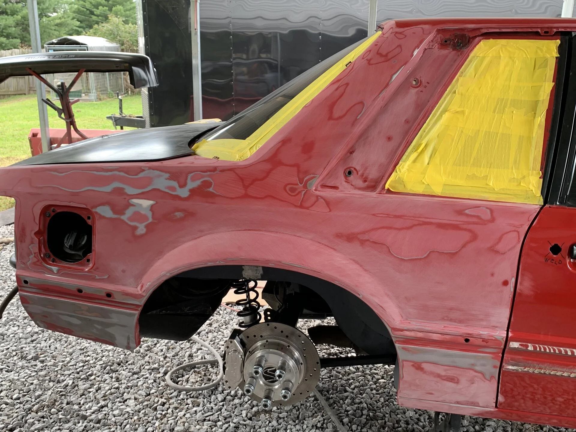

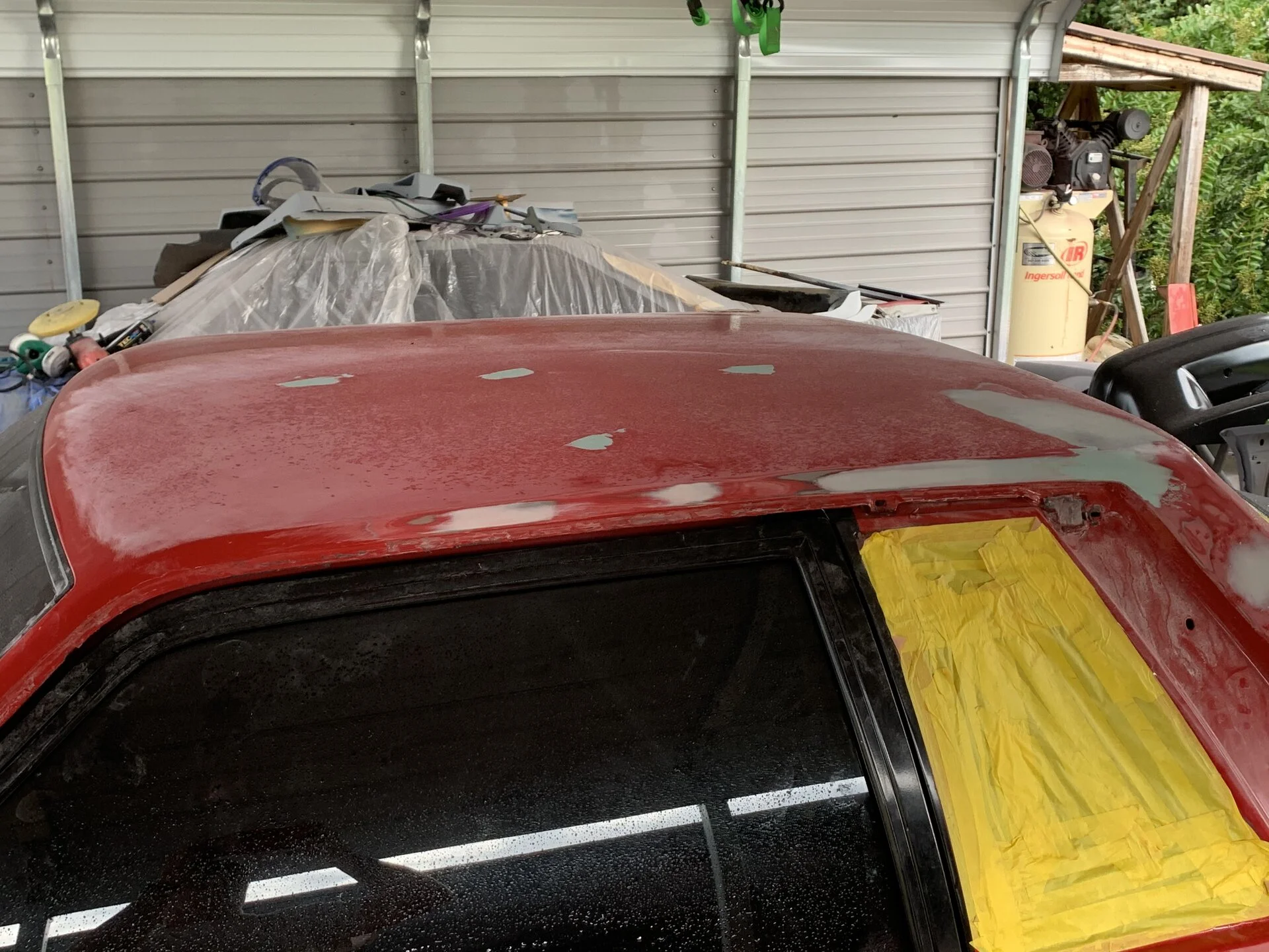

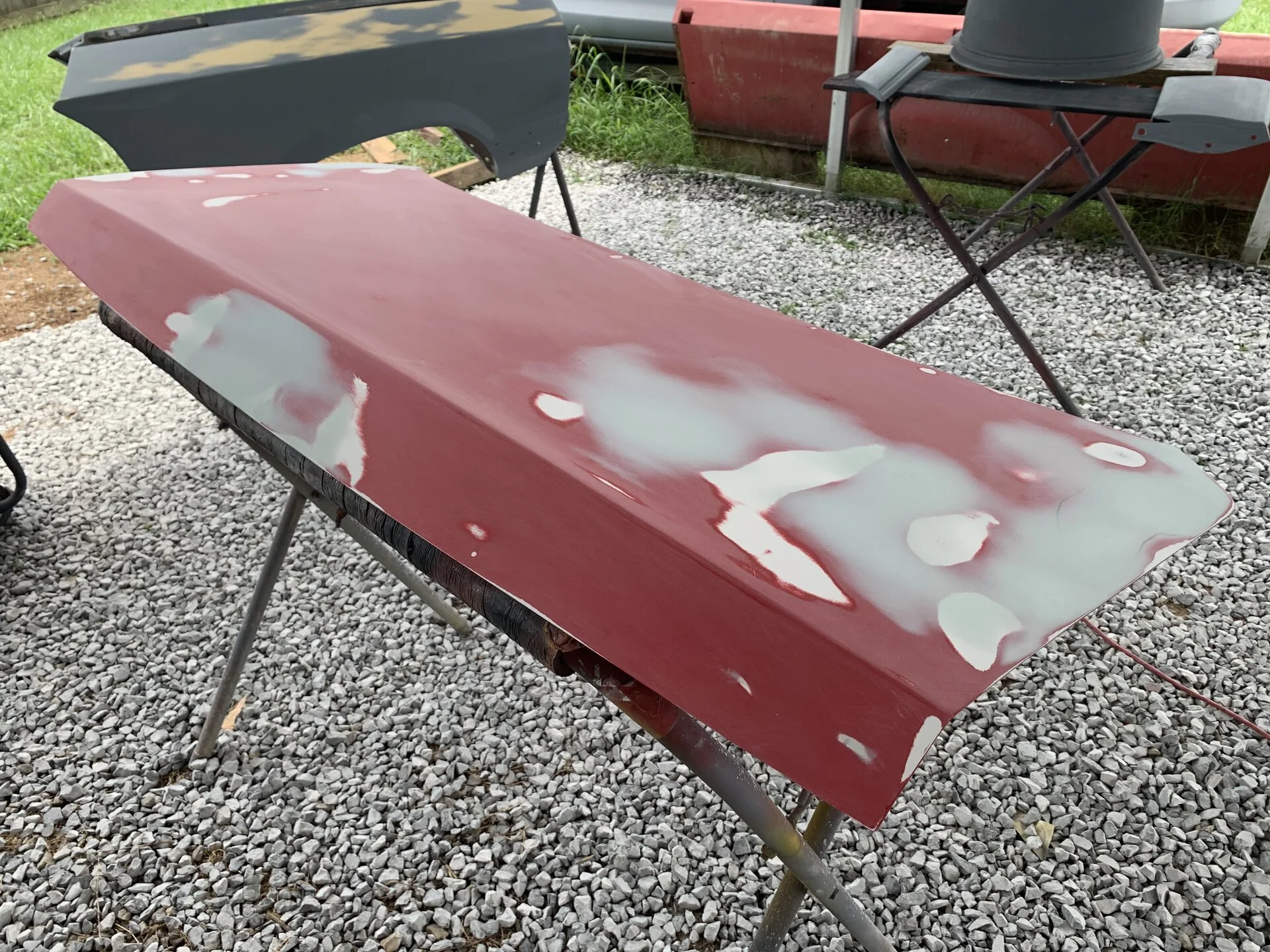

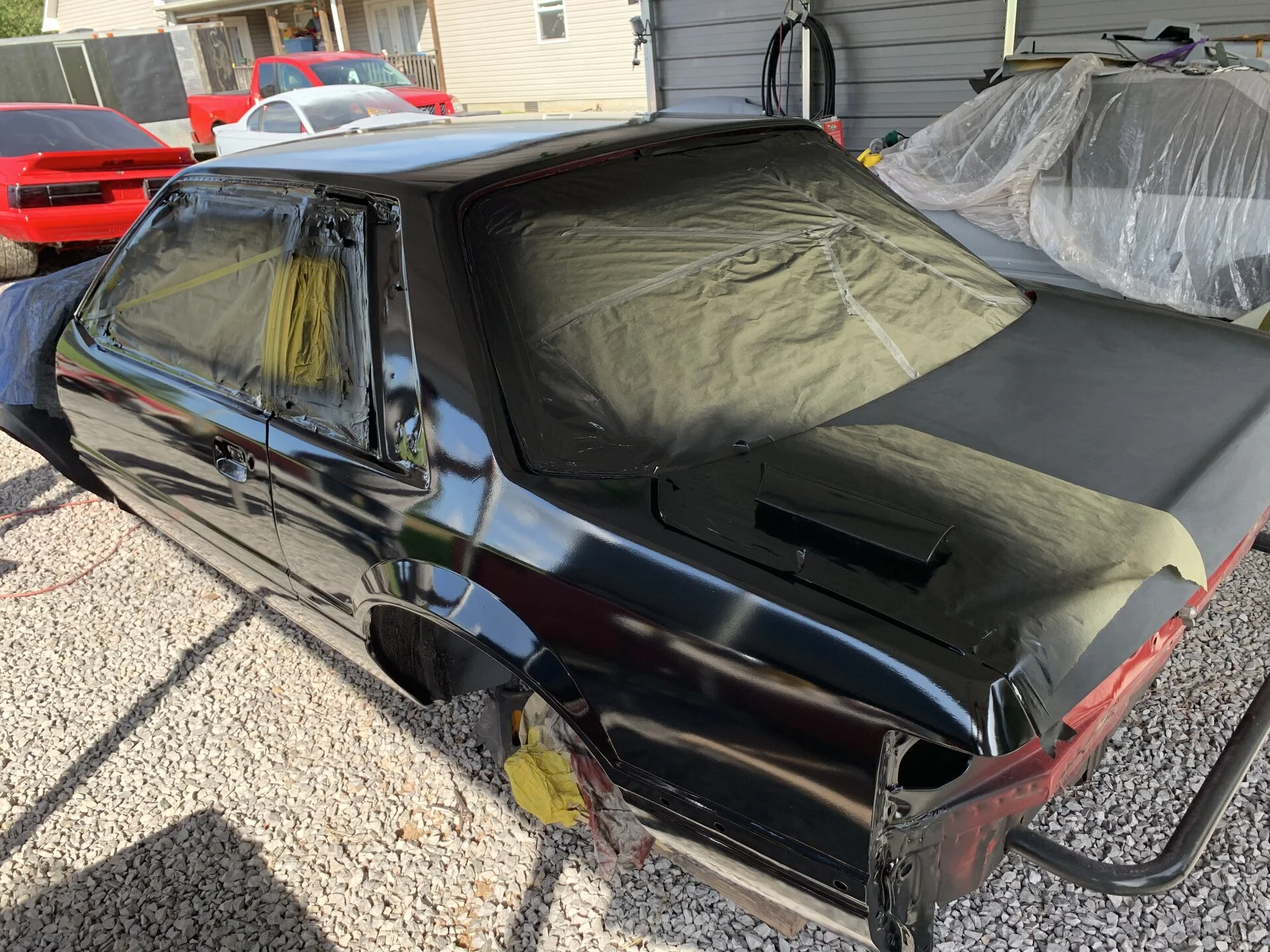

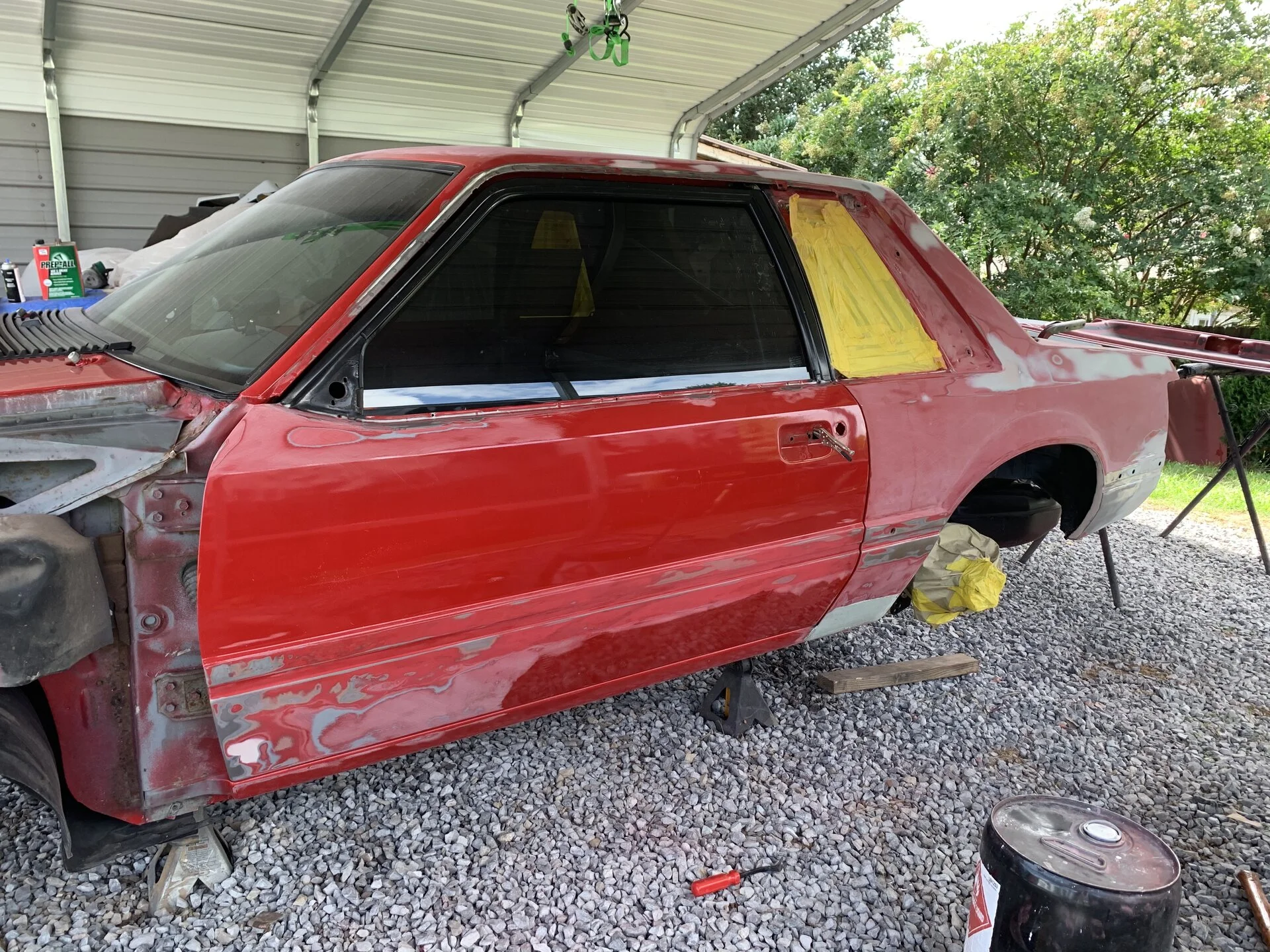

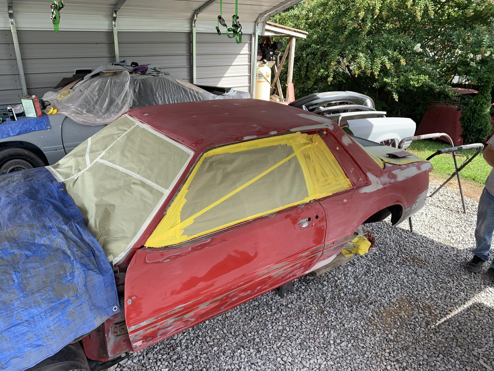

So it’s about time to pour gallons of primer on this thing and go all out on it. No more playing around

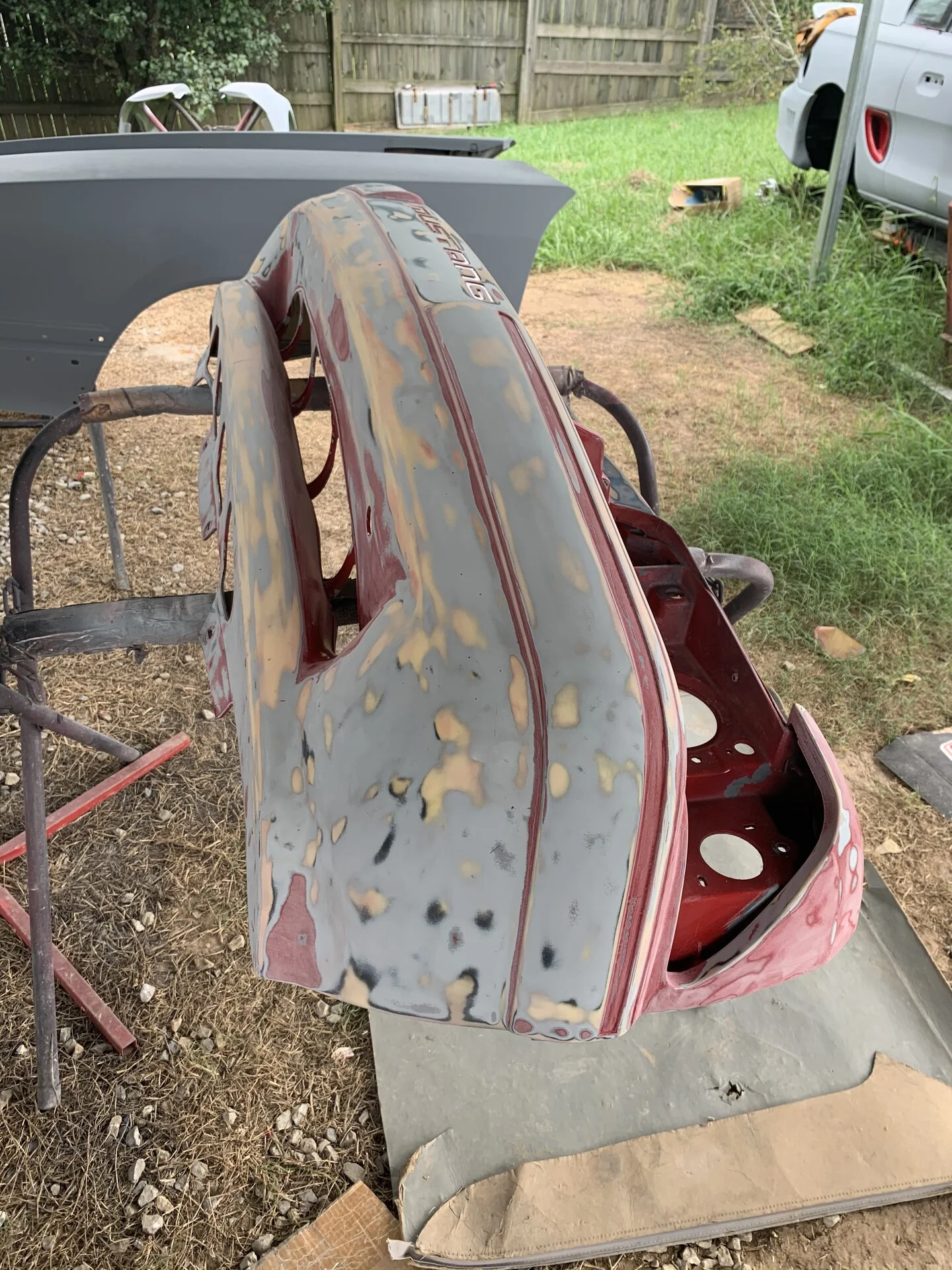

whoops!!! Pretty good hit there

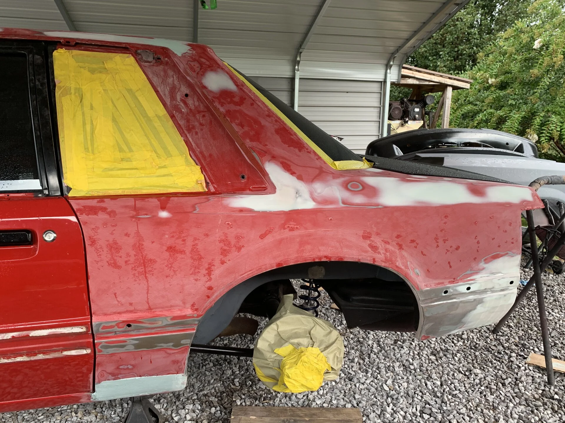

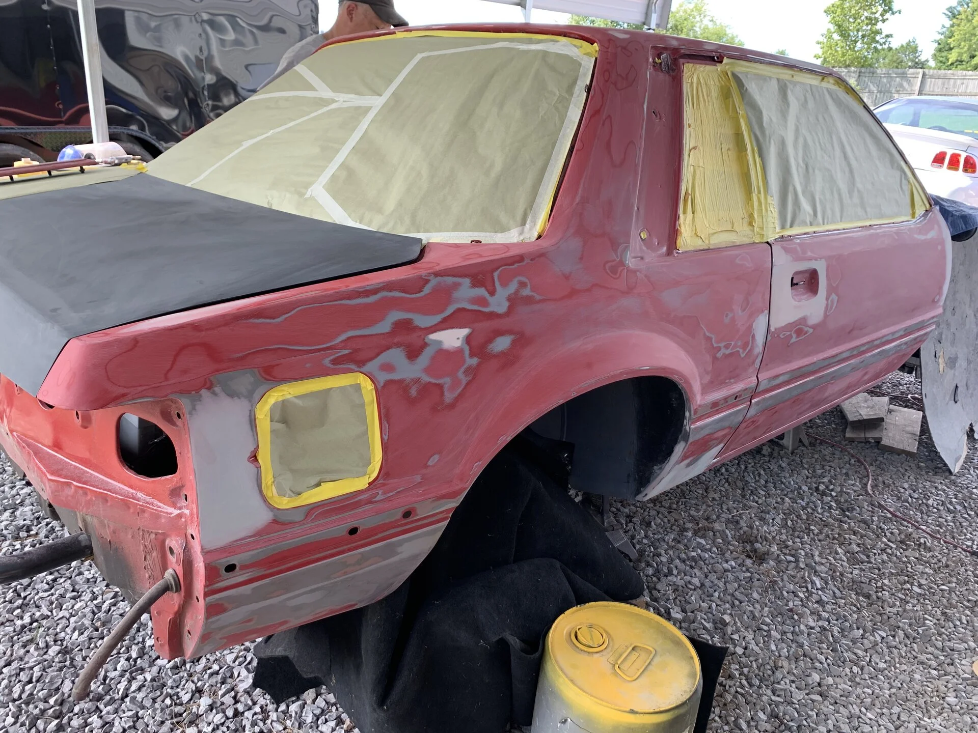

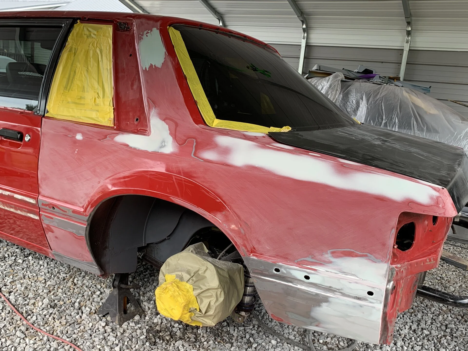

Now this will be interesting. I'd like to see your take on rust repair.

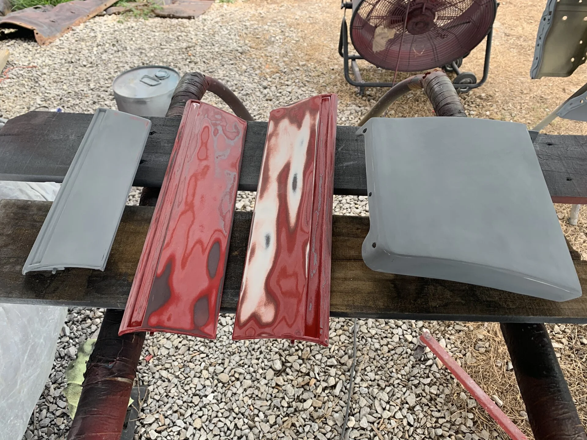

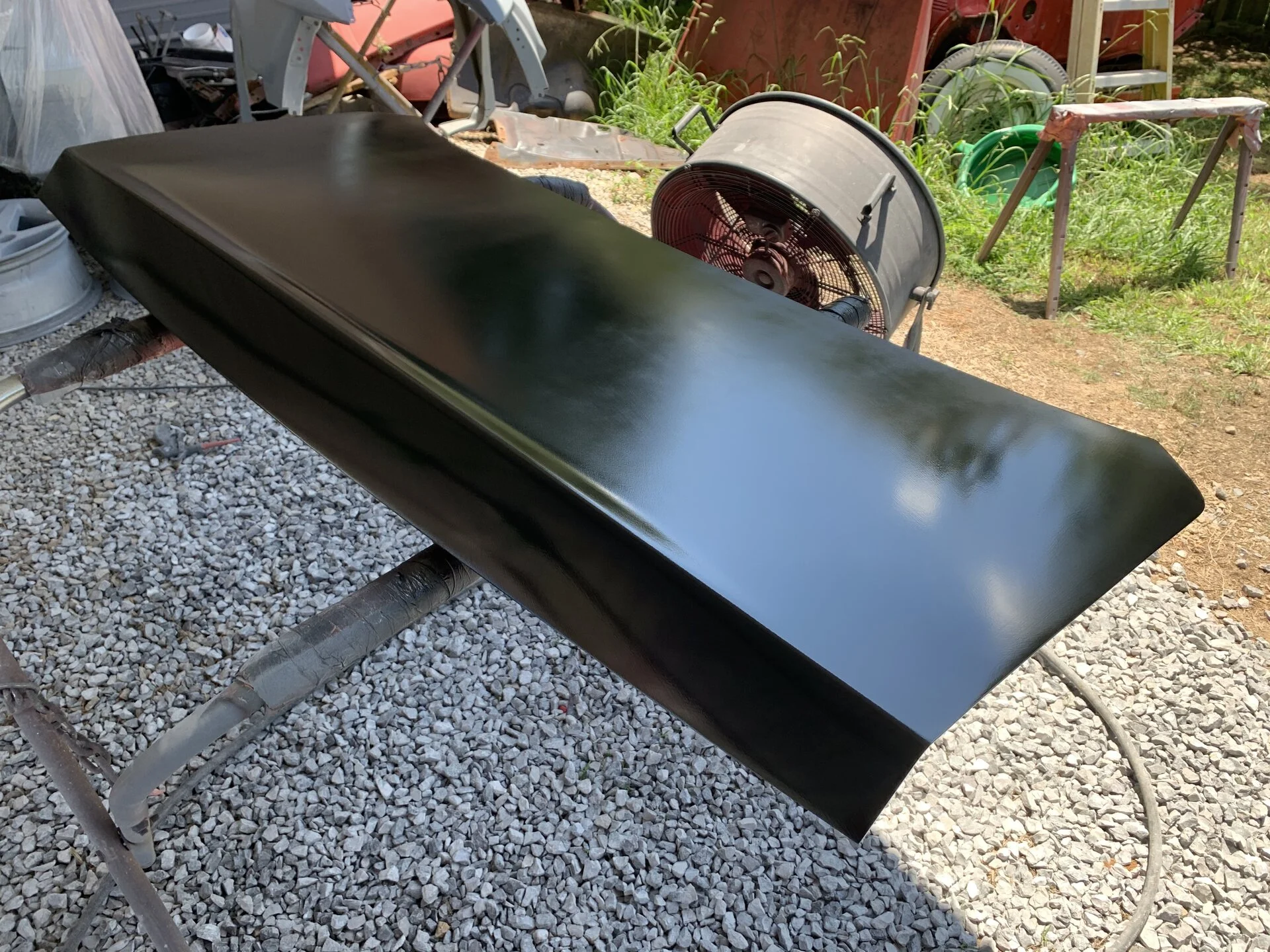

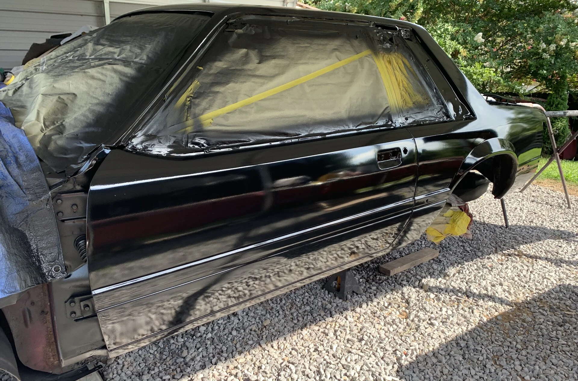

Is that a DTM epoxy? What product do you normally spray first when you strip to bare metal?
I'm looking to use a dustless blasting process to strip my '66. I'm sure I'll want to get it coated in something quickly.
@02 281 GT
Yep. That’s what you use. It’s a dtm primer and made for bare metal. What you want to do is have the car blasted...then when you get it back. Sand it with 80grit on a DA. Then pressure wash it. Wax and grease remover and finally 3 coats of SPI black epoxy. I’m doing a 56 F100 that’s being acid dipped. When it gets back, I’ll be doing that process as soon as it’s out of the enclosed trailer
@02 281 GT
About how much would I need for three coats on a '66 Mustang coupe? And where do you usually get it? I can't really find a place to order any online.
The company I'm planning to use is mobile, so I'll be able to do that process all in my driveway.
Id get a gallon of the epoxy and 1 gallon of activator which gives you 2 sprayable gallons. It mixes 1:1

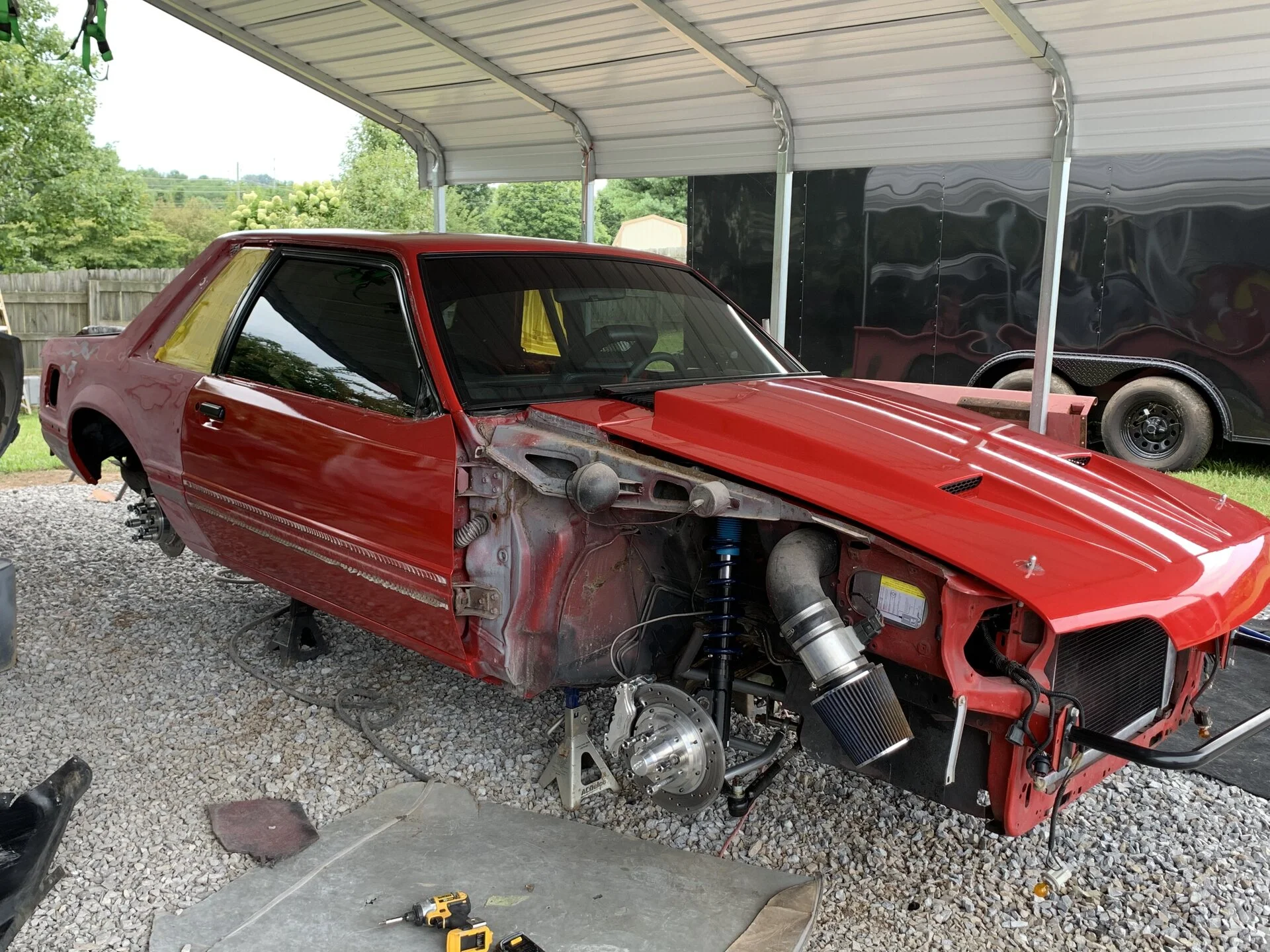

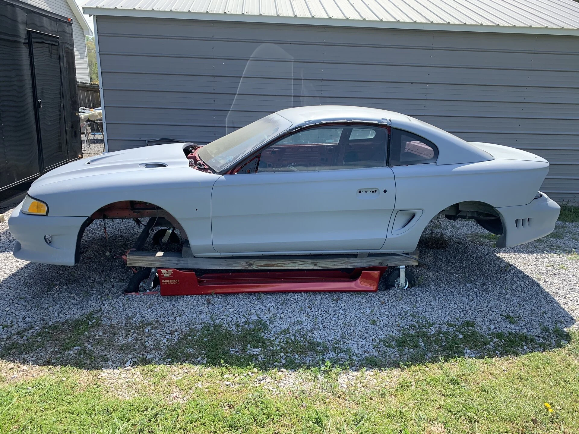

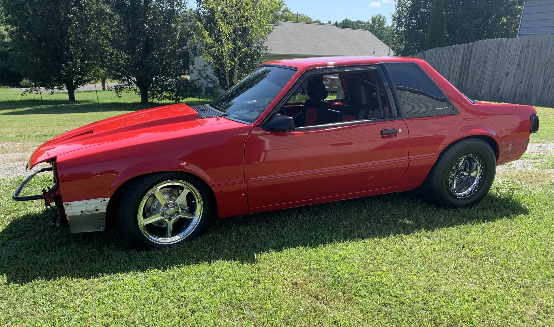

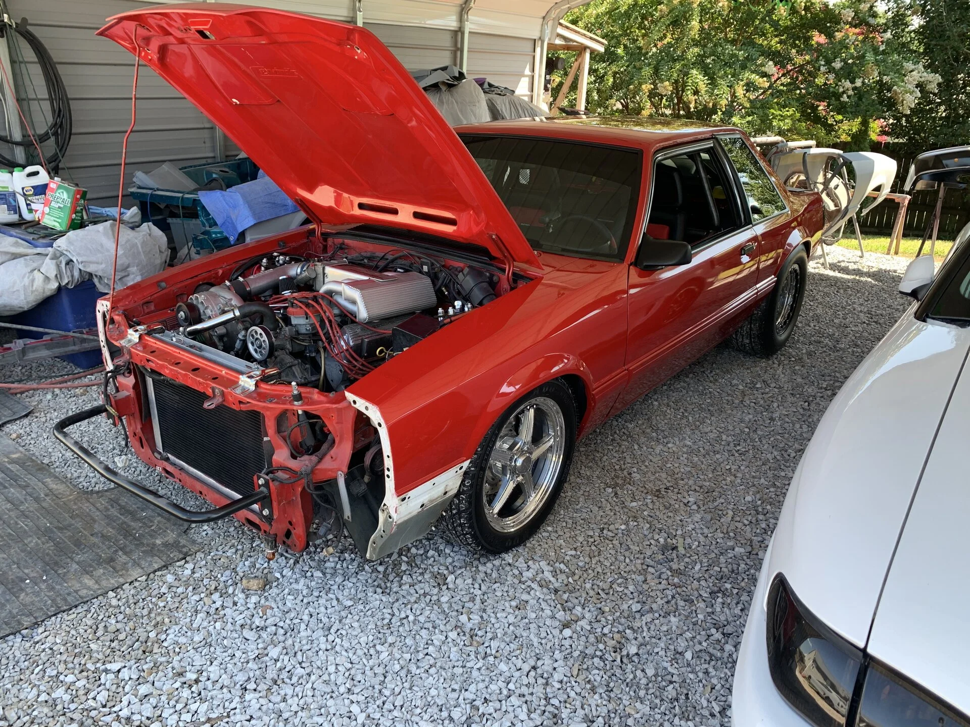

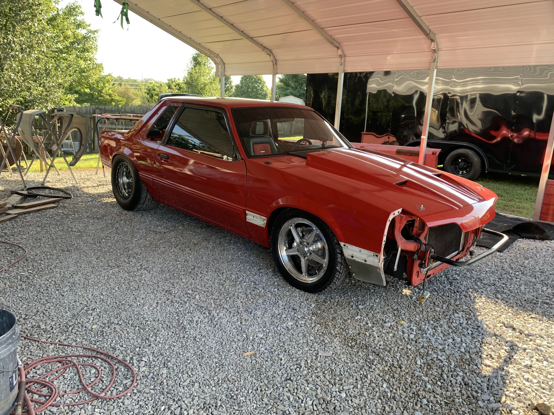

@95steedamustang first off, another great build that I'm going to follow. I'm guessing these photos are older? I only ask because do I spy the Cobra in the background in Primer?
Thanks man! These pics are pretty much current taken in the last 2-3 weeks. What you see is In some background is yet another customer build. 97 Saleen that’s getting a new GT350 drivetrain and the usual shaving and custom paint
