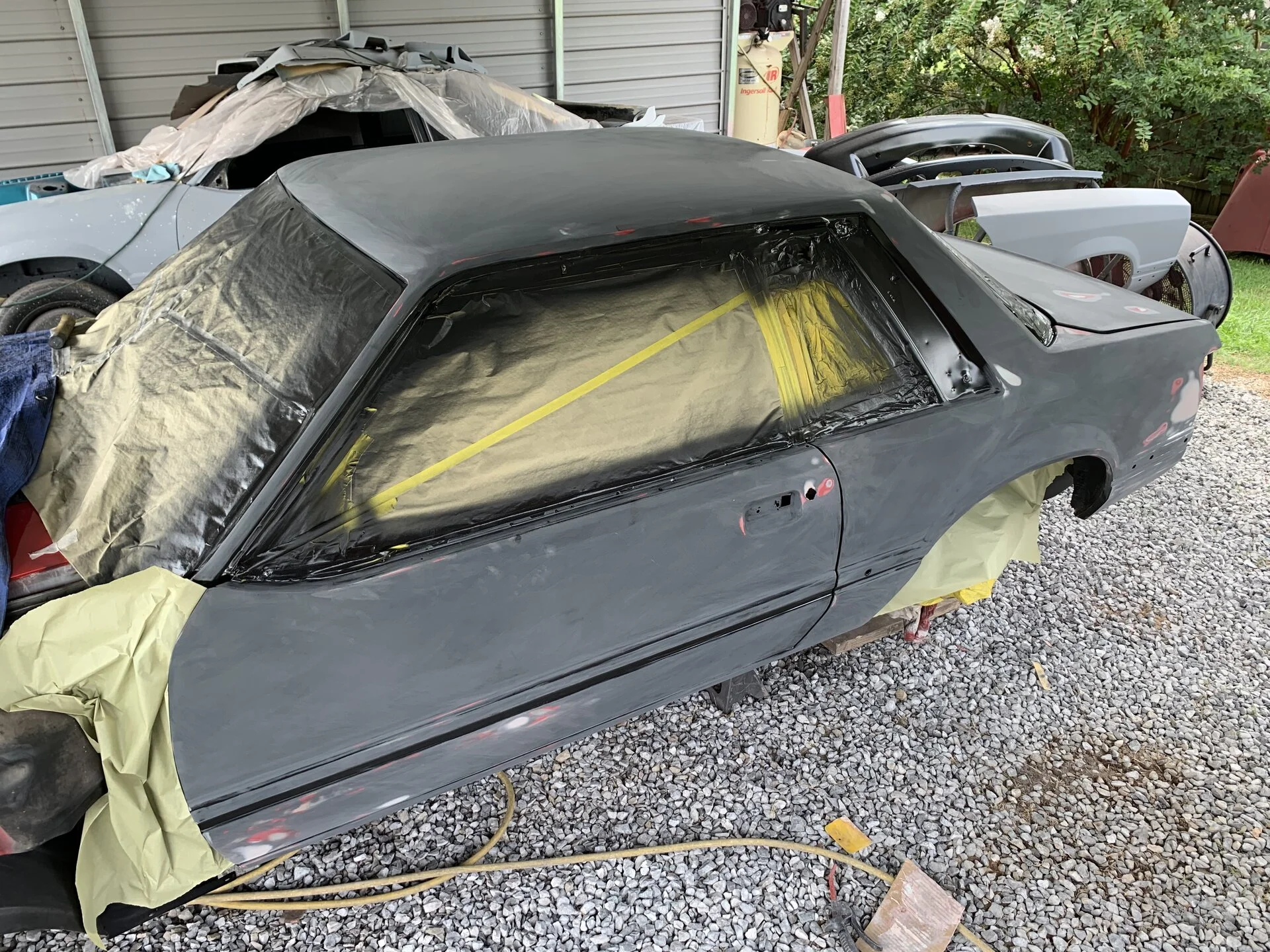

7 days without having to sand it. After 7 days you’ll have to sand and then re coat is good to go. So he just needs to sand it all down. Preferably with a block and shoot primerHow long can the DTM epoxy sit before laying down high build, essentially when would you need to create a mechanical
adhesion buy sanding epoxy ?
I have a buddy whose car has been on a rotisserie sitting in epoxy for about a year now, I know he's be past the re-coat window.

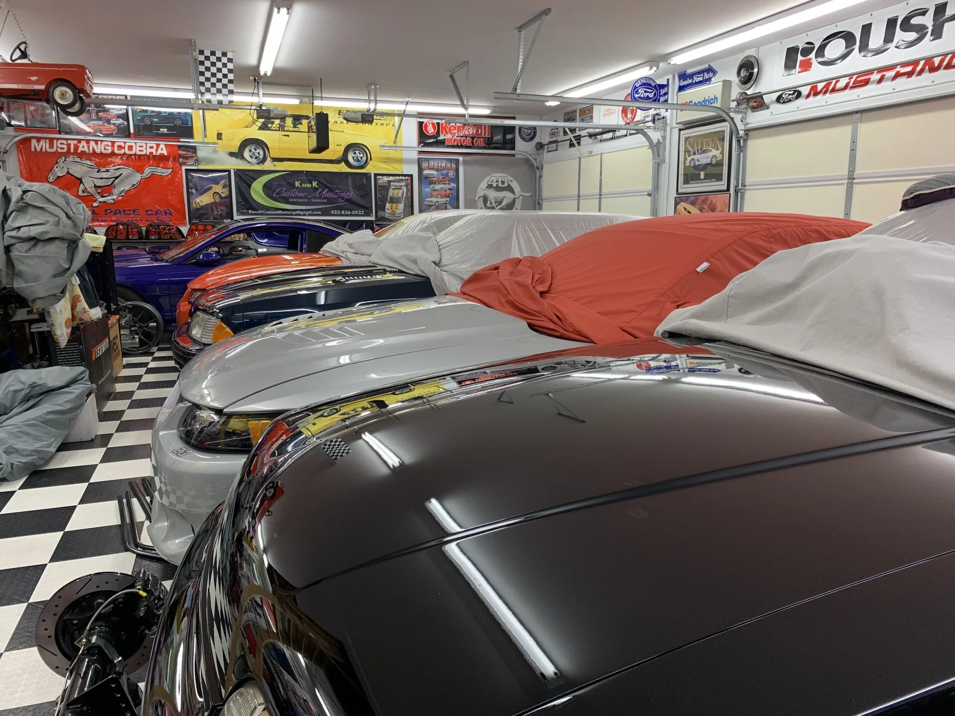

Thanks but I’m only organized because I have way too much junk shoved into every crevice. That’s one for @General karthiefI find your garage very impressive. If only I were that organized.
Read me like a book, I'll have to ponder that, it's has to be better than the existing one.Thanks but I’m only organized because I have way too much junk shoved into every crevice. That’s one for @General karthief
Lmao?Read me like a book, I'll have to ponder that, it's has to be better than the existing one.
If my impending interview pans out, I'll be moving to TN and probably a smaller garage. I'm using your garage as my end goal.Thanks but I’m only organized because I have way too much junk shoved into every crevice. That’s one for @General karthief
don’t use my garage. It’s way out of control now. I can’t even walk between cars. I’m going to end up on a episode of hoardersIf my impending interview pans out, I'll be moving to TN and probably a smaller garage. I'm using your garage as my end goal.
You're right. We should probably swap garages.don’t use my garage. It’s way out of control now. I can’t even walk between cars. I’m going to end up on a episode of hoarders![]()

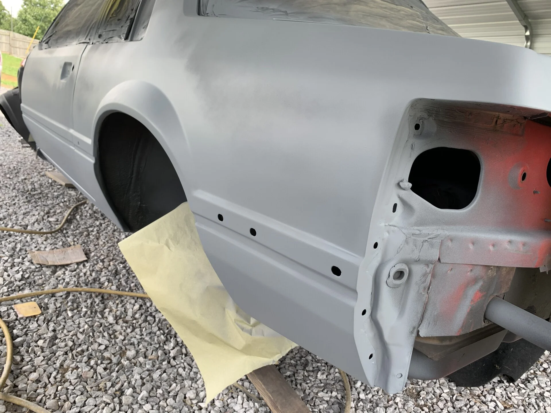

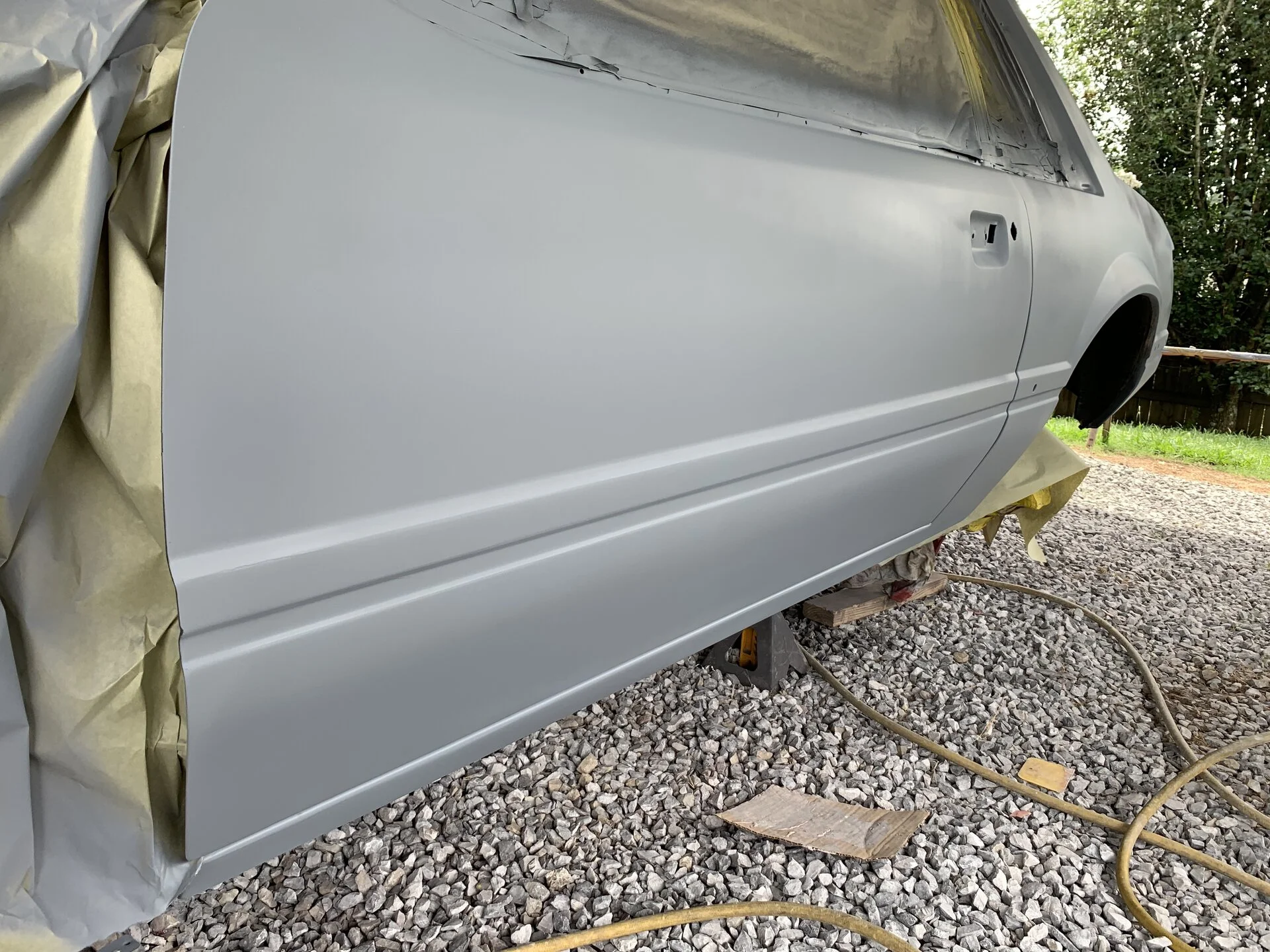

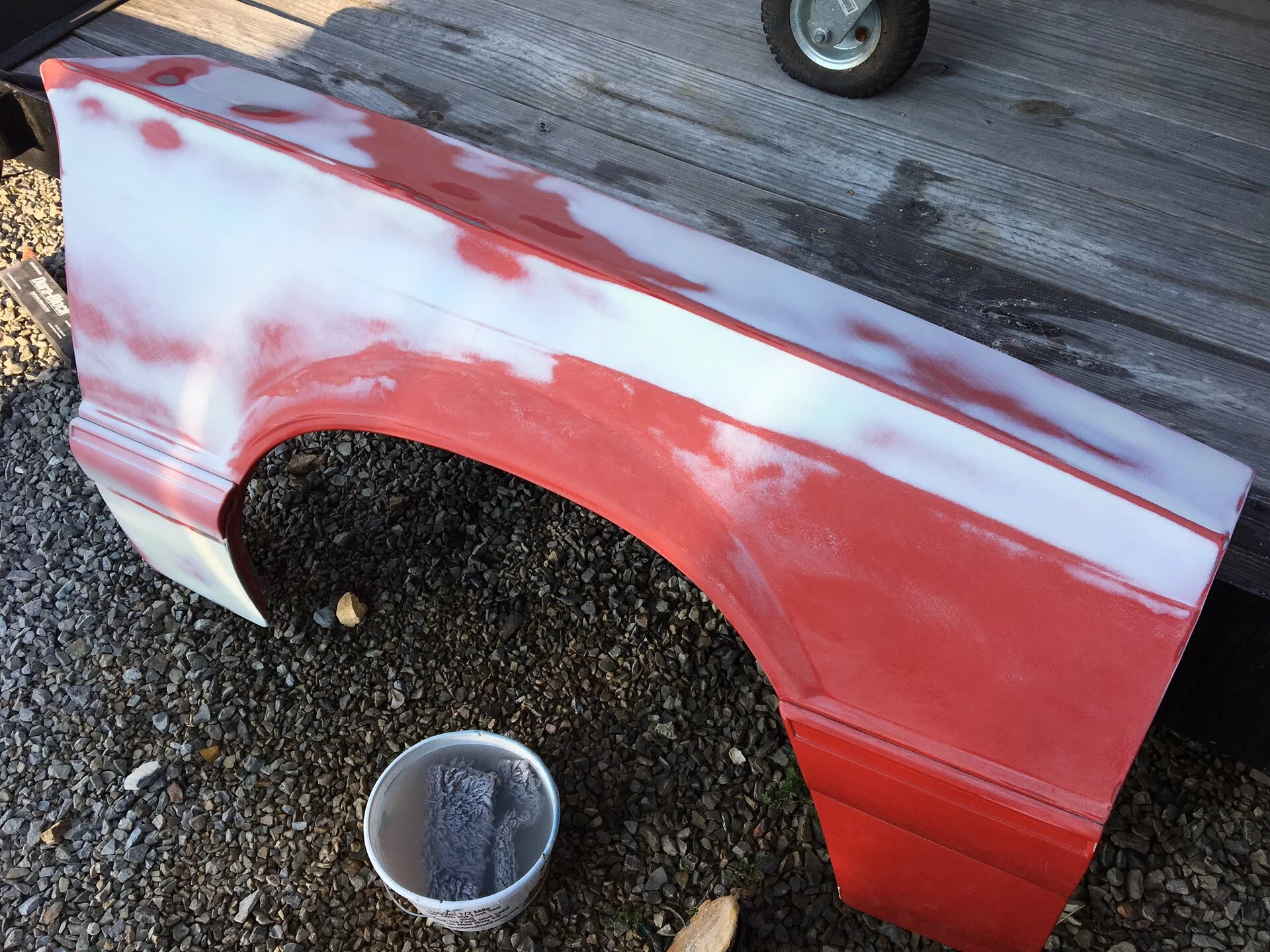

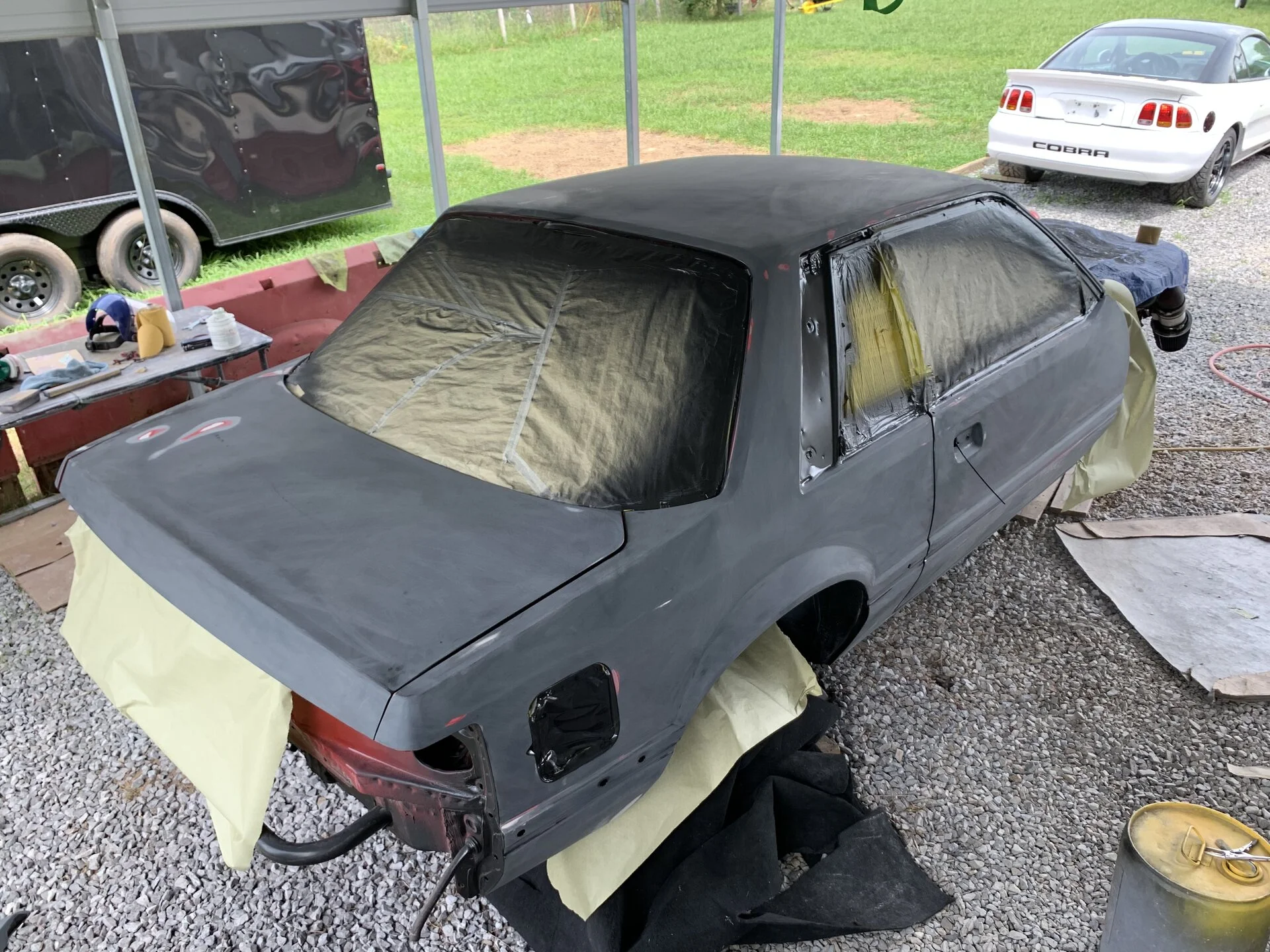

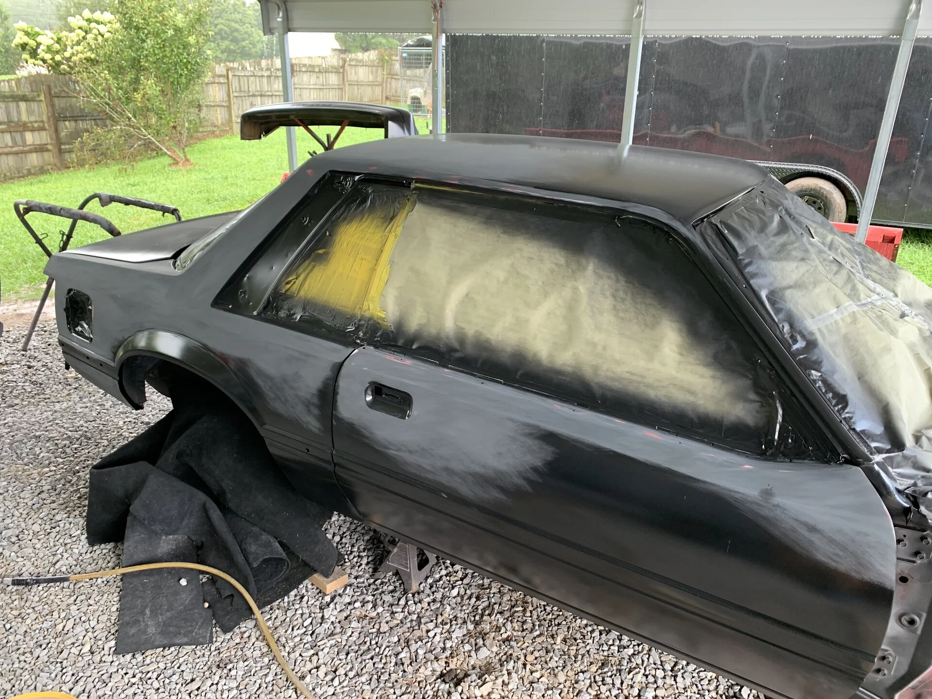

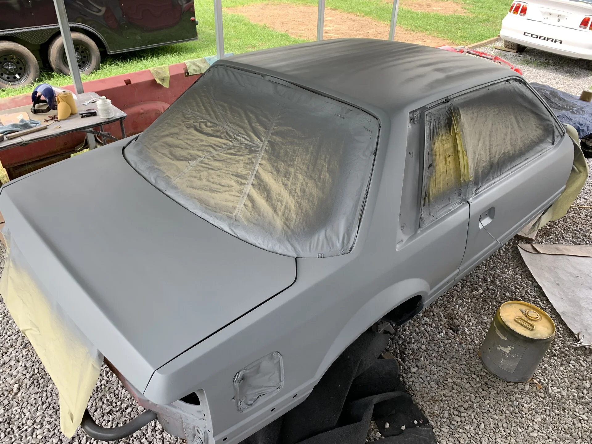

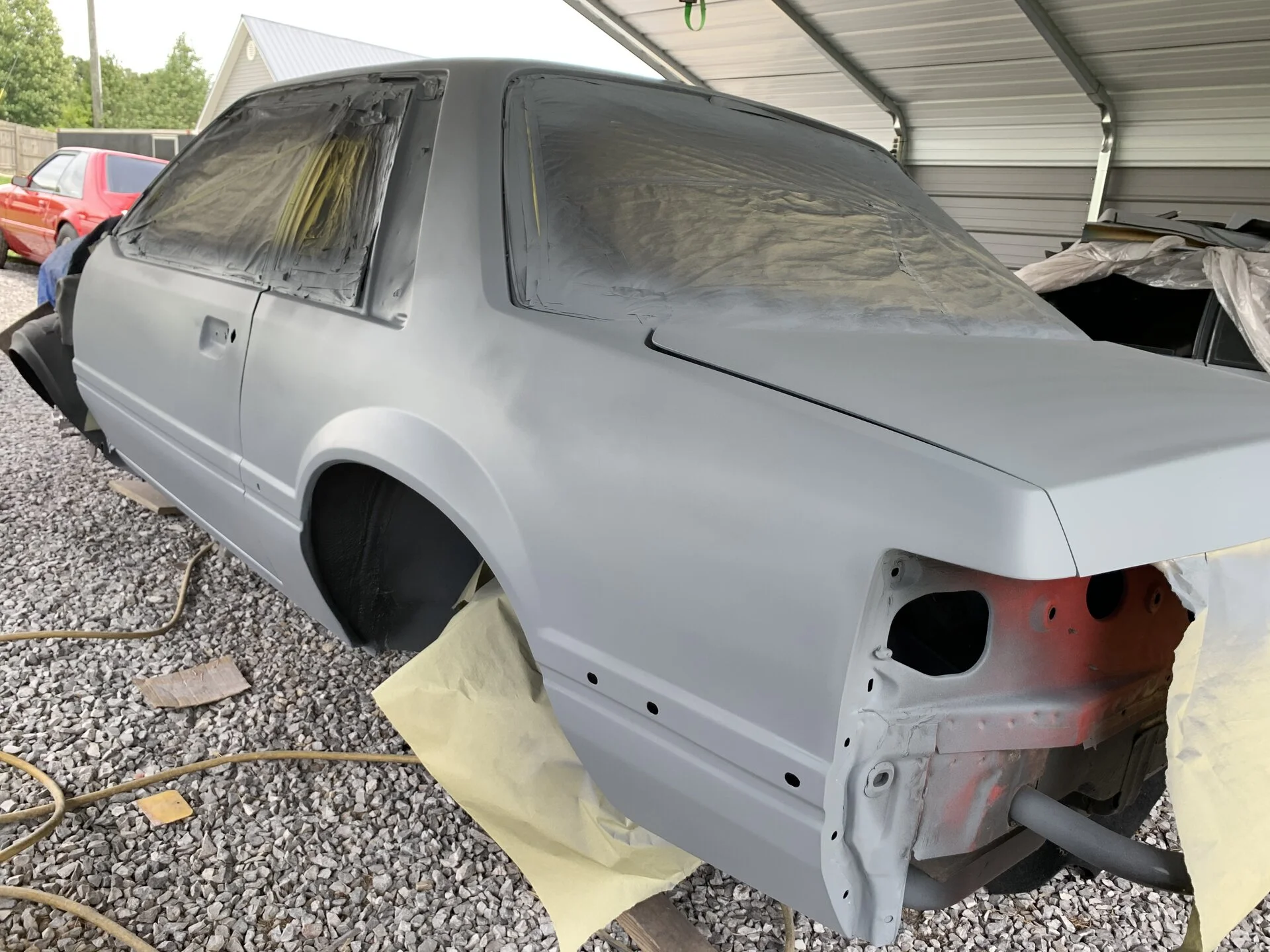

next thing you know you'll spray more primer and sand it again!!Lol! I know man. It’s like a broken record but there are no shortcuts. There’s no big secret and I don’t have any magic powder. Perfect paint is all hard work and patience. Boring but it is what it is.No!!!! Really?? More sanding??
Or more, I forget.

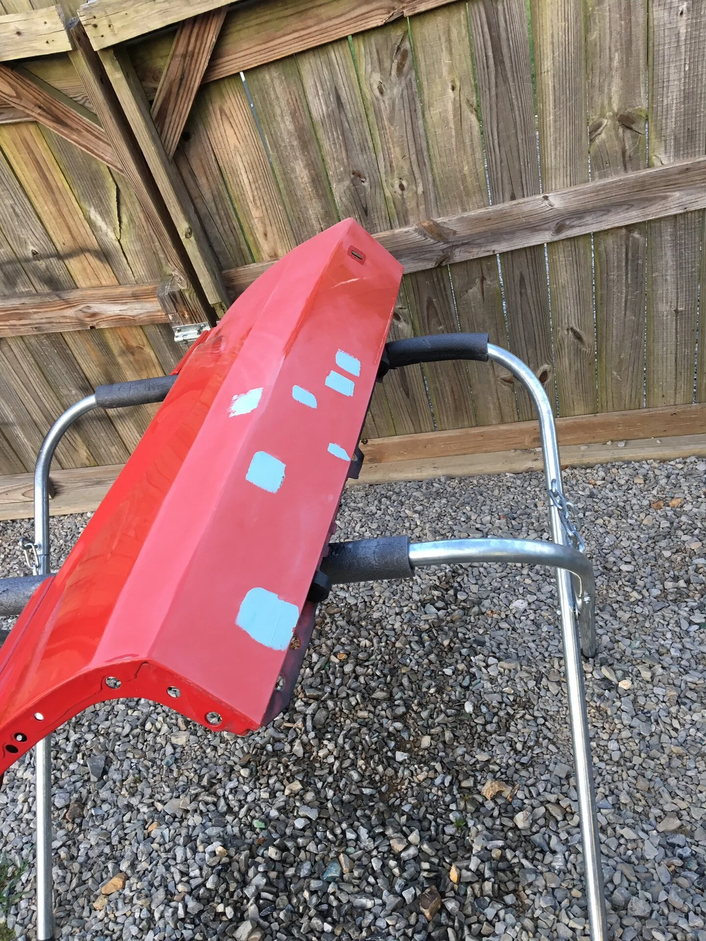

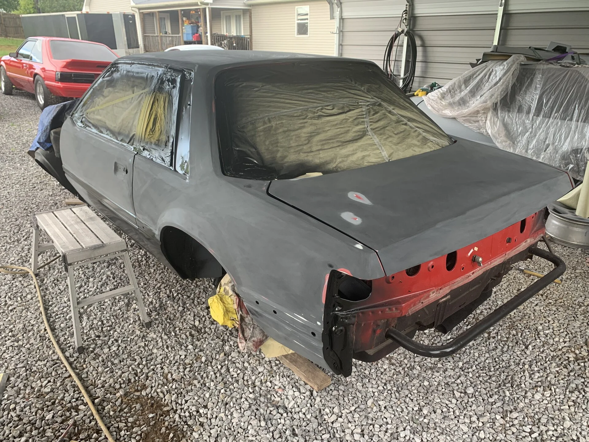

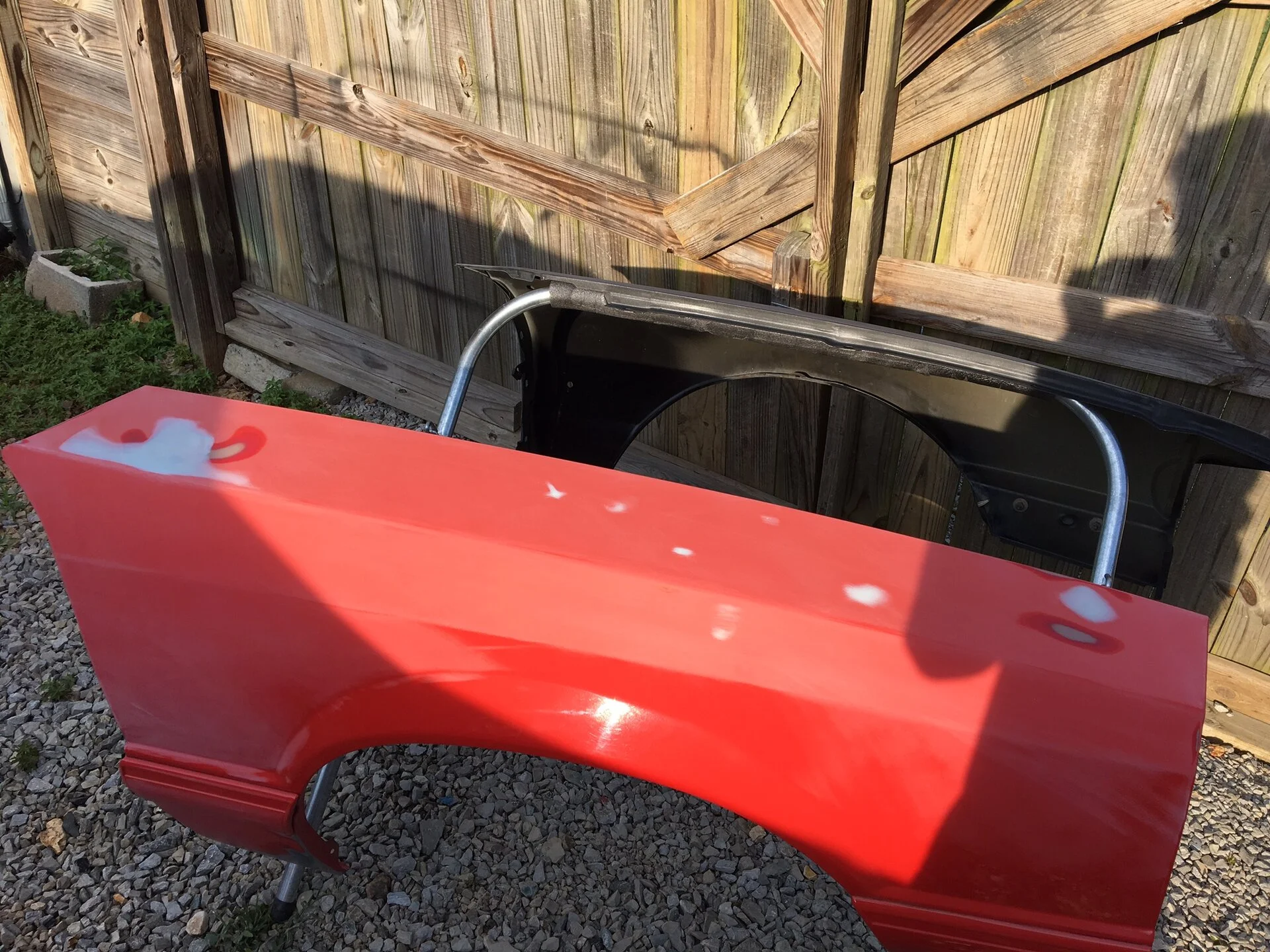

Oh yea. Every car I do gets that shavedFilling in the antenna hole ?
Where do you hide the antenna, and how does it affect the reception?Oh yea. Every car I do gets that shaved
Inner fenders with all the wires. No. Reception is fine but I don’t use the radio. Just Bluetooth it to the phone and go.Where do you hide the antenna, and how does it affect the reception?
