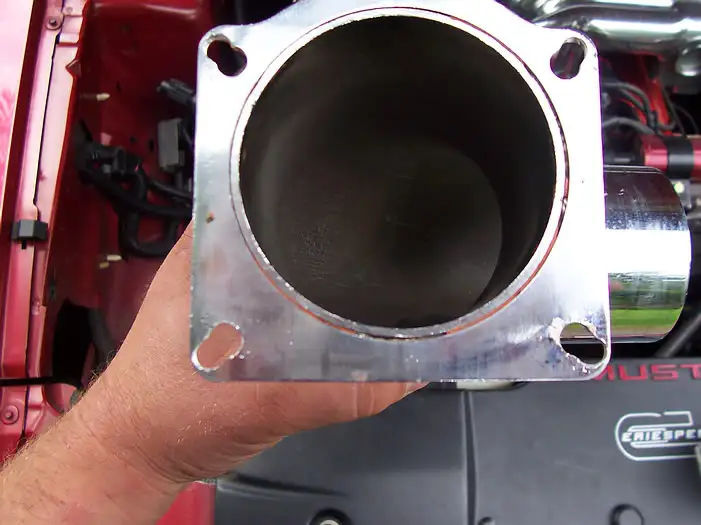

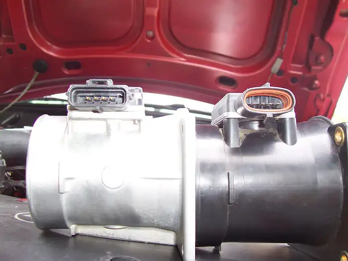

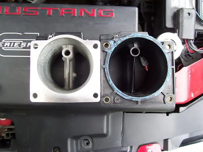

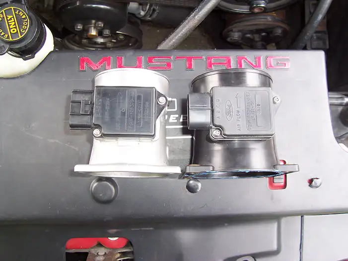

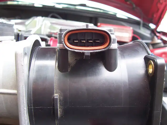

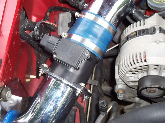

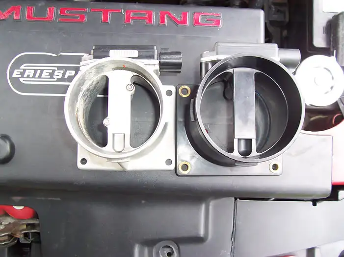

My friend give to me his stock 80mm MASS air meter from 01 Bullitt(he have aftermarked 95mm)

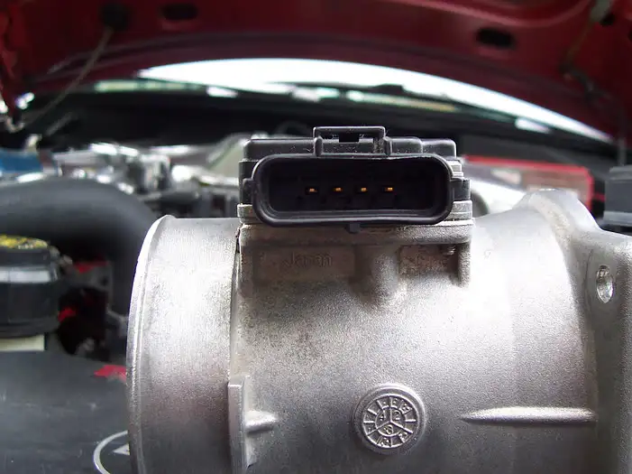

Tube fit with redrilling 4 holes but MASS meter don't because 4.6 have different connector than 5.0 (you can see in pics) but I will try on junk yard get one connector from 4.6

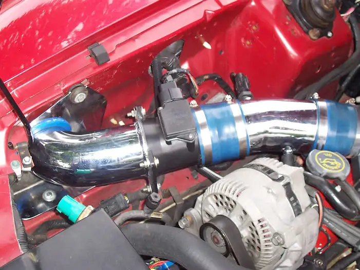

I test drive Stang last night and you know what , I can feel power?torque at low rpms
Here is some pics
BTW meybe I'm first who tryed this :D
