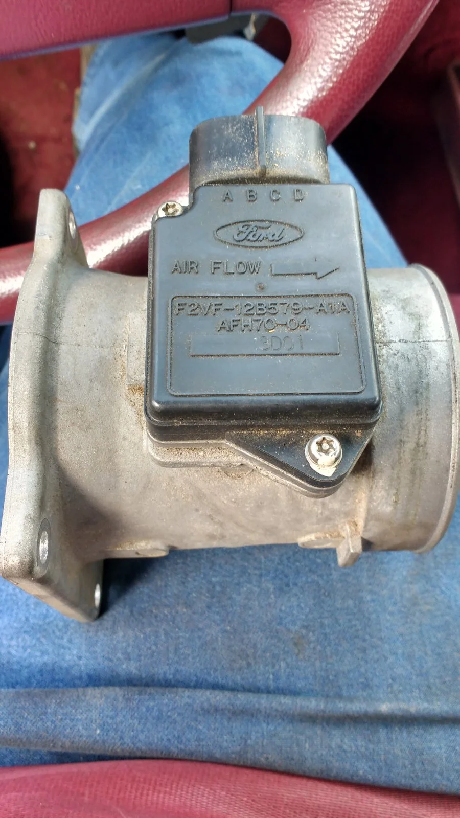

I lucked out this afternoon and came across a 94 crown Vic in my local scrap metal yard. I snagged the whole MAF off of it for less than a $1! It's an original F2VFxxx sensor not reman this time. The crown only showed 70k miles, it was a real shame, the car was clean as a pin.p

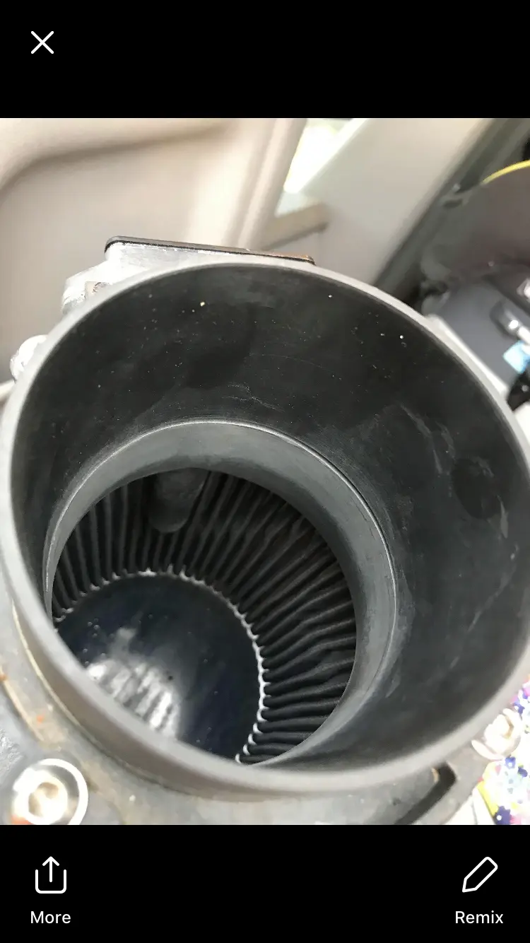

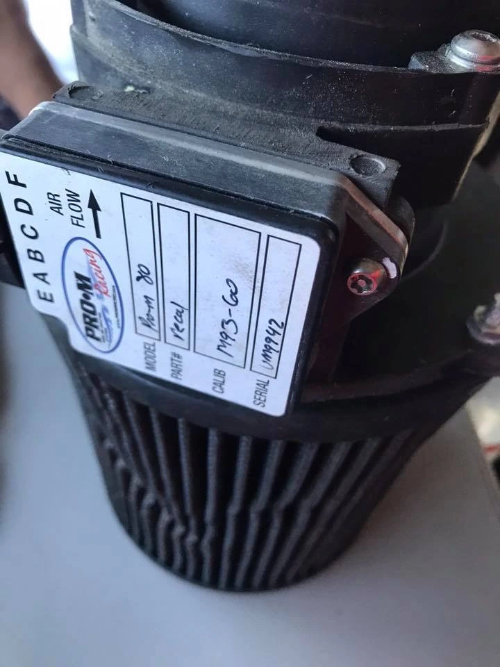

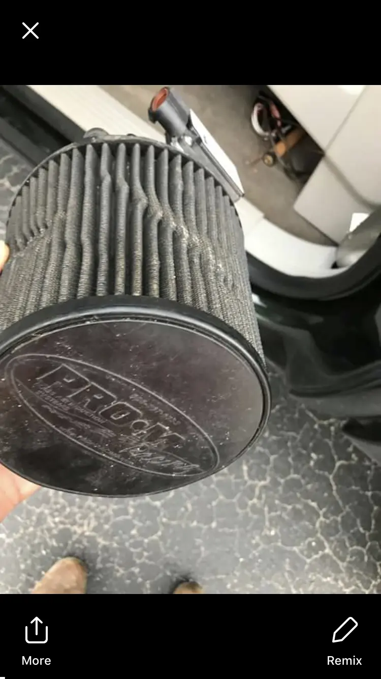

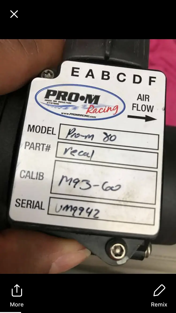

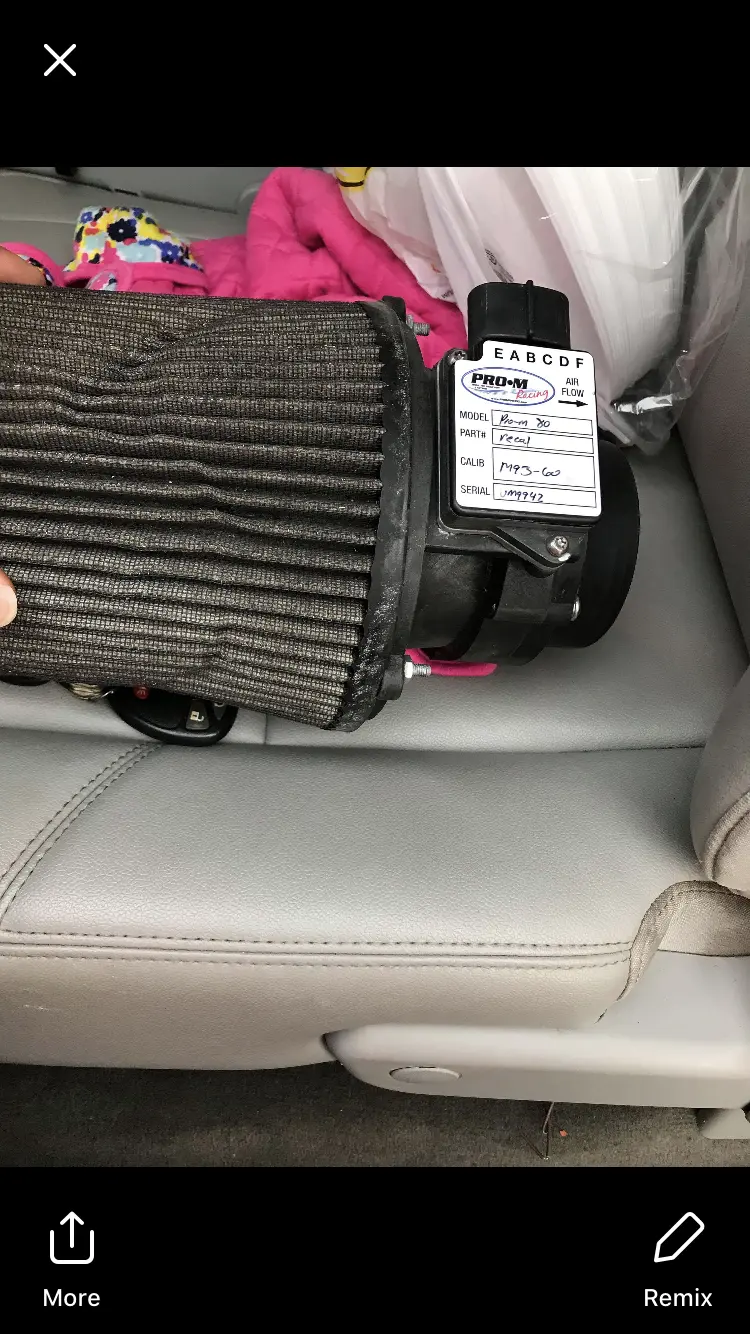

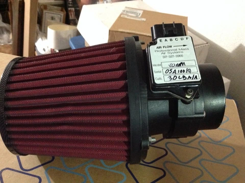

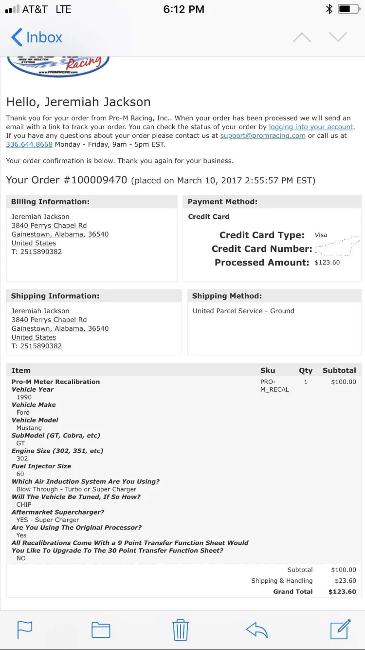

Thought I could chime in here and get some answers from you guys. So I’m planning on running 60lb inj. Saw these two Pro M 80s for sale one is already cal’d for 60lb and the other is cal’d for 30s. I know I could send the unit back and have it recalibrated for 60lb. I don’t know how much that would be though. The guy with the 80 for 60s already wants 125 for it, states he is going carb and has been on the car since last fall and sent me his receipt. It does say recal. on his. What do you all think? This will be going on with a blower once I get to it.
I'd do it, you could call pro m with the serial number to confirm.

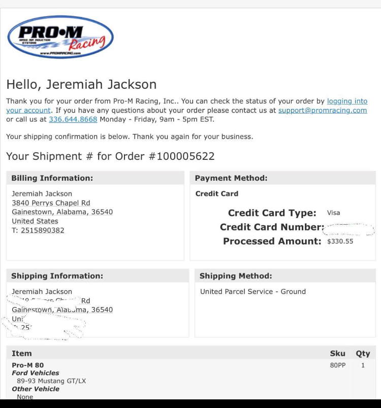

So as for the 1st one which is now calibrated for 60s he did send it back for recal since he orig went with 42lb, states he had one the car for about 200 miles or so, got it tuned, went to strip and did 3 or so passes and his tranny gave out and was leaking. Sent me his proof or recal. And some pics. The deal is pretty good to me at 125. I’d pass on injectors just bc I think I’d get those new even though his seem ok but wants 250. Unless I can bundle. The second one I put up the 80 for 30 looks clean but I would have to send back, he wants 300 for that one and at that point I’m in a loss bc I’m sure recal is about 100 bucks. So you would go for this one at 125?
