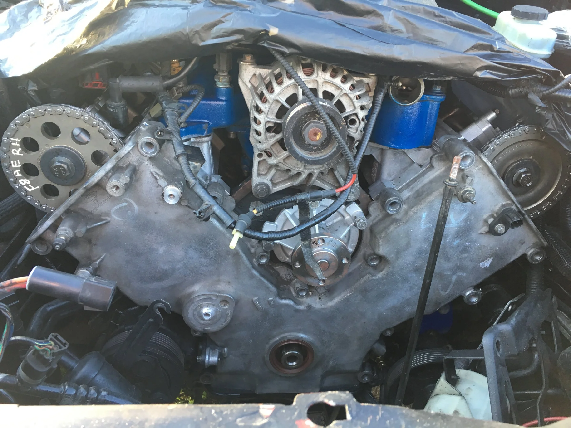

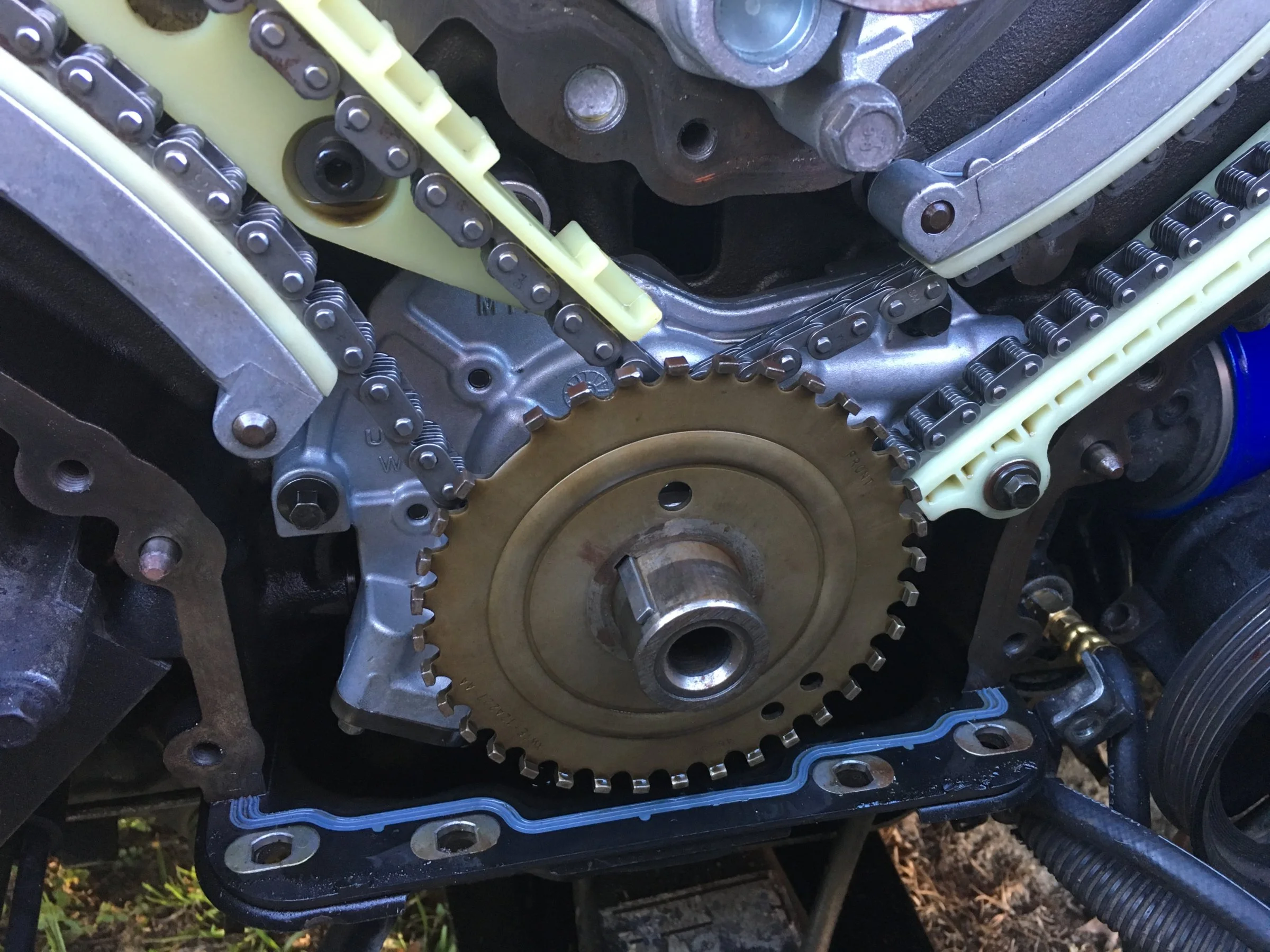

I didn't take any pictures. But I set it tonTDC with the timing sit at 6 o clock. Then I lined up the dots on the gears and the chain on both sides and released the tensioners. So at TDC my dot on my driver side gear is basically at 12 o clock and my passenger gear is at 10 o clock
Some pictures

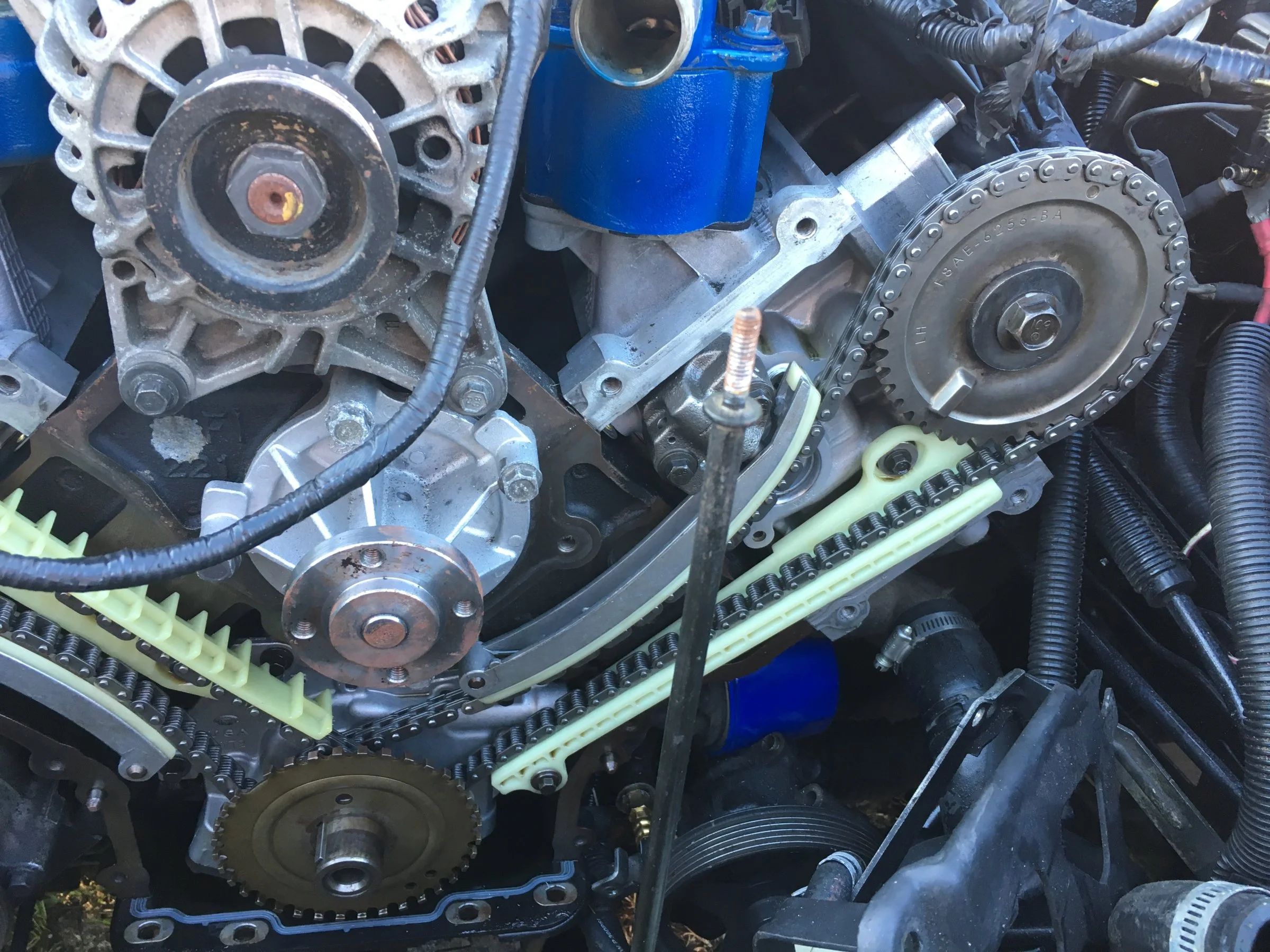

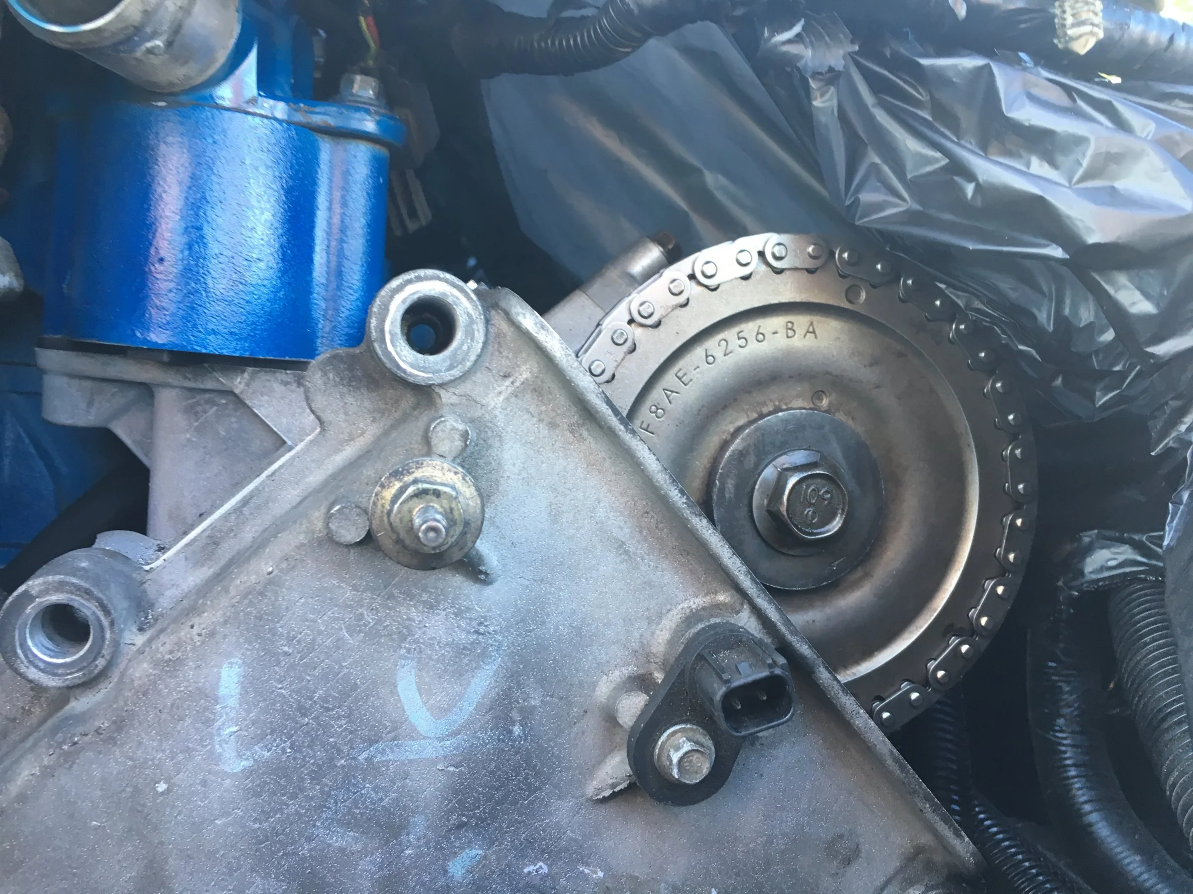

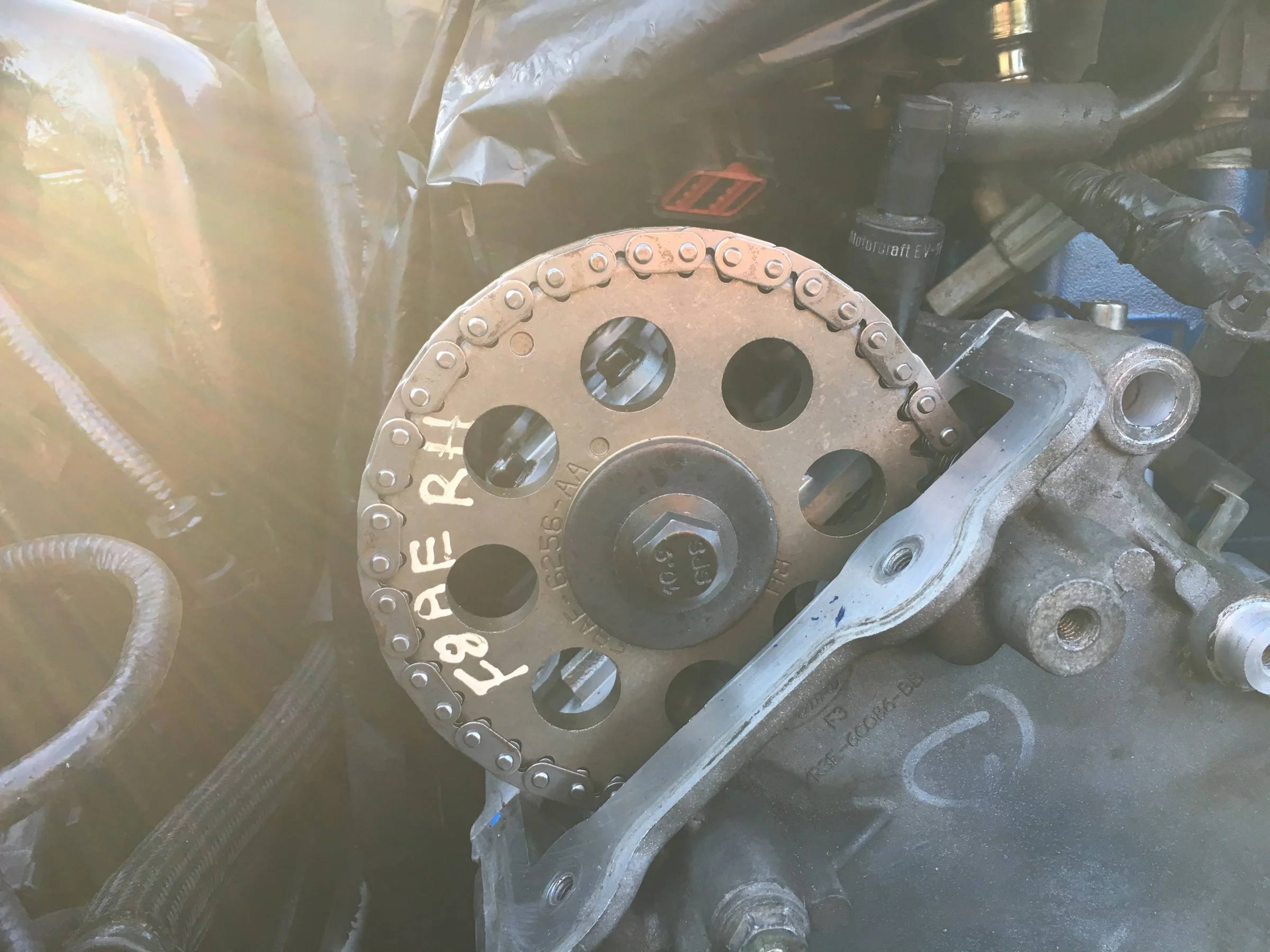

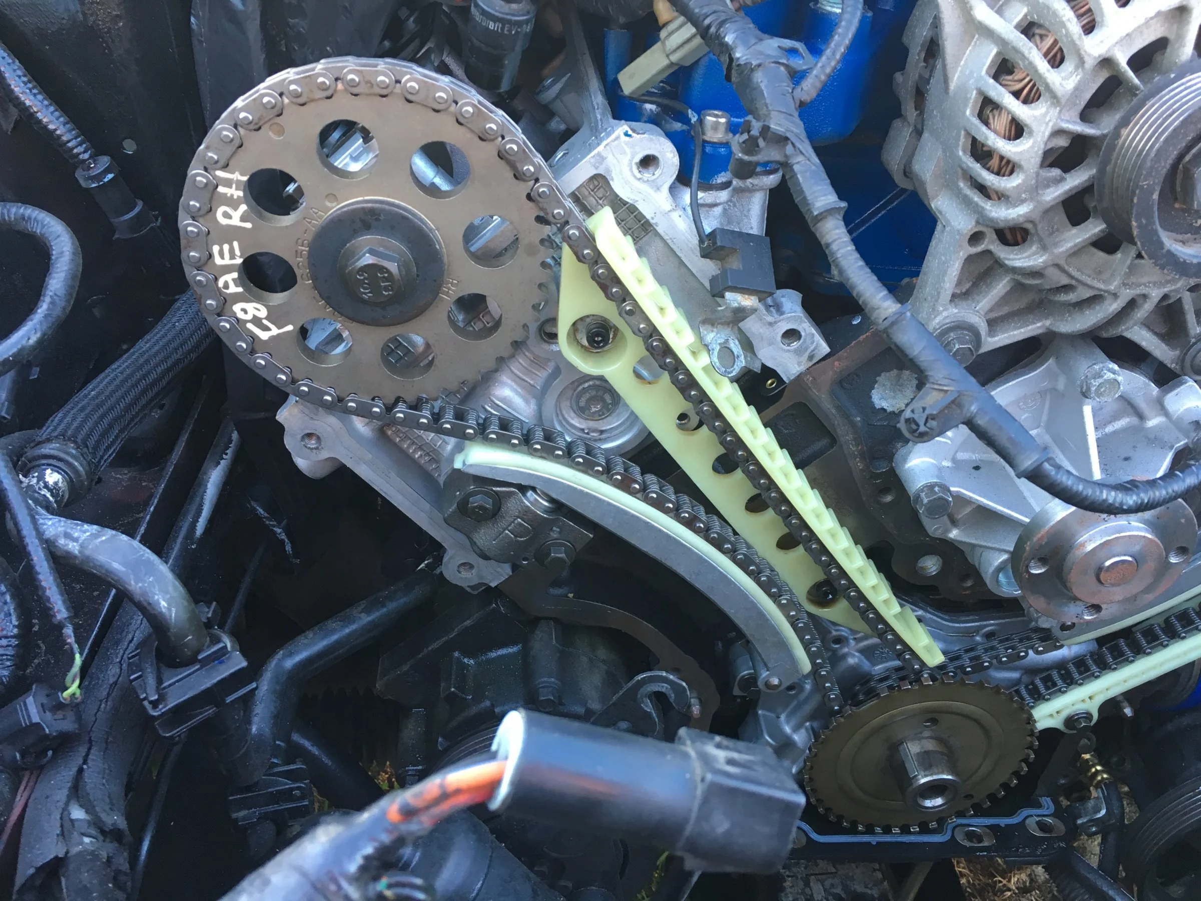

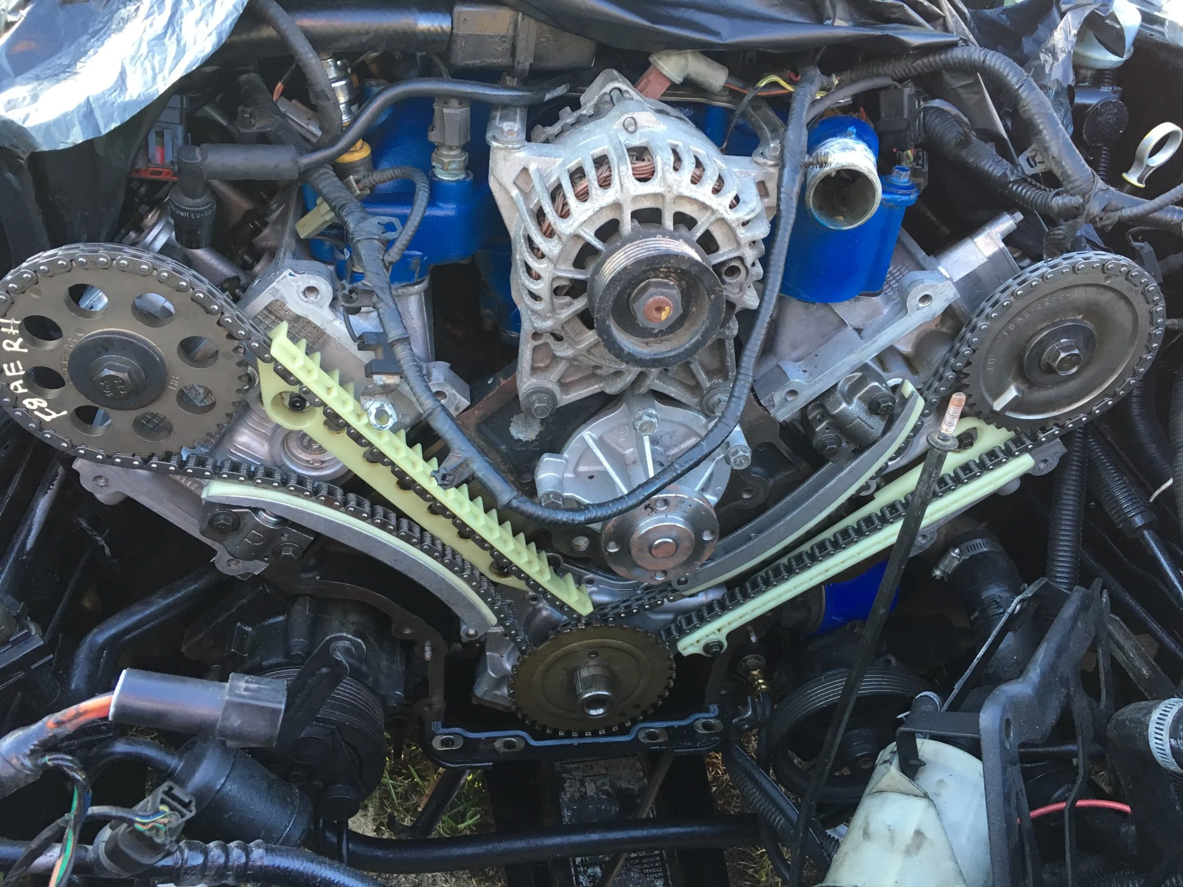

After removing the cover. Does my timing seem right? My tensioners seem perfectly fine

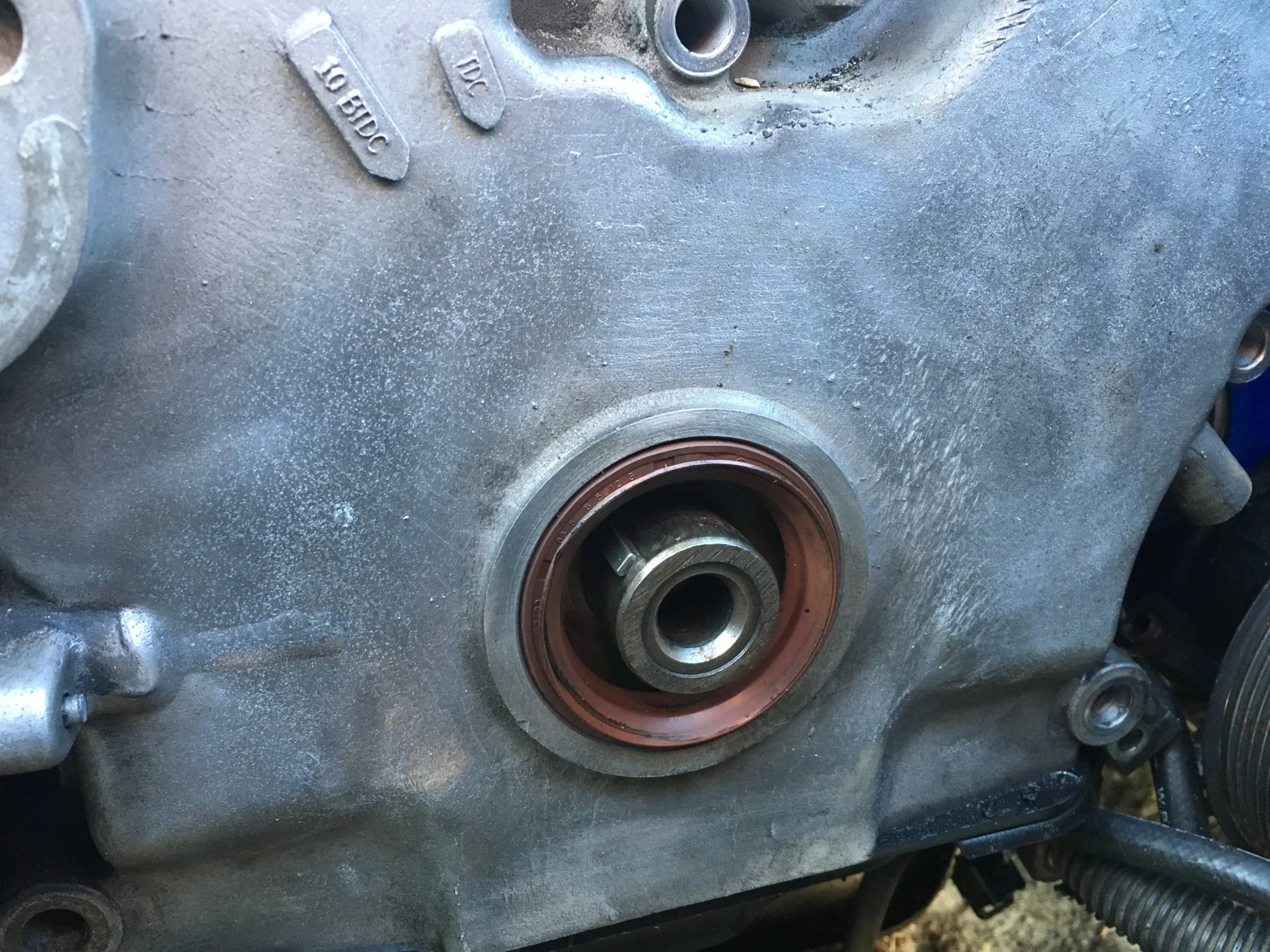

It would have help to have taken the pictures with the crank trigger wheel removed.
I just recently completed a timing set replacement on a 2005 3V 5.4 F-150. During the job when I was installing the the right hand timing chain, the left hand timing chain slipped by one tooth. The problem was found during the double check and corrected.
I can tell you from absolute first hand experience that it was NOT possible to "look" at the cam and tell that the cam was off by one tooth. When looked at from a distance the O'Clock position of the cam appeared the same to me. What I'm trying to say is that the O'Clock position is fine for a gross error check or an initial starting position but it's not good enough for the end product.
The ONLY thing that matters is if the marked chain links match up with the dots.
I don't see a marked link or a different color link on the pictures. Did you fold the chains in half and mark the mid-points or does the set have different color links already on it? If so, it's possible to turn the motor over by hand and sooner or later the marked link will line up with the cam dot. Then it's a simple matter to see which tooth is engaged on the crank.
An option is to count the links in both directions from the cam dot. An engine that is correctly time will have the same number of teeth to the crank 6 O'Clock position.
