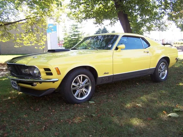

I've wanted to do it since they first came out, so I guess I'll be the guinea pig. Once I get everything to fit I'll post some info on adapter size, tread size, etc. I'll try to get some pics if I can figure out how to put them in my threads. Thanks for all the help guys.
Here they are on a '70 Mach. We used 1" adapters and the stock tires and it looks great!
