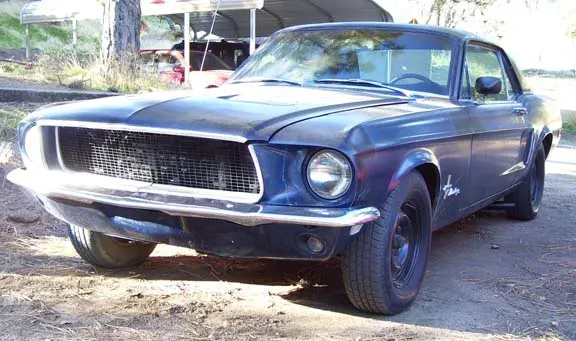

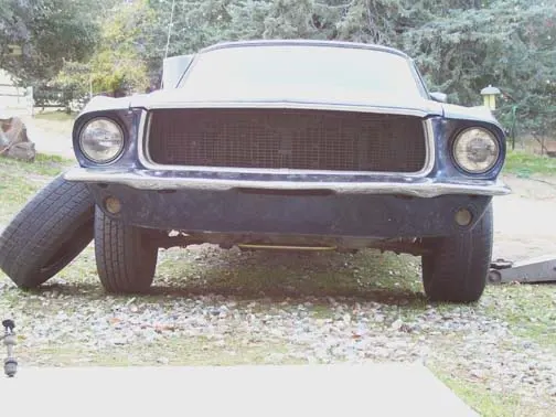

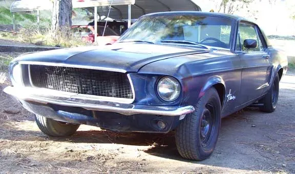

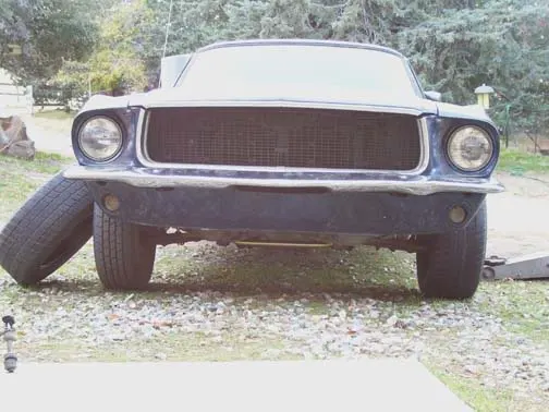

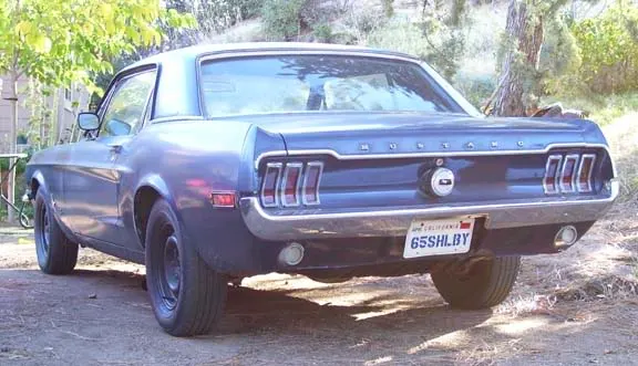

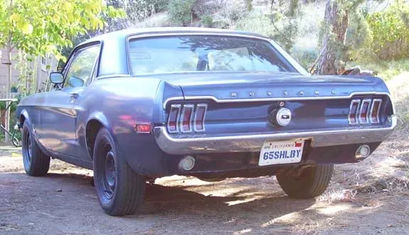

Its been two weeks, but what the hell. Here are some current pics now that its actually legal($417 later :shock:) and sitting level. Those sidepipes are loud and the passenger rear tire has less tread than these pics show :D.

Ummm, that's not a 65 and you have a ways to go before I'd call it a Shelby clone...LOL...just giving you chit!
I like what you did with the license plate though. Get a locker and you can loose tread on both tires evenly too :D
Yeah, that sounds about right. I get no respect! :D
I figured just blanking the plate out would look lame, so I did that. I have a 9" 3.50 T-lok center section waiting for a housing right now. I have to be careful even on dry pavement with the 3.00 open.
