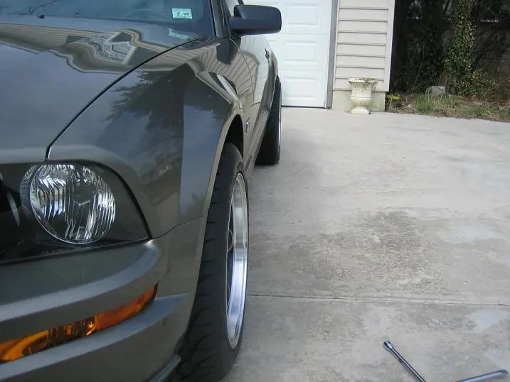

I returned my new rims yesterday because they came in with 25mm offset and that hits the calipers....I'm probably going to get another set of the same..But they will be custom made for me ..so I'm probably going to get just what I wanted made (staggered set 18x8 18x10) instead of staying with the 17x8 which I sent back.
Pic of the set I returned

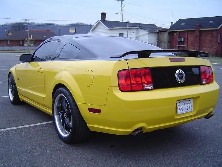

I have 18x10 in the rear with a 22mm offset and they dont come anywhere close to the calipers. The rims do stick out a little bit but I think it looks bad a$$.
more

Heres a pic of the rim hitting the caliper at +25offset.
It's good to know that 10" will fit...But since the next set will be custom made..I want to get this offset right.
His +25mm wheels are 18x9, so that spot where yours was hitting is an inch further away. You'd probably want about +45mm in a 10" out back. Up front, +35mm would probably look the best.
Thats a good thought..I Hadn't considered the rim being taller might make it clear...also the shape of the back of the rim ..maybe would also account for it...Thanks :nice:
Im not sure why your wheels hit, mine are 18x10 and they clear by about an inch. It might be because they are deep dish, but its the same on the fronts and they are 18x9's.
