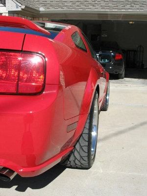

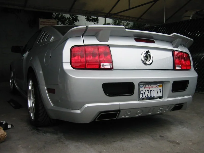

Same setup as Chad's. 295 in the rear on a 19x10. 275 in front on a 19x9.

I have a set of those exact rims on my car with 255/45/18's right now. Widest you can go is 275 or maybe 285, depending on the tire. 295 is too wide, that's why I'm switching to 19x10 rears, 19x9 fronts to run the same setup as turbochad and srichard.

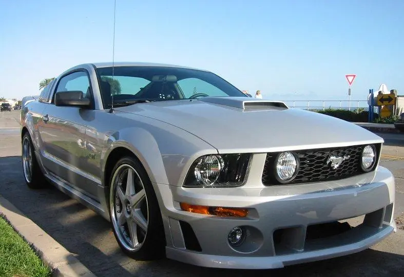

And I have the same setup as srichard
**Note - the front tire looks off because this pic was taken pre-alignment after being lowerd, but I wanted a pic of the new wheels :D

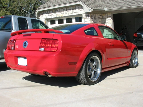

Here's a "pre-lowered" shot of my car.
delurker said:
What profile and which tire? I can't find a 295 in any aspect ratio that doesn't require at least a 9.5" rim, most of them 10".
Thanks for the picture, it's very helpful. The rear wheels look like they stick out a bit. Was it really like that, or is it just the picture angle?
gp001, can you give me some info on your setup? Brand, rims sizes, tire sizes, price (if you don't mind)? Your setup looks killer. I wasn't looking to spend the $$ for 19s right now, but after seeing your car I may have to :).

Ok thanks. What do you think about machining off about 1/4" off the back of the hub pad? Think that would give a better fit?
A little bit - it's more like 3/4" off where I'd like it to be, though. Actually, with the car lowered an inch or so, it just looks like wide tires.
Front: 19x9 ROH Drift R, +35mm offset, 275/35-19 BFG g-Force KDW 2
Rear: 19x10 ROH Drift R, +45mm offset, 295/35-19 BFG g-Force KDW 2
