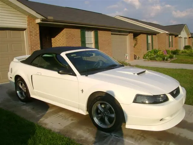

This is my first post on stangnet I hope some one can help.
I just got a 99 GT auto , i'm new at this Mustang thing, I just would like to know how much it would take to get in the 12's with out putting on a turbo or supercharger. I know it will take a lot but I just want to get started in the right direction. Thanks :shrug:
bbk cold air intake
410 gears
bassani x pipe
