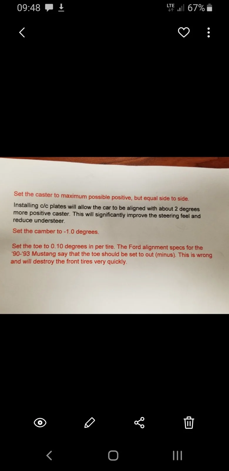

I'll be getting my car tuned at Powertrain Dynamics in Huntington Beach (Surf City USA) this coming Tuesday (20 Aug). I've already swapped out my plugs to Autolite AR3924 per the tuner's suggestion. The old plugs were Motorsports, but he suggested the Autolites due to my alumimum heads. Later that day I'll be getting another aligment. Hopefully this third one will be THE one. Maximum Motorsports suggested alignment specs below:

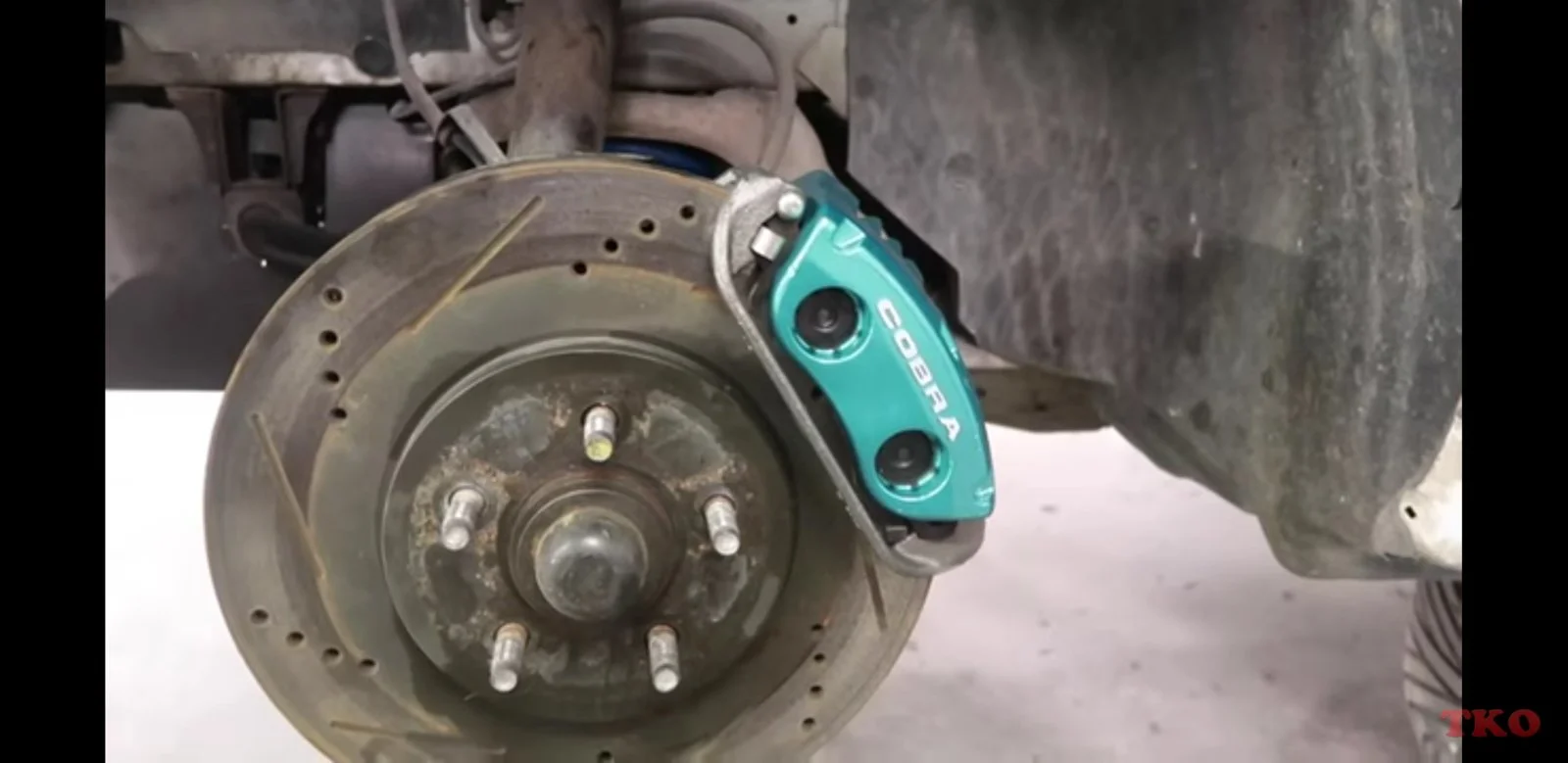

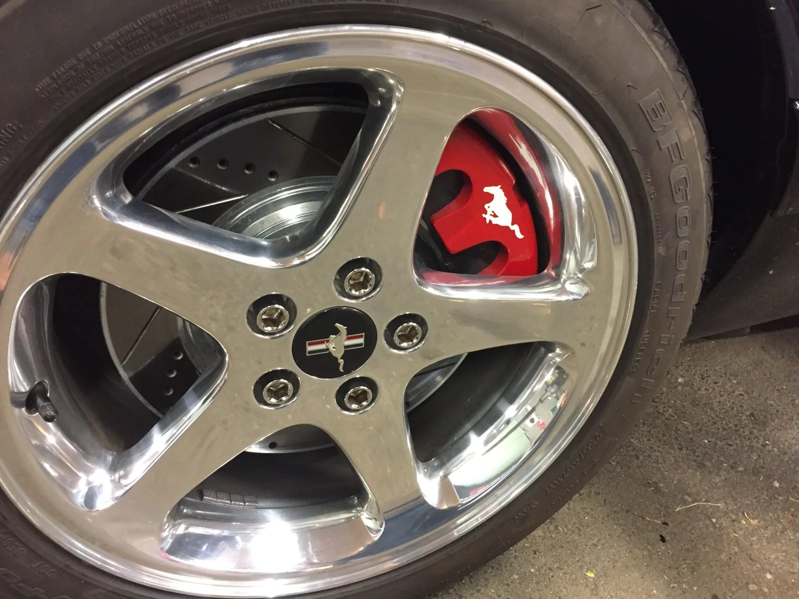

One thing I noticed post brake upgrade is that the new calipers and pad don't cover the entire 13" rotor -see attached screen shot. While this photo is not of my car, it is the same concept and you'll see the inner diameter (approximately 40%) of the rotor is unused in braking. Why did Ford go this way when designing this rotor and caliper assembly?

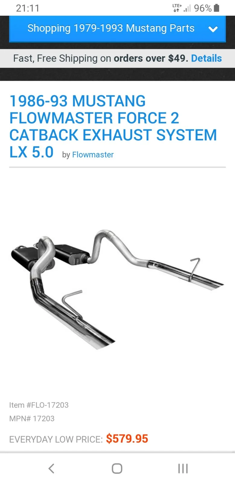

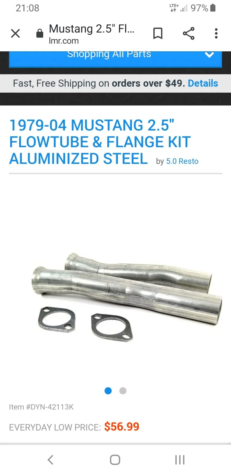

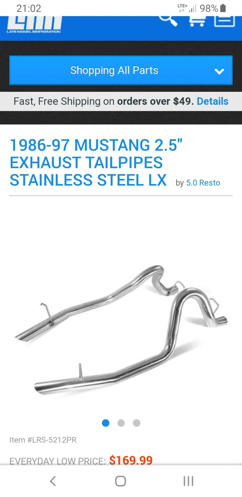

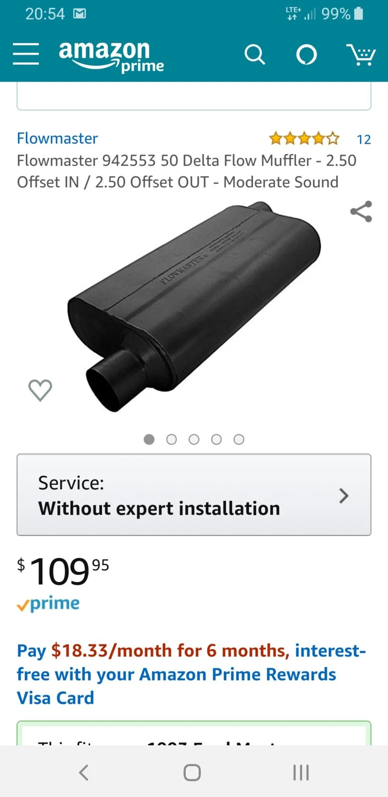

For anyone who is considering plunking down the $579 for a Flowmaster 3 Chamber, or what is now called "Force 2", cat back exhaust but doesn't like the word Flowmaster lazer etched on the tail pipes here is a cheaper solution. Purchase your own separate flow tubes and stainless steel tail pipes from LMR and then visit Amazon for the 3 chamber mufflers. These are the same 3 chamber mufflers you would otherwise receive in the kit and are also the updated "Delta Flow" which results in less highway drone. Total savings over buying the kit whole? Approximately $120.

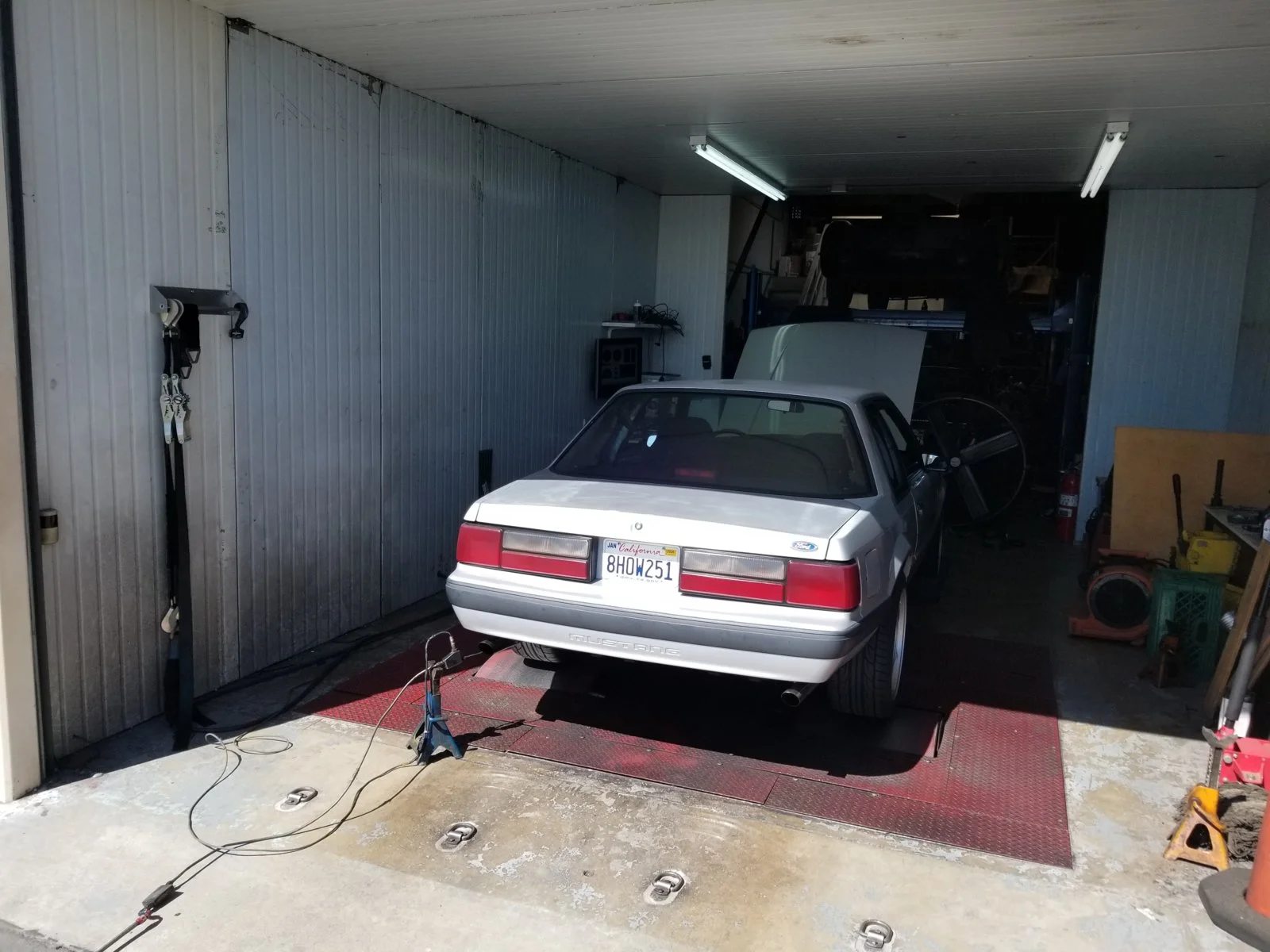

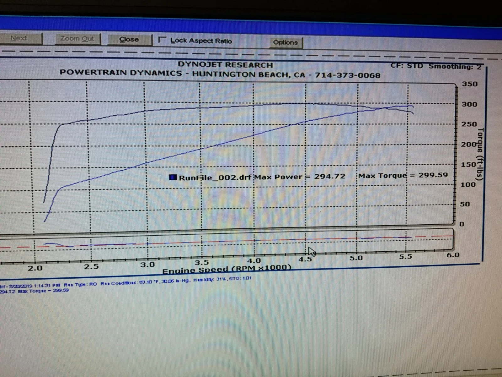

Car was tuned and dyno'd today. Boy did it need a tune! Car made 295/300 and runs/idles VERY well now.
Steve at Powertrain Dynamics in Huntington Beach did a phenomenal job. I was scheduled for 1 hour with him, but he ended up spending nearly 3 hours on the car. Despite dealing with a BBK Mass Air Flow meter that basically dumps fuel at low RPM and goes lean at high RPM he "burned" multiple tunes until he got 12.8 AF across the board. He set the adjustable fuel regulator at 42.5 psi. He also discovered the car was set at zero timing. I'm not sure how that is even possible, but he raised it to 10 degrees. He advised me to lower the rear tires to 30 pounds as the tires crown under acceleration and you loose traction on the street. I'll probably purchase one of the clear air filter covers to reduce turbulence on the face of the filter. Overall, I'm very happy with the results.
Ford didn’t design it. PBR did. The only input Ford had was the spacing on the bolts to connect to the spindle.
This Caliper design was originally used with a 12” rotor in the 80s. That’s why surface coverage isn’t that great.
PBR updated the design in 1995 with the C5 style Caliper. It’s stiffer, wider to accommodate wider rotors, and had larger pad area to work with 13” rotors.
I run C6 style brakes with Baer brackets and you can see how the pad contact area is greater. It helps regulate rotor temp due to more contact area of the pad
