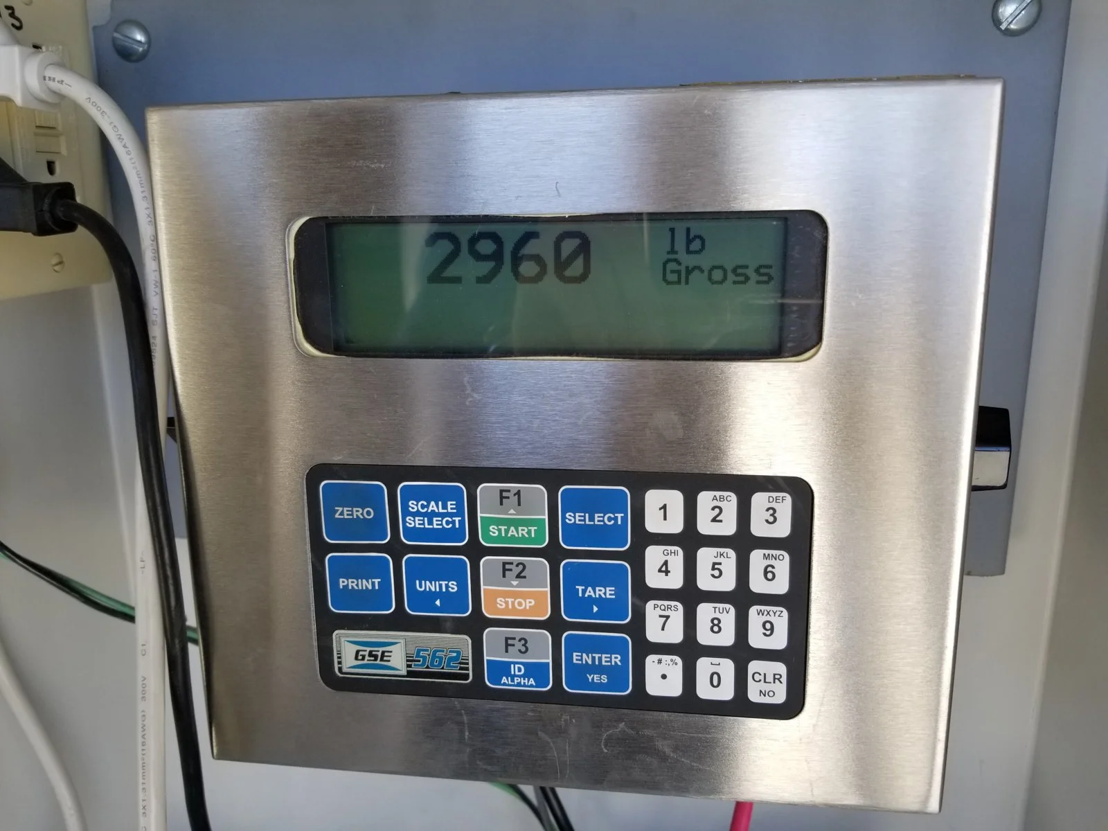

Weighed my vehicle today on a legit cargo weighing scale. 2,960 pounds without me in it. That seems to be right about 3,200 wet. Pretty impressive little car.

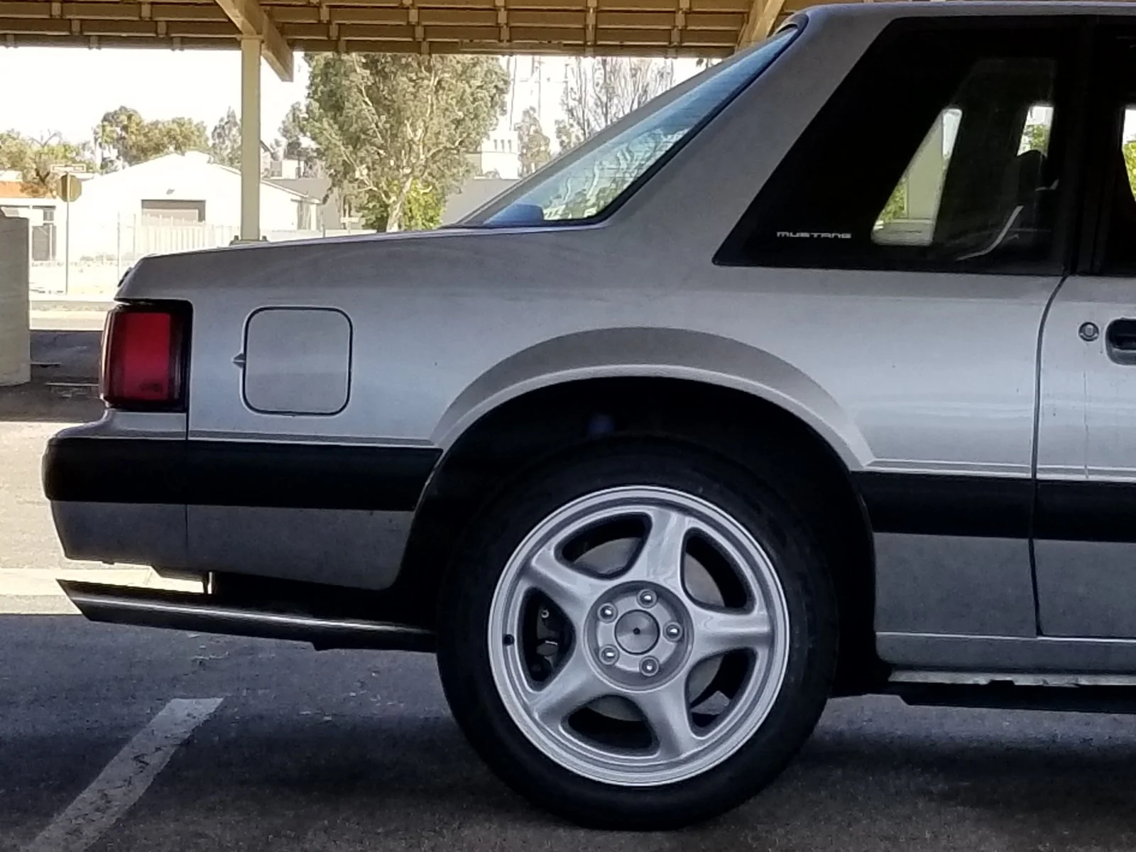

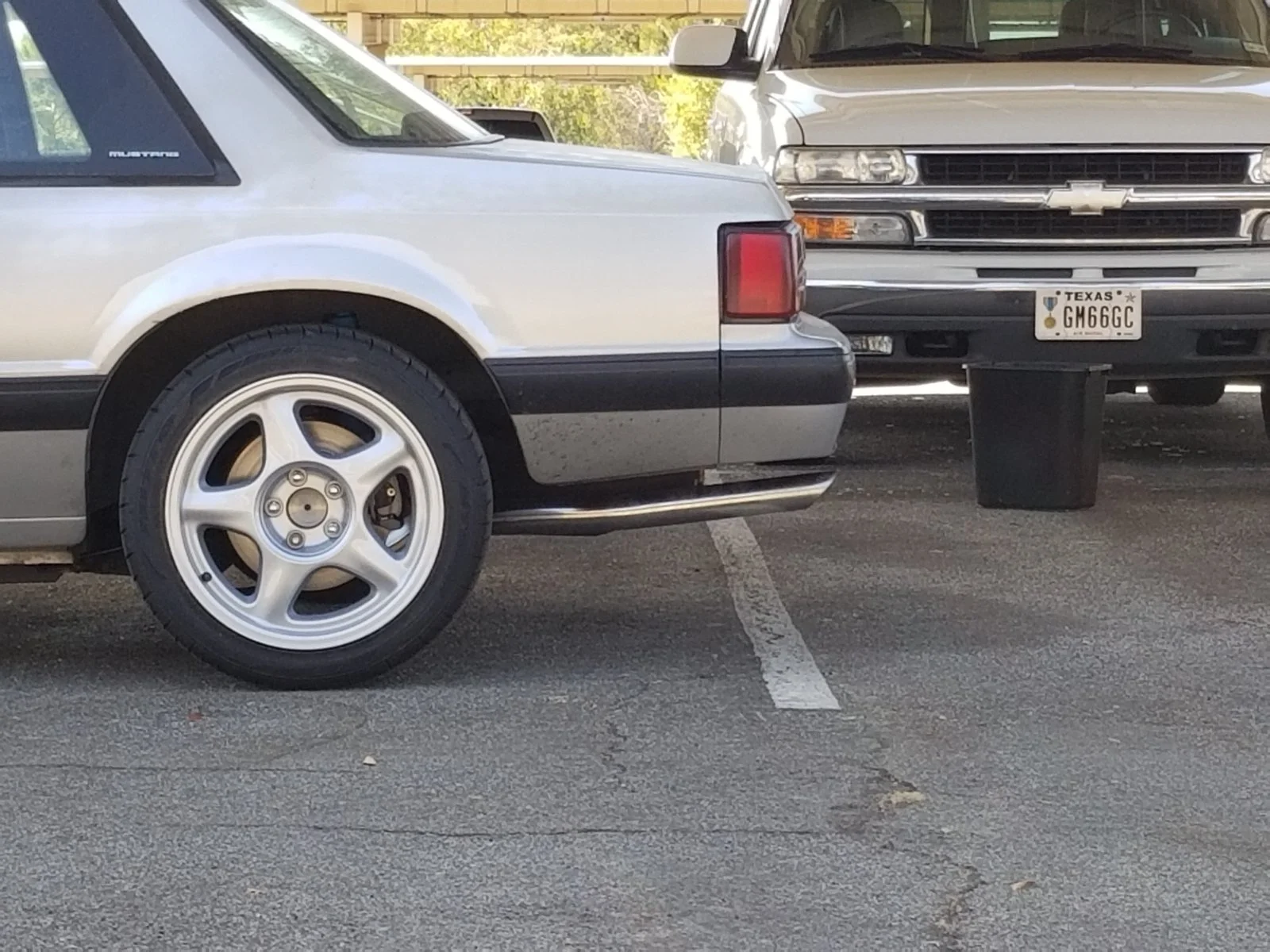

On another note, I'm thinking about bringing the car to a collision center to straighten the frame. The car is visibly higher in the right rear (see attached photo) and lower in the front left. Anyone have any experience with frame straightening?

ALL of the suspension is brand new. Bilstein shocks and strut and FMS B springs. The pax rear is 3/4" higher than the driver side rear. The driver side front is 5/8" lower than the pax side front. I know the car was a quarter mile car for some time. I removed and measured the rear anti roll bar and it is taller at its connection point by 1/4"+ on the pax side.
