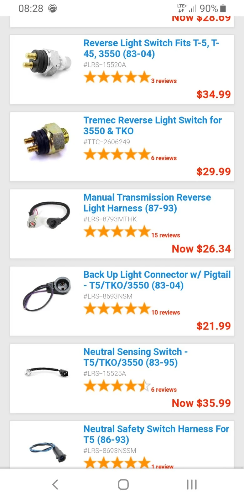

One of the many bugs in the car I'm trying to chase down is the rear backup lights don't illuminate when the trans is put into reverse. The trans shop tested the reverse light switch located on the trans and that came out good. Are the reverse harnesses known to go bad? I plan to ask the trans shop to test that, but other than the switch and harness I can only assume the wiring at the bulbs were reinstalled incorrectly.

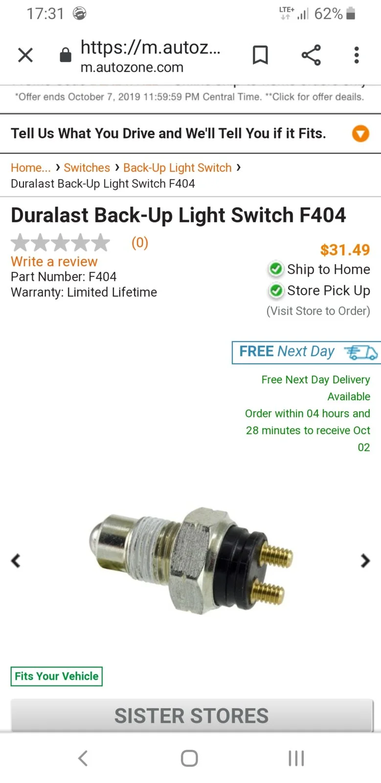

Got the car back from the transmission shop today. Huge reduction in engine/transmission noise due to the rebuild and steel bearing retainer. I also swapped out the rear back up light switch and boom I have reverse lights. On to the next item which will be trying to resolve the windshield wiper electrical issue.
