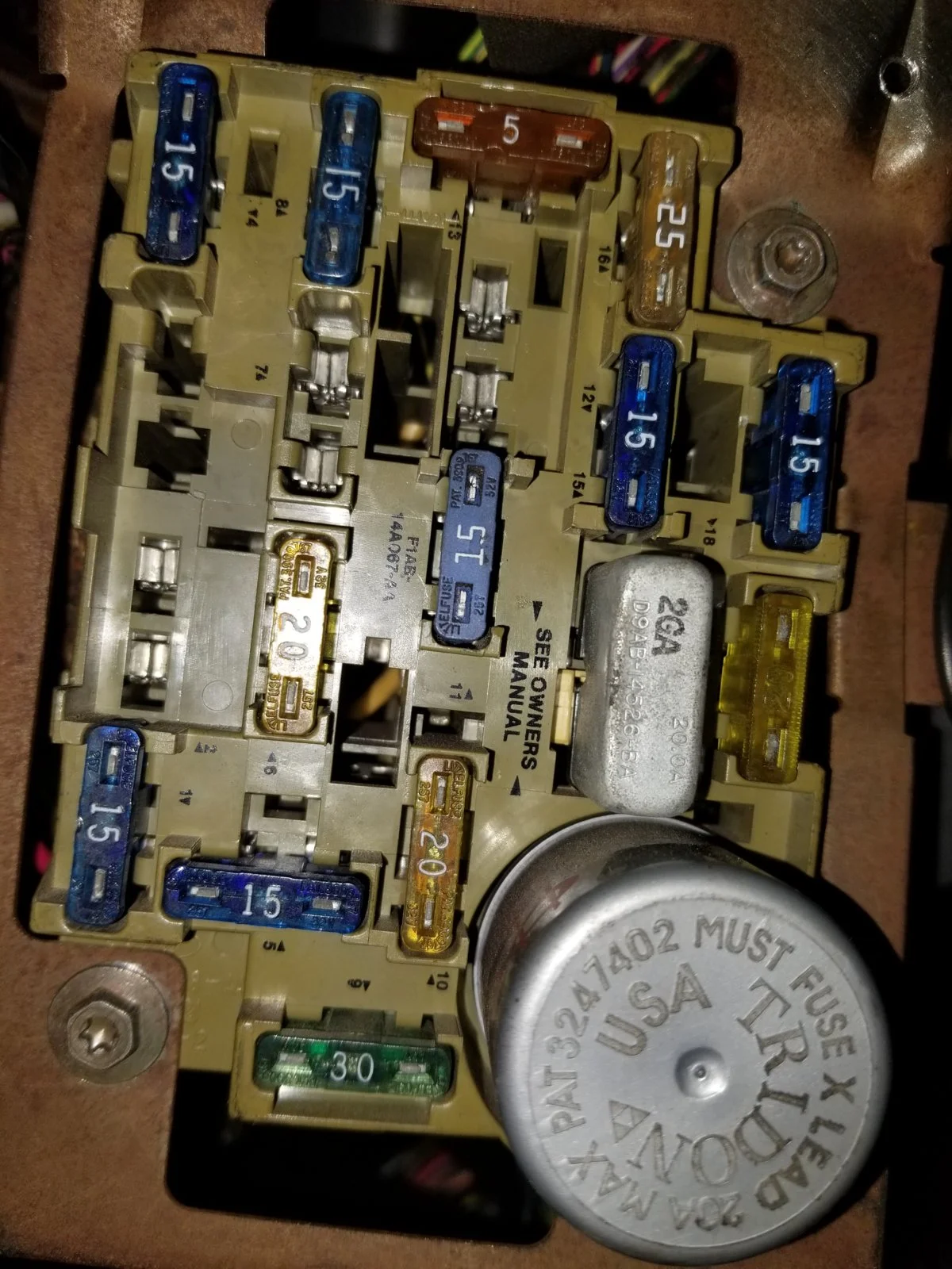

Does the '93 model year have a windshield wiper fuse? My Haynes Manual doesn't reference one and I've researched this topic through old Stangnet postings.
I have started with this thread from 2015.
With my windshield wiper stalk on high I have .06 Volts. On low I have .03. In the variable setting I have no volt reading. I'm thinking the switch is bad. My turn signals work and my battery instrument reading dips along with the blinker blinking, but I have no indication when I turn the windshield wiper stalk at all.

I spent $6 at Autozone purchasing a D9AB-14526 BA circuit breaker. No difference. Pulled a 15 amp fuse from another spot and plugged it into #2 and BOOM! working windshield wipers. Thank you Sir General karthief Esquire.

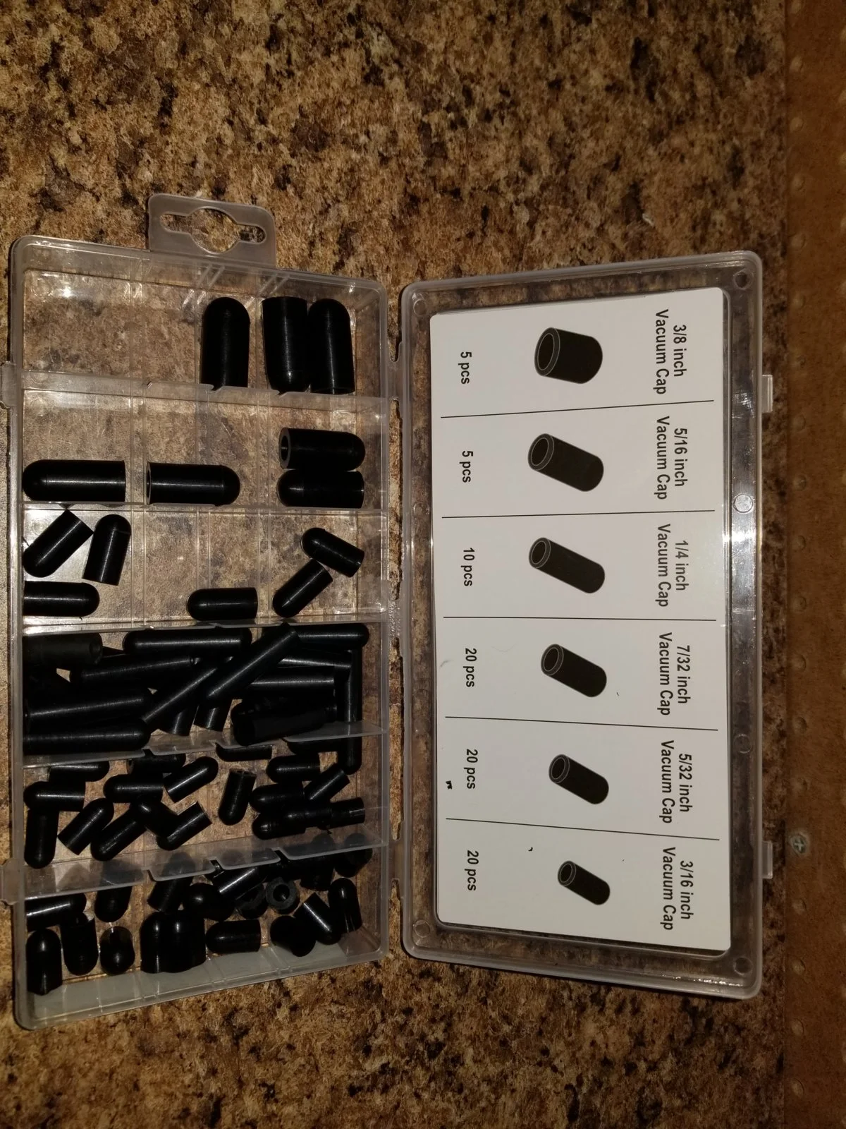

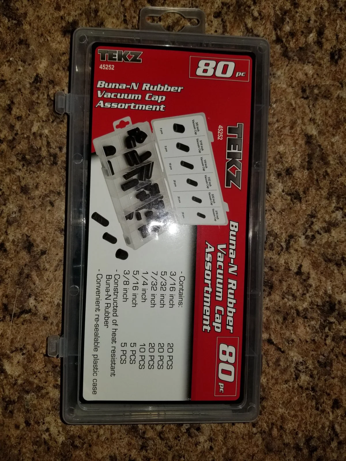

For any of you that have missing vacumn caps or have multicolored ones, Amazon is selling an 80 pack for $10. Easy way to clean up or install same colored black rubber "plugs".
