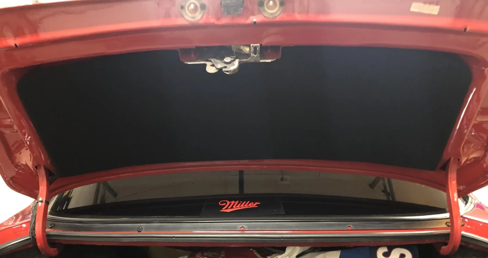

Cool. Thanks. I remember you mentioning the undertrunk liner. I've heard of the coupe trunk liner going for $350 and up. I was able to locate some convertible lining and will see how that looks once it is reinstalled.

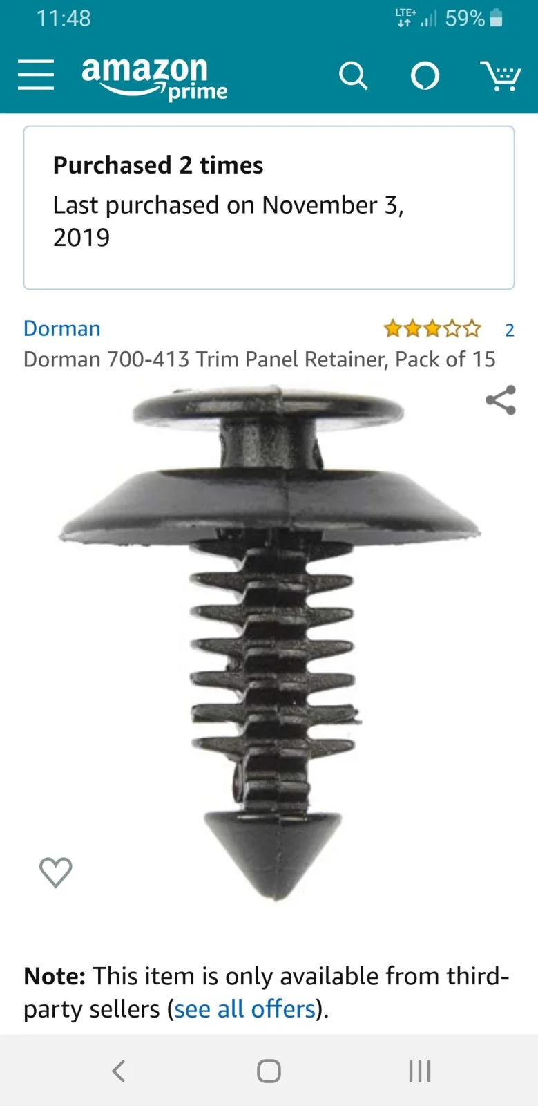

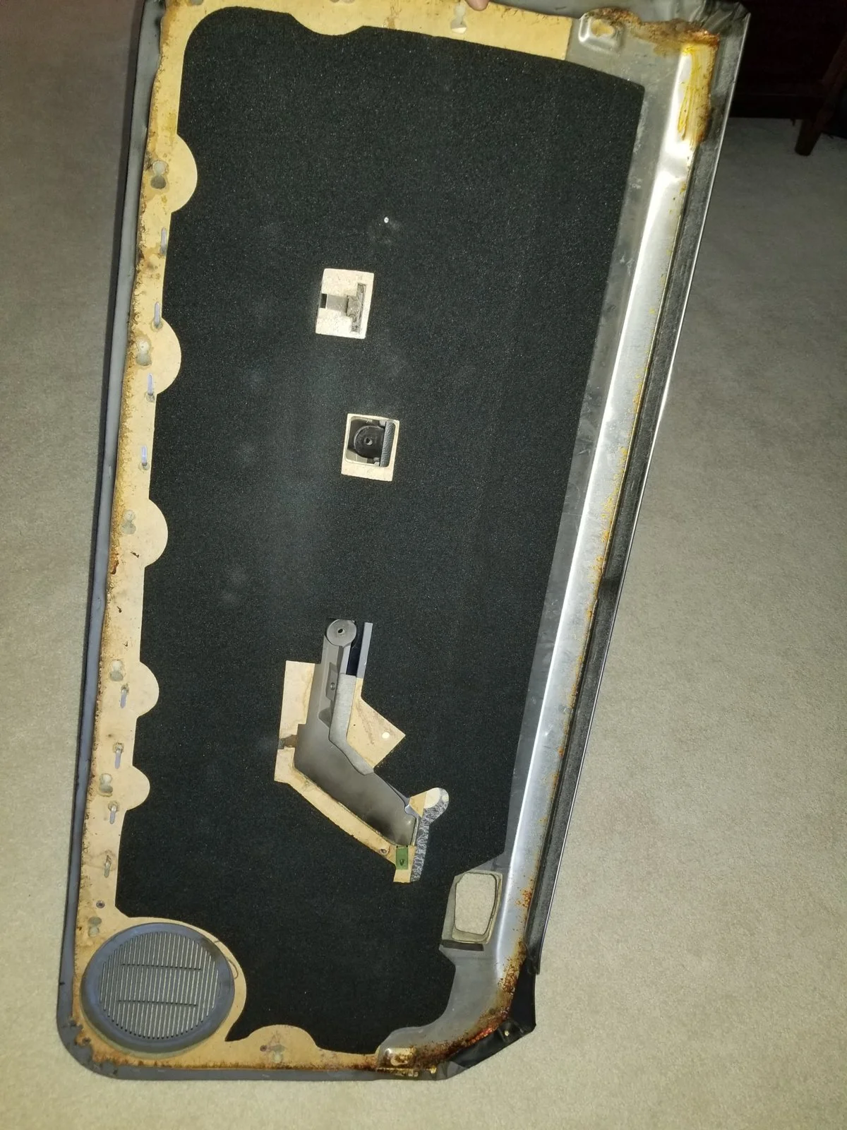

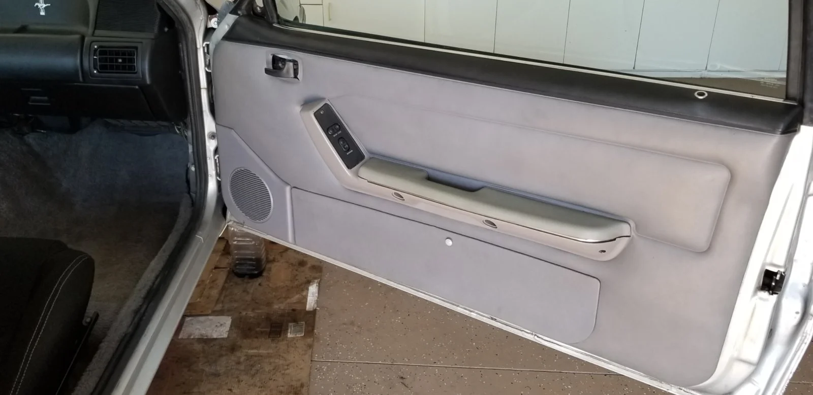

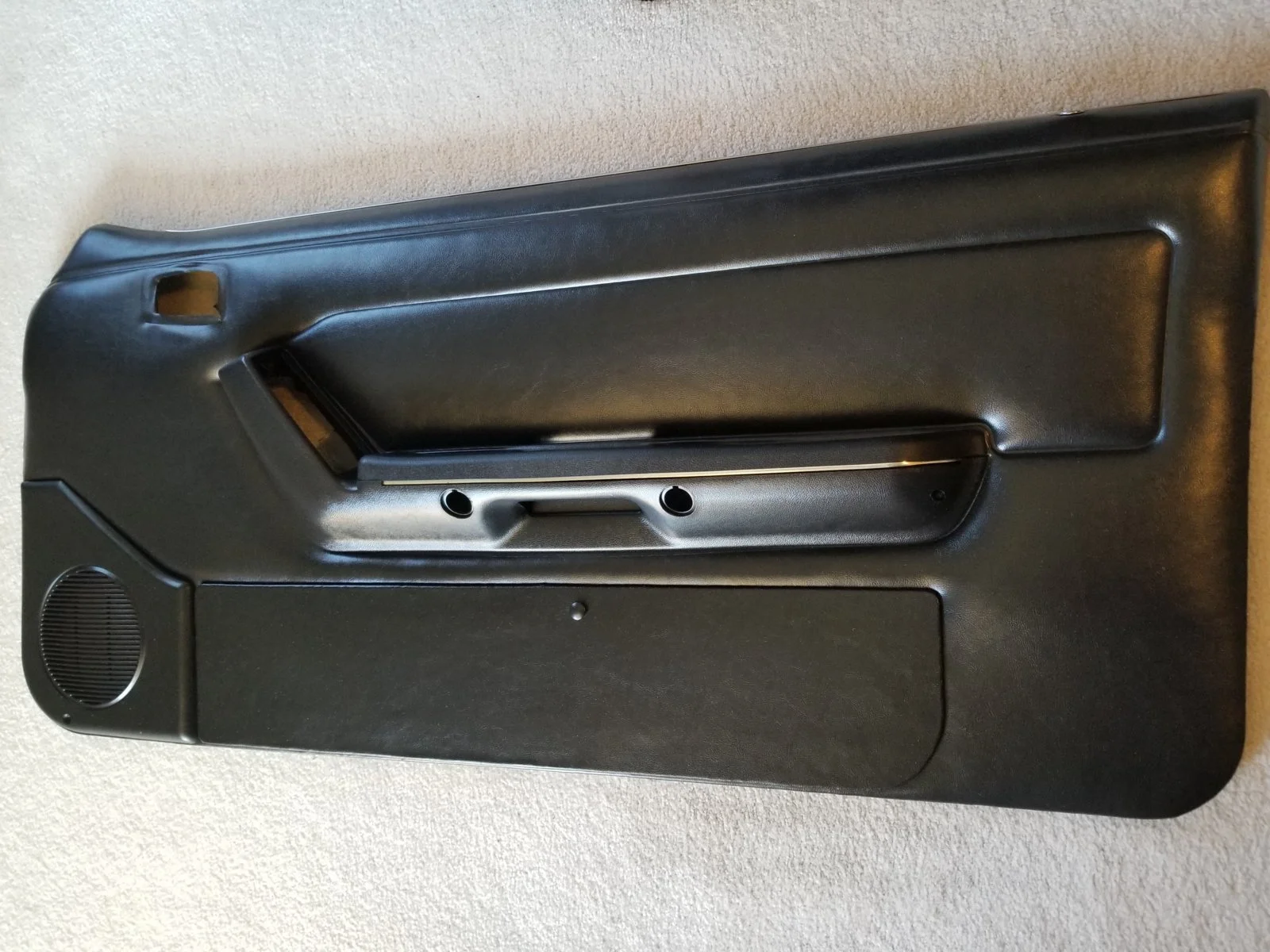

Spent a few hours yesterday cleaning, repairing and repainting my door panels. Another necessary step in the stock gray to black interior swap. I only replaced the armrest pads as everything else was in good shape. I learned that the door push pins are Dorman 700-413 pins. They are available on Amazon as your local auto parts store likely won't carry the 24 you'll need. It's amazing how much abuse the door panels get as my panels have been on and off again multiple times.
