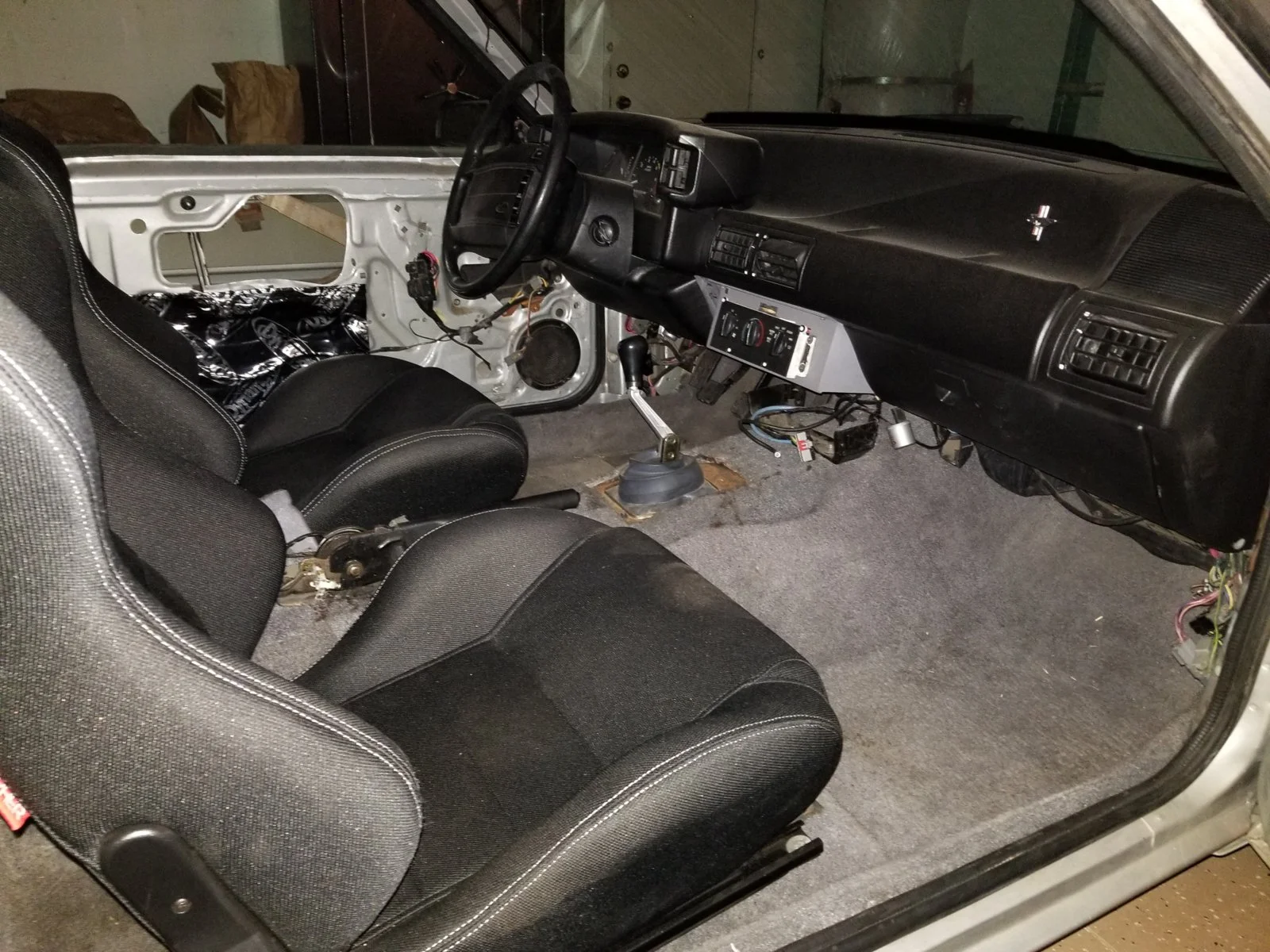

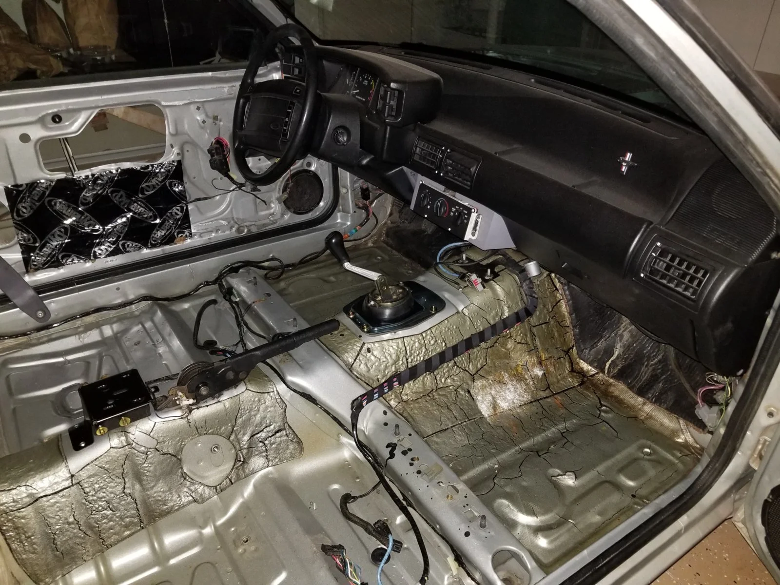

More pre-paint and body prep work. Goodbye old carpet!

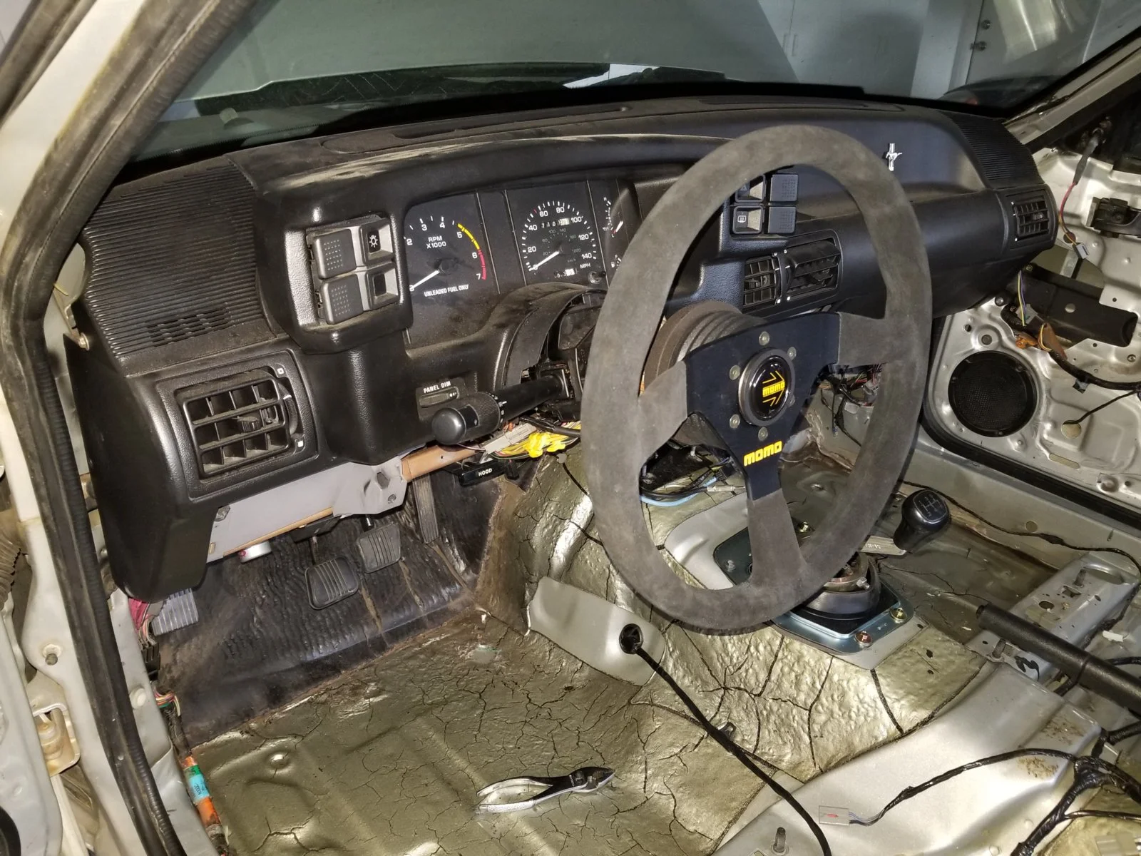

Car is mobile and running very well with a new power steering pump, '03 Terminator steering rack, tilt steering column and most importantly no squeaks/leaks. The MOMO steering wheel in microsuede is fantastic. And while its slightly smaller size will take a little getting used to, it's a huge improvement over the '93 airbag wheel. Going in for paint and body in one week. Car is almost "done".
