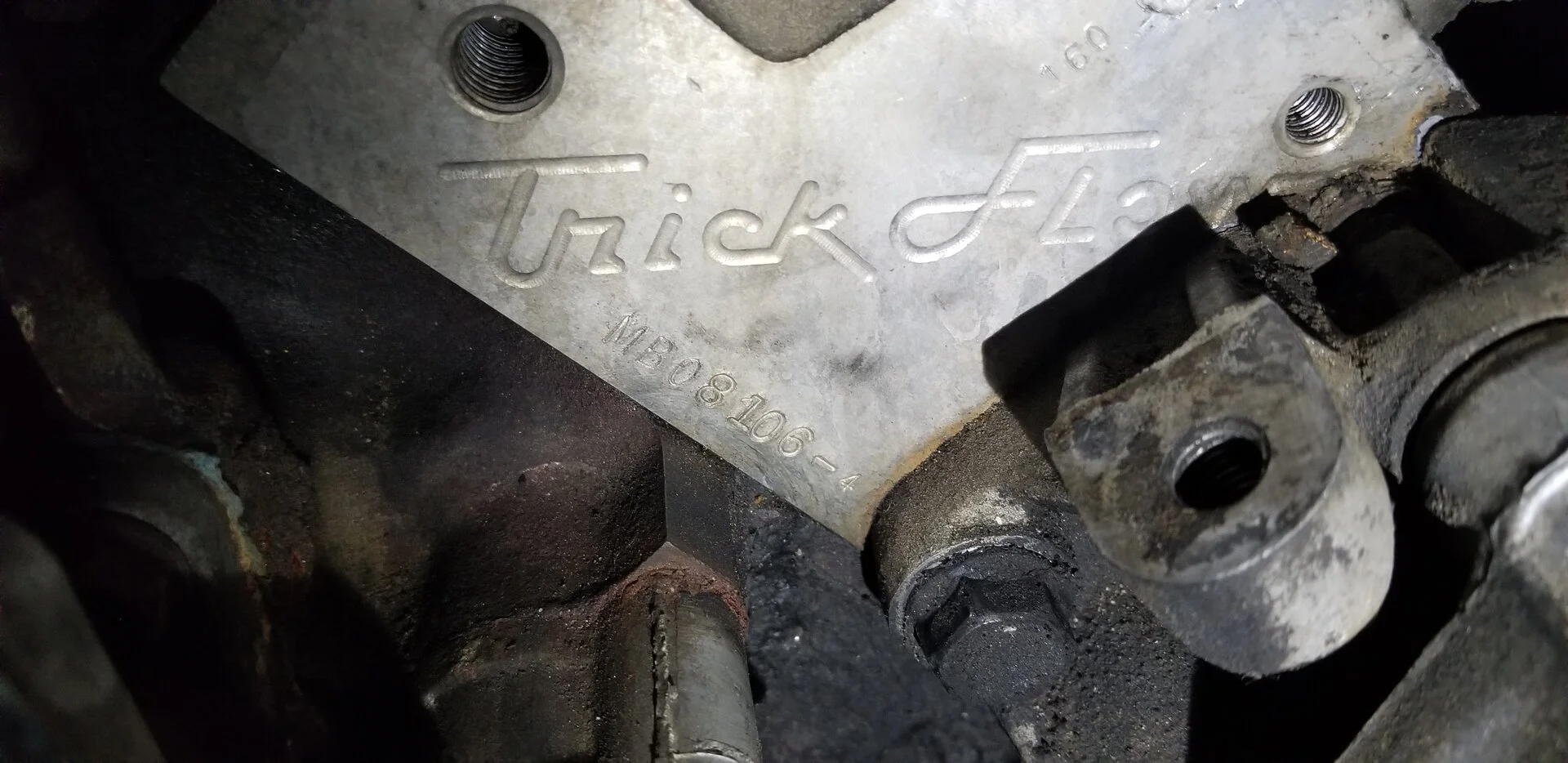

Just called Trick Flow (TF) as I'm doing some research on my engine combo. If you have TF heads, but aren't sure which ones...here's the cipher.
"-1" or "1X" under your valve covers: 170cc
"-2" or "2X" under your valve covers: R head
"-3" or "3X" under your valve covers: hi port
"-4" under your valve covers: old 190
The stamp on the front, see photo, means nothing in regards to size.

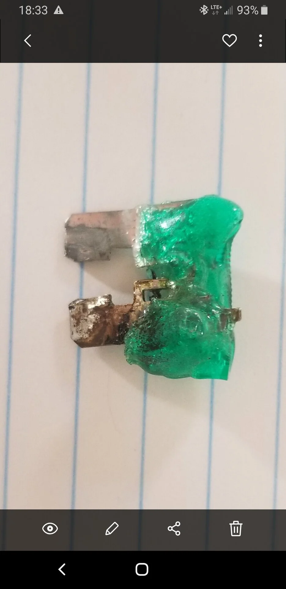

Think I found why my car has been so finicky while driving around in 95+ degree weather. Electric fan control module fuse literally melted. Called Derale and they suggested replacing the 30amp fuse with a self resetting circuit breaker. Done!

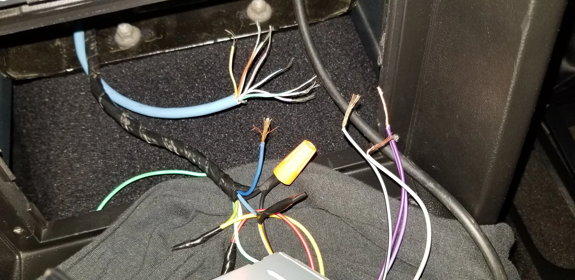

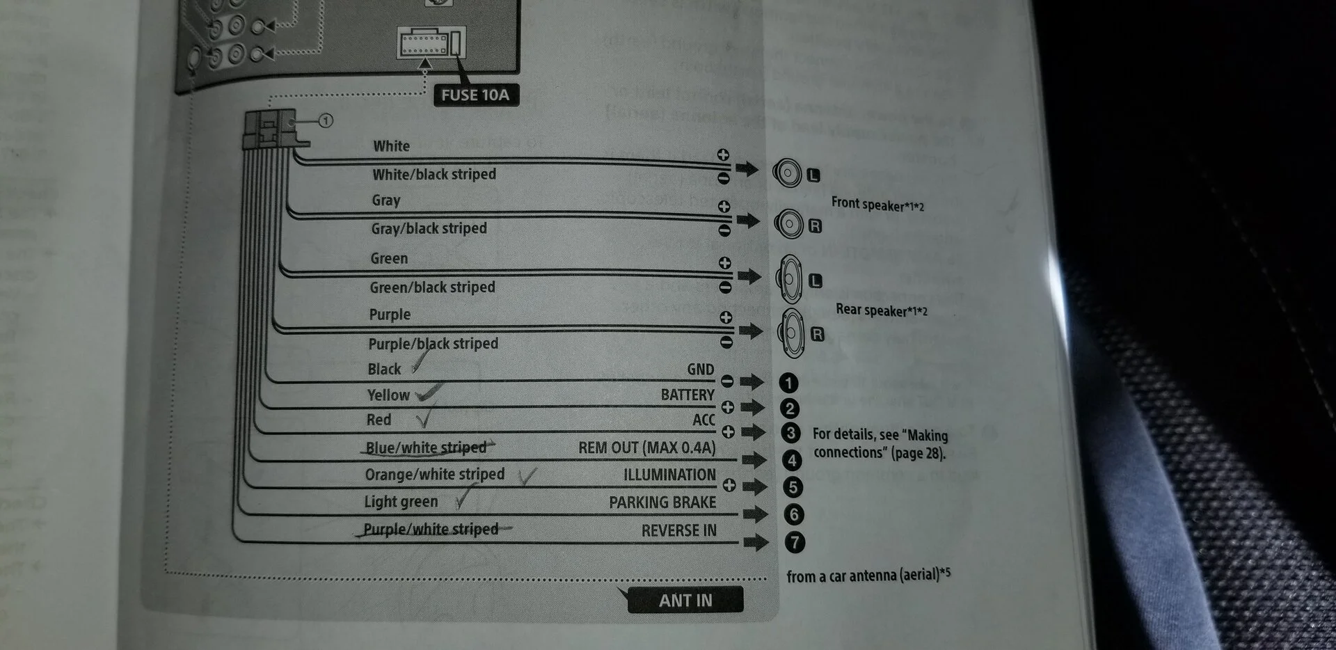

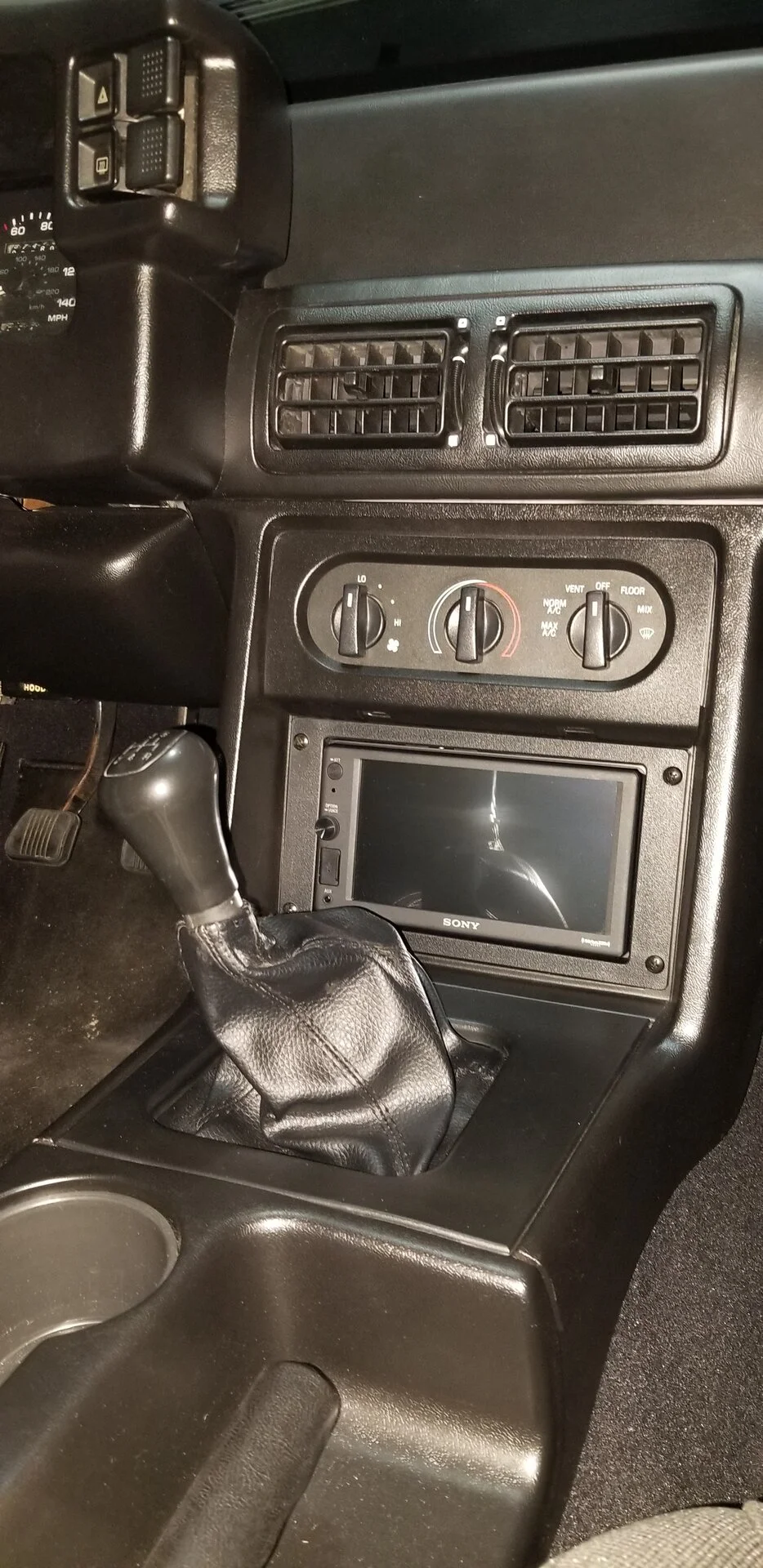

I'm attempting to install a new Sony double din radio into my '93. I've followed the instructions and have power, but no sound. I've attempted to research the Sony radio to blue amp wire schematic, but I cant find the right layout. I've even pulled one of the speakers to look at the wires which of course are correct, but I cant figure how to wire the radio up to the eight blue amp cord wires.
The "1988 Mustang Electrical & Vacumm Trouble-Shooting Manual" was helpful with power, but not speakers and I cant find anything on Stangnet.
This is all wrong. You should have bought a wiring installation kit. It would come with a black and a gray connector that would easily wire to the radio by color....and plug into the factory wiring with no cutting.
You want something like this
You are trying to wire the radio in series after the amp. The 93 Amp is only 80w, which is prob equal to what the head unit itself can do, so you want to bypass it. If you reach up into the radio hole, you'll see the other connections for the amp. Unplug those connections and plug the linked harness into the male end of the harness and connect that direct to the radio
Reactions: Boostedpimp
Ok. I see it now. It's literally behind the HVAC controls. So I buy the Metra adapter and plug into those and then wire the gray and black adapters (on the plain wire side) into the radio. And this removes the amp from the equation?
Yup. Amp at that point is just excess weight. Sell them on ebay as they go for decent cash, however the cut up harness will be a negative.
