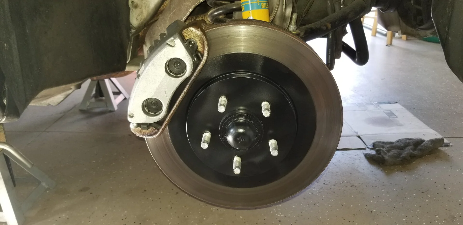

Another Saturday in COVID-19ville. What to do? O, I'll sand my rusty rotors and brake calipers and paint them with high temp VHT in satin black and clear coat. Must... ...remain.....productive.

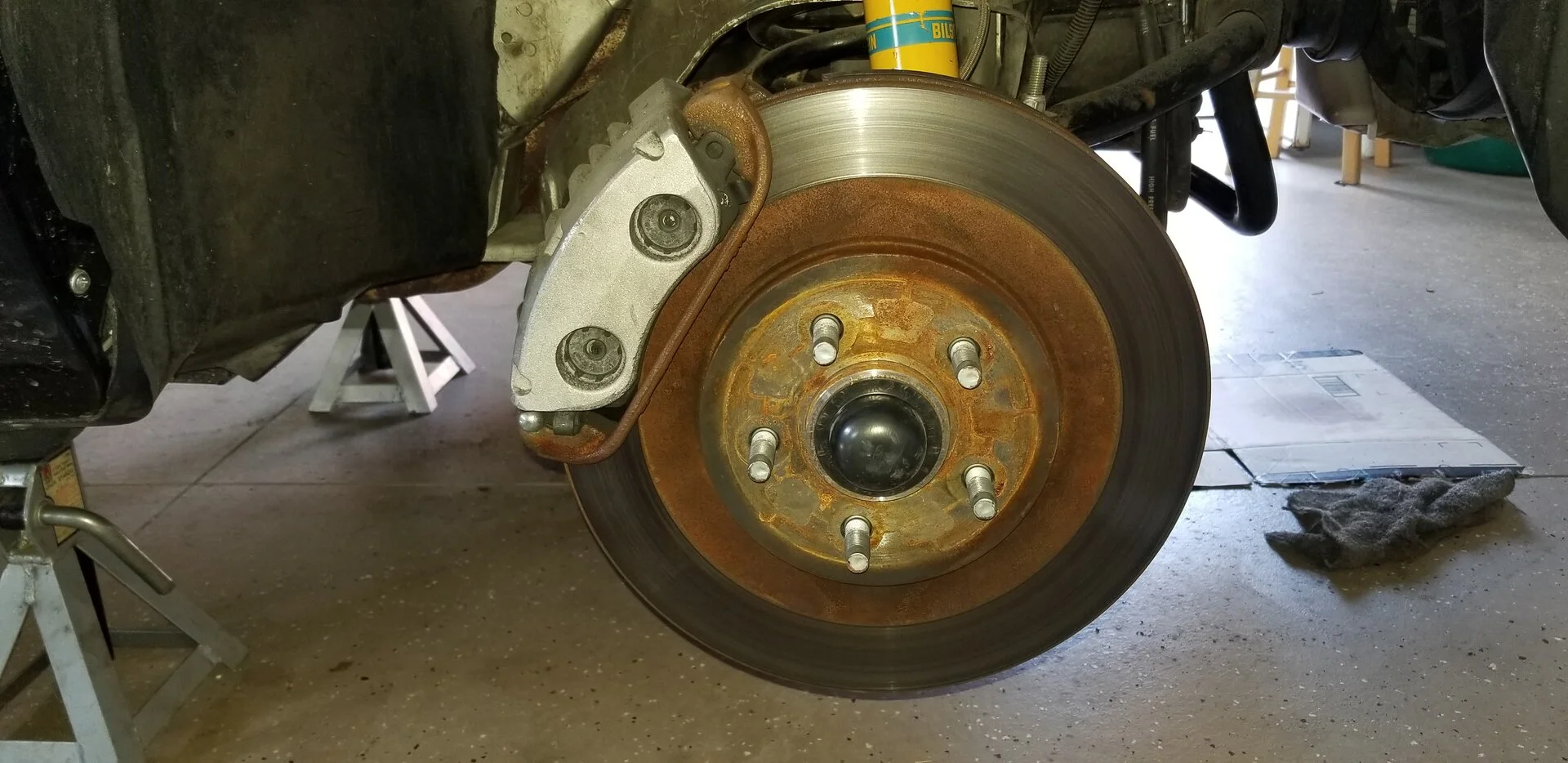

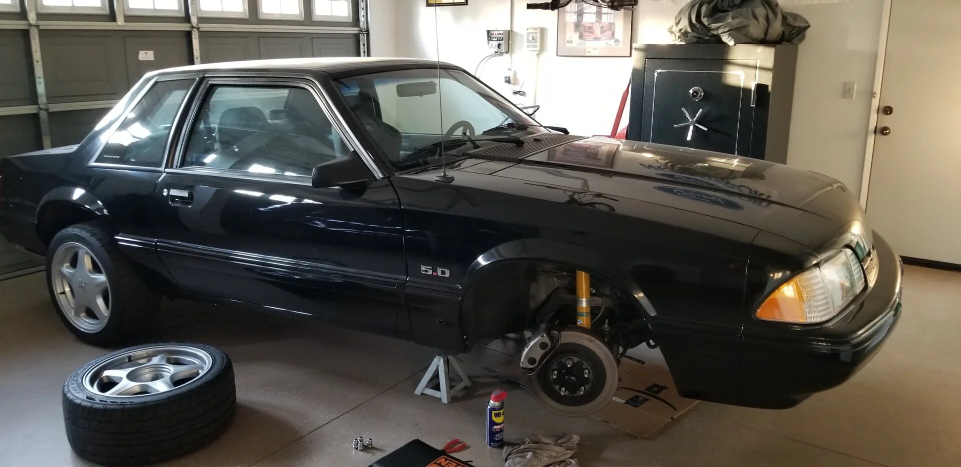

My front right caliper and rotor seem to be rubbing ever so slighly. Did the ol' free standing wheel spin test and it rotates quite a bit less than the left front. Also, more brake dust and an audible shreak when i apply the brakes. I'm thinking my pad bedding was not sufficient? Any tips on how to correct this? I'm 100% sure there's no air in the lines and the car brakes straight, but there is clearly a rubbing and higher brake effort on the front right. Front right also locks the tire before the front left. Thanks all.
You may have a caliper sticking or the rubber brake hose may be bad.
Reactions: JKWilson61

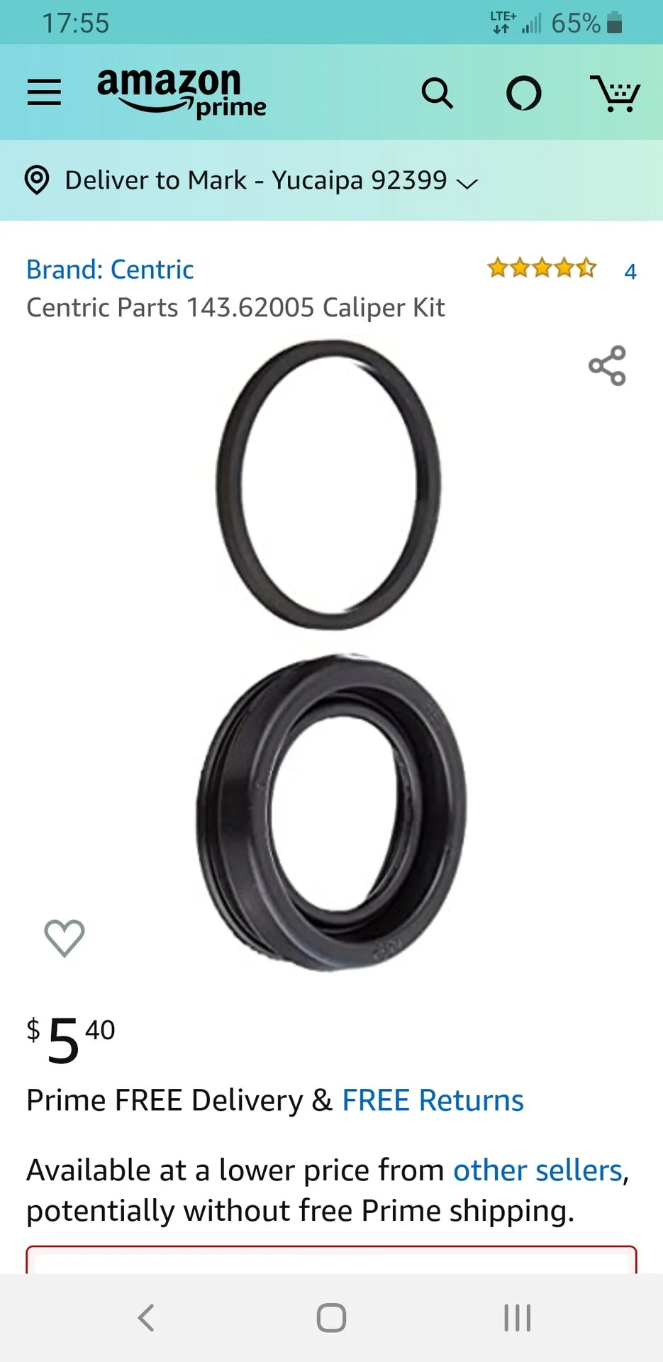

So I finally got a chance to diagnose my excessive brake dust and screeching noise from my front right brakes. Turns out one of the rubber booties holding one of the pistons has a small tear in it. That explains the excessive dust and locking up at high pedal pressure -one piston was grabbing over the other. Lame that Rockauto only warranties these for 90 days!
