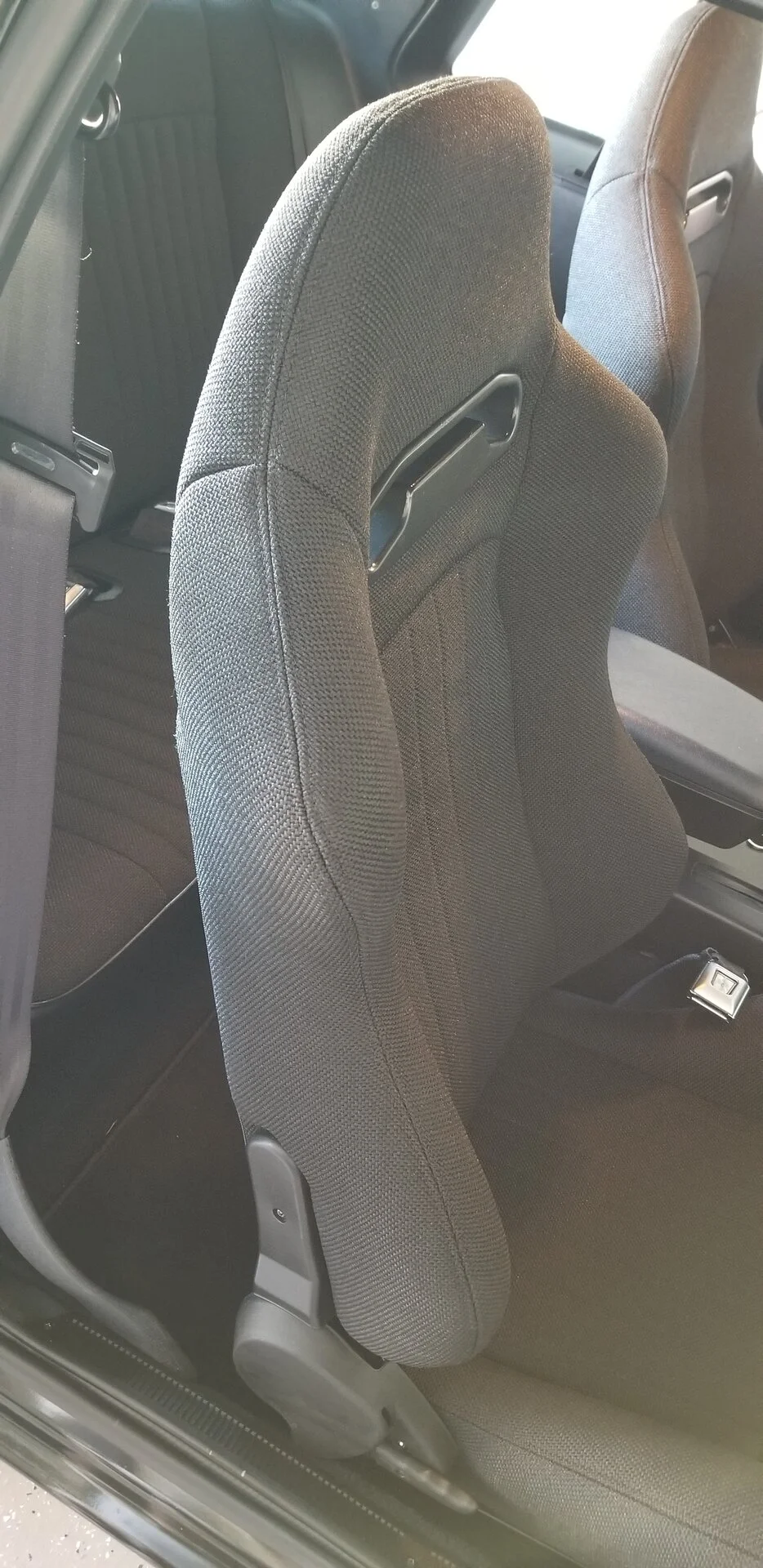

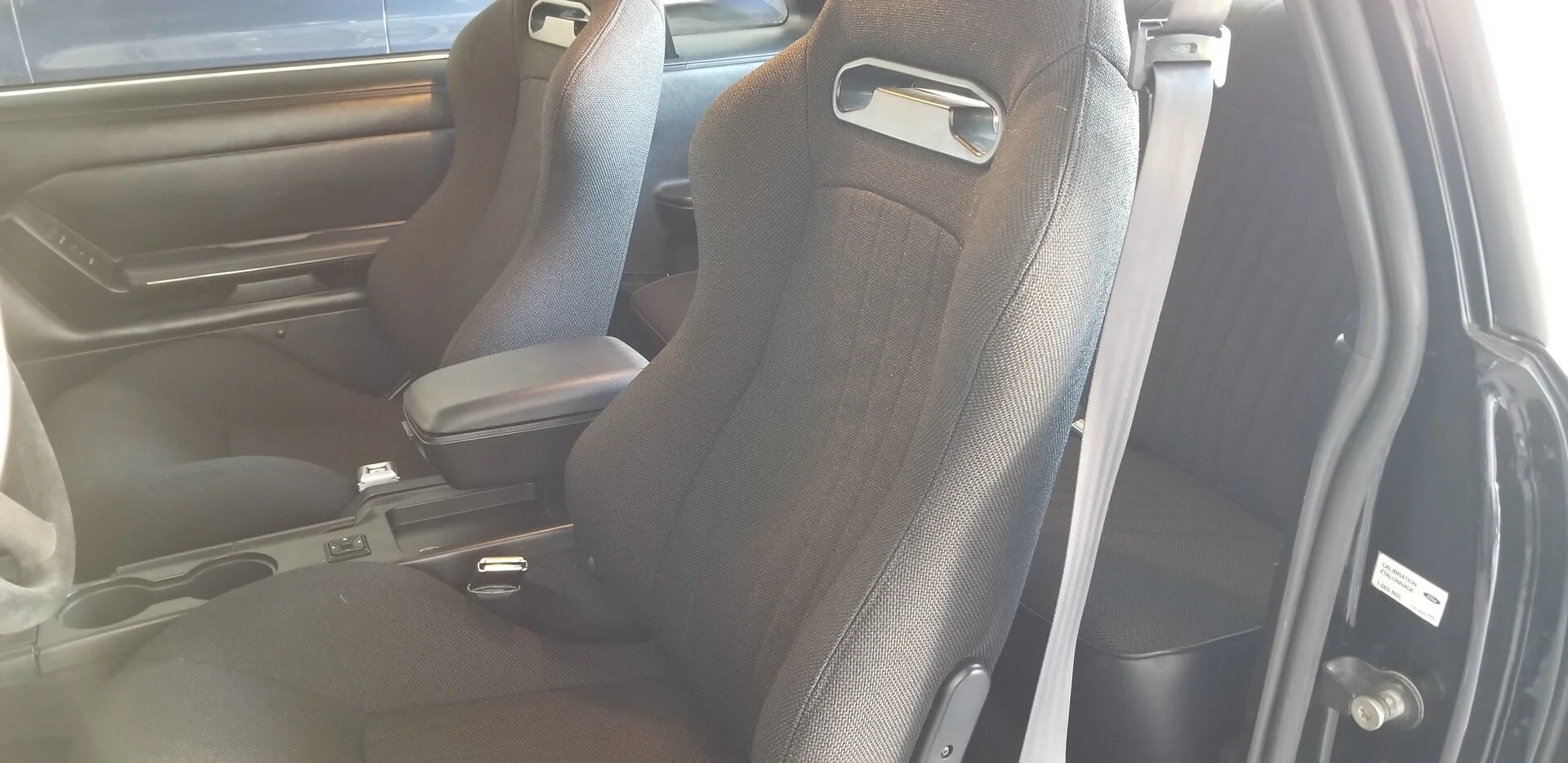

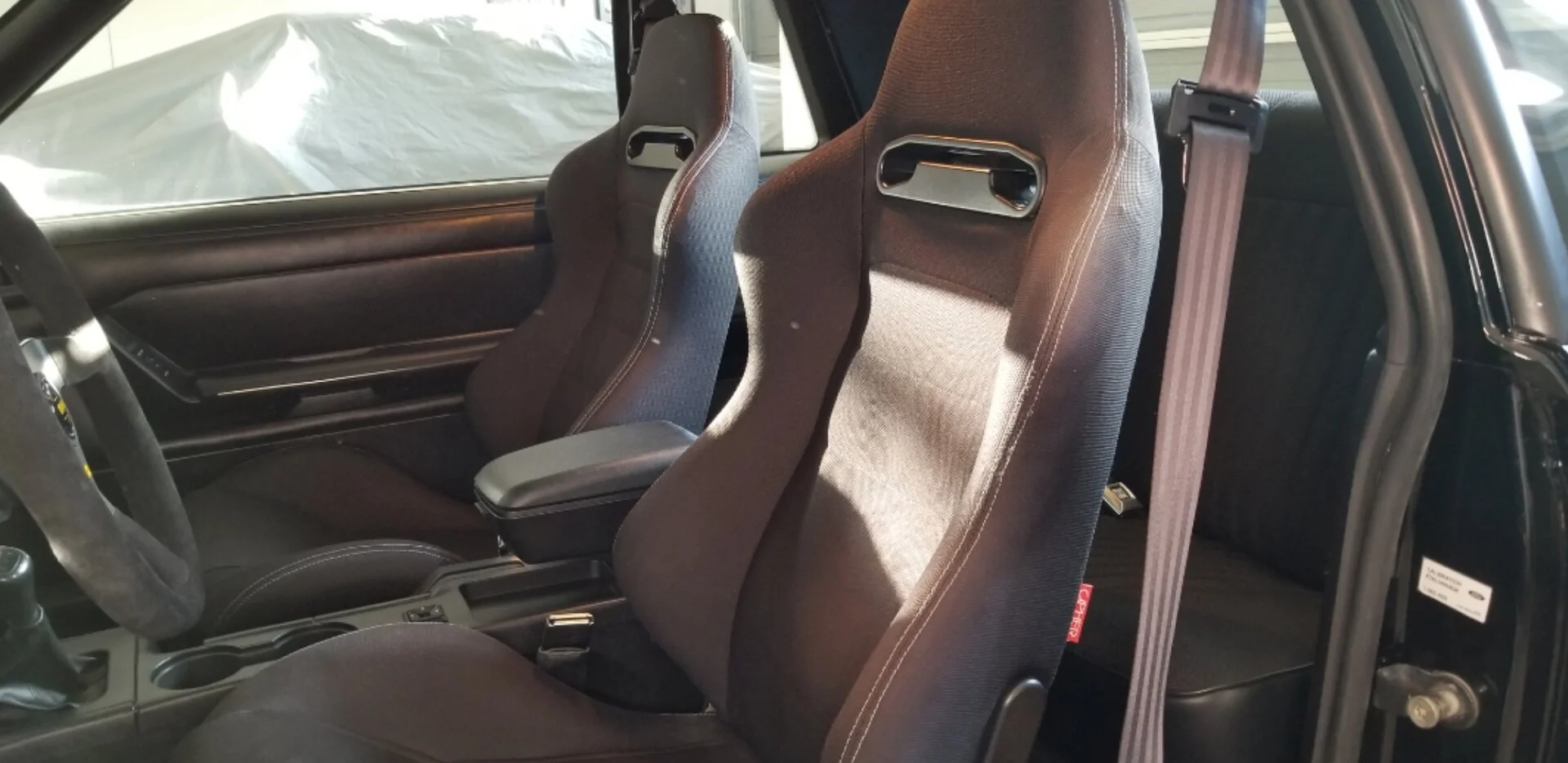

Before and after front seat upholstery photos. The pleats match and everything.

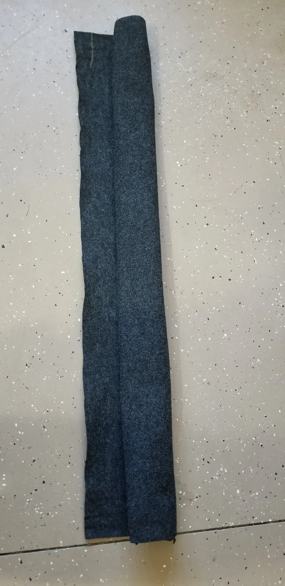

I found the matching trunk material at the same place I purchased the new seat material. I plan to wrap the metal battery box in the trunk material so it will look right at home and maybe even blend in a little. Seems like a very straightforward mod with maybe the worst part being dropping the tank to access the tie down bolts.

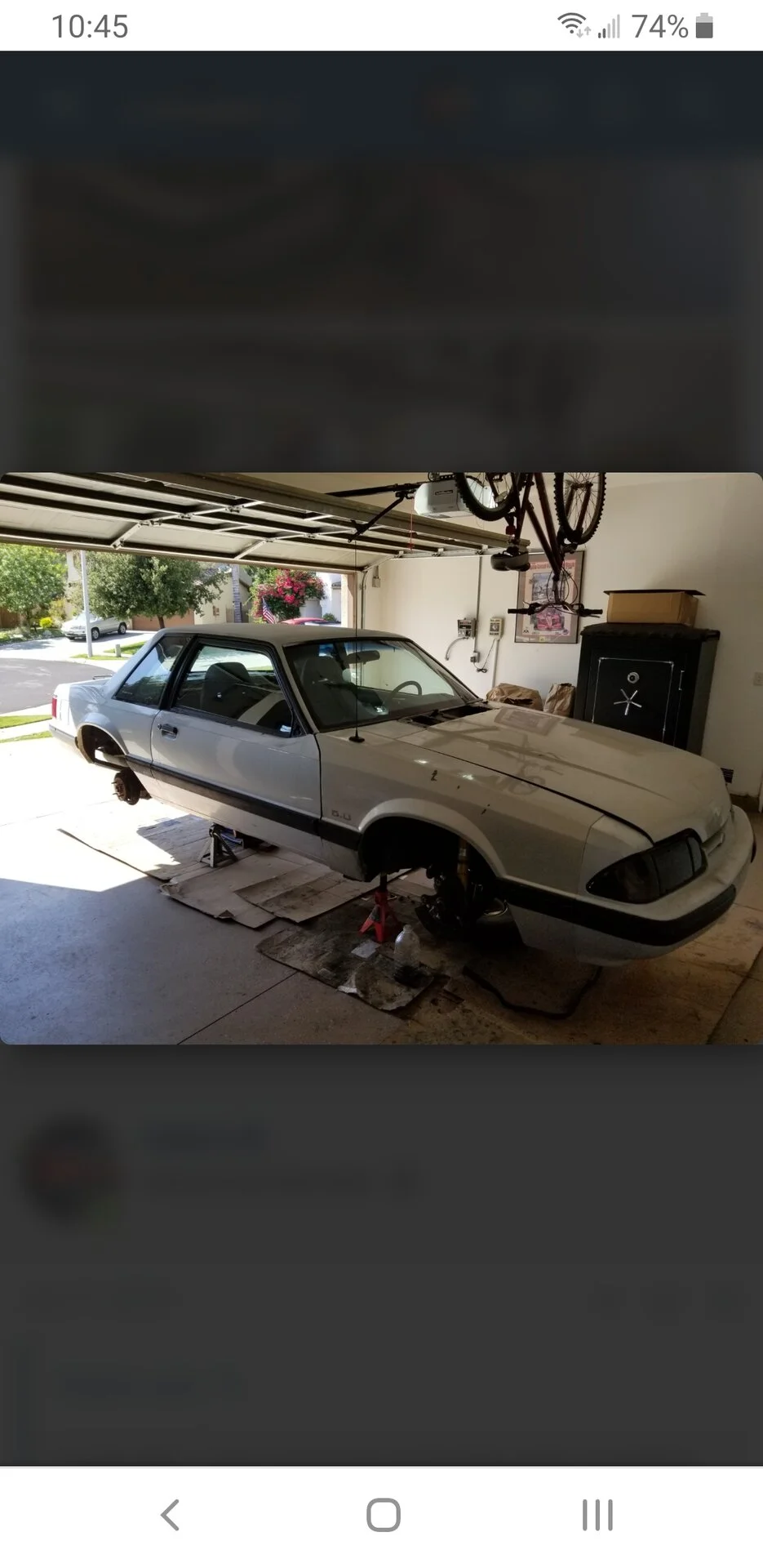

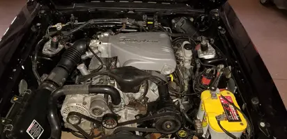

One more of the before and after to celebrate a long 20 months (on multiple levels).

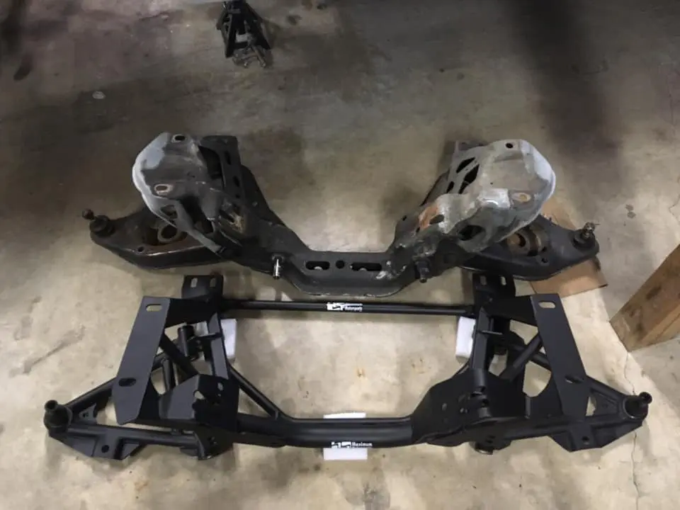

I bought all the pieces over time however, and since LMR sells MM parts, I took advantage of their 6-10% off codes which did apply to MM parts. I bought my K-member and A-arms this way which knocked $100 off the retail price. Also, MM themselves would do weekend sales in the holiday seasons where they would knock some $$ off.
So it was definitely over $2K, but not sure if I hit $3K. I also have the rear suspension parts too, subframes, Strut tower brace, panhard bar. Add in those costs and i'm over $3K for what i'd spent on MM parts on this car. Not cheap stuff, but high quality.

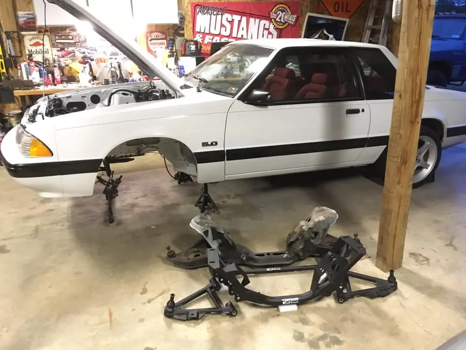

I also did install the Coil-overs without the K-member. I'm only installing the K-member now, but I noticed a definitely improvement with just the coil-overs alone. If I didn't just pull my engine out and found my stock k-member bent, I prob would have just left it all alone and still have the stock K-member.
I will say that the MM parts, when properly matched, do not make the car ride poorly at all. My setup is geared to street driving, so someone putting a road-course setup on their car won't say the same thing obviously.
EDIT: I have basically this package, pieced together, but with the K-member and A-arms as well (Another $1K) and a few additional MM parts. I also have their better rear LCA's. So probably $3.5K-4K retain in MM stuff on my car.
