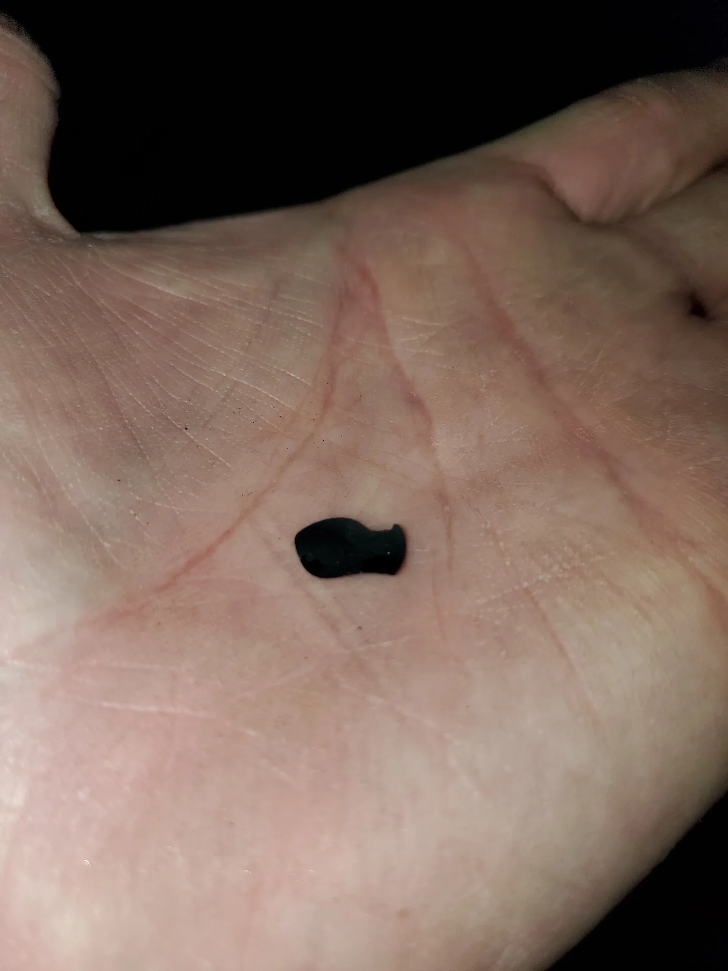

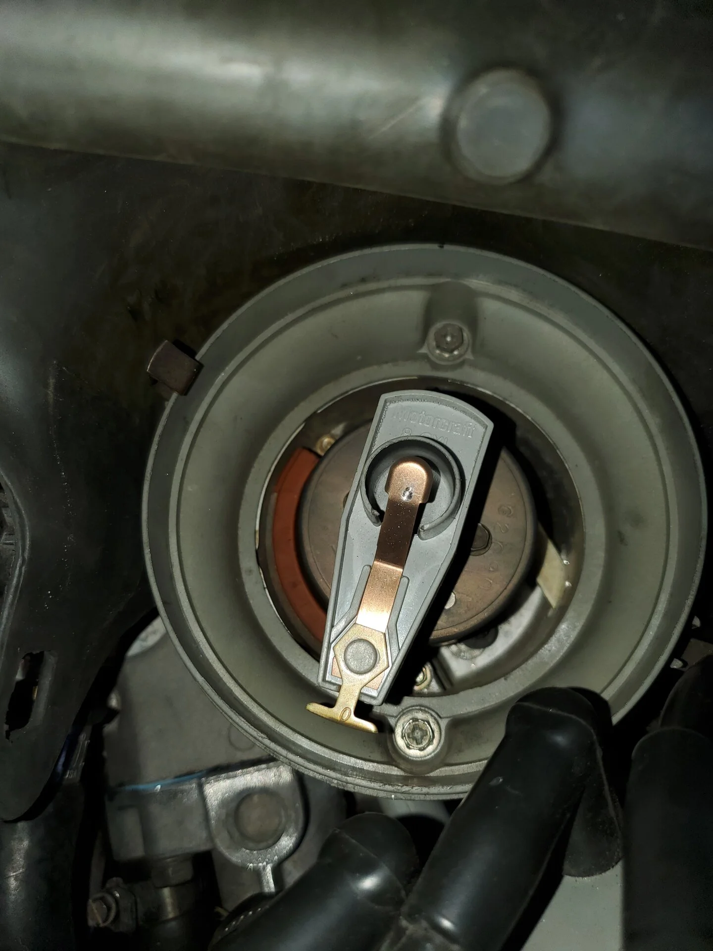

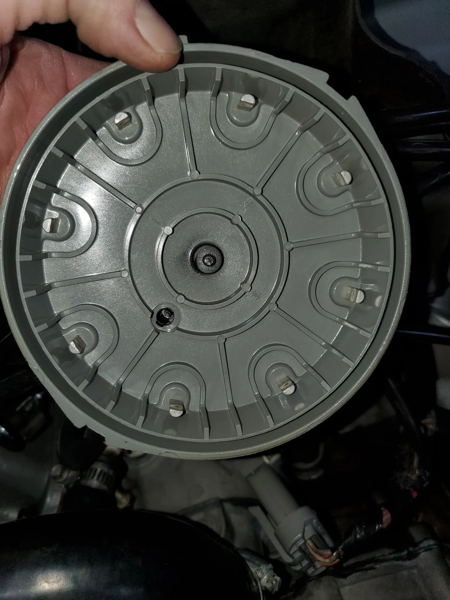

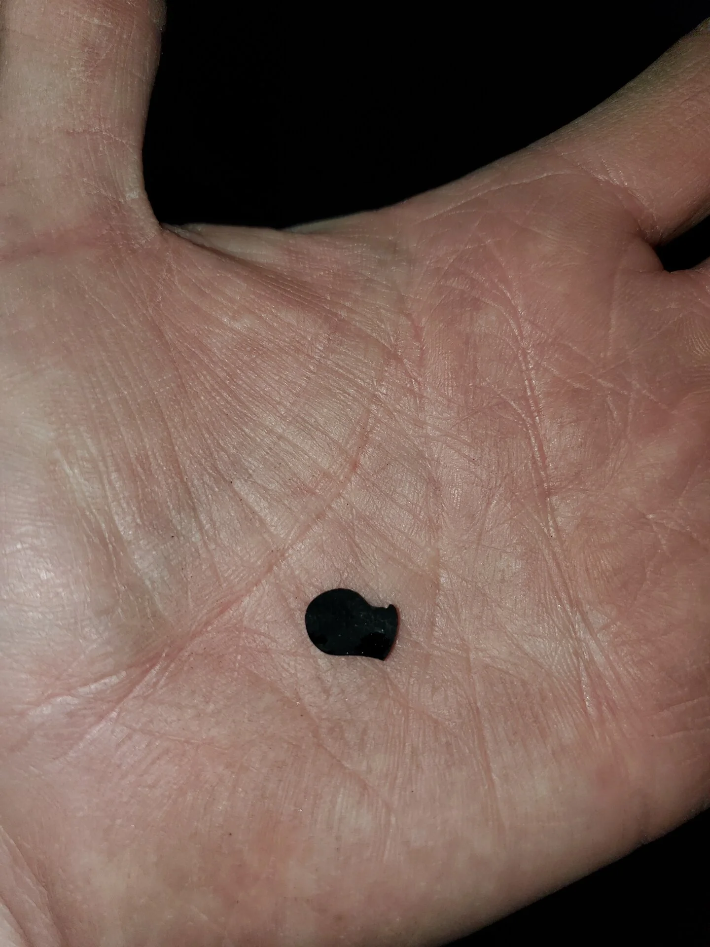

Inside of distributor mechanically looks good except I found this little round thing. Very odd.
Vent, ignore it.
