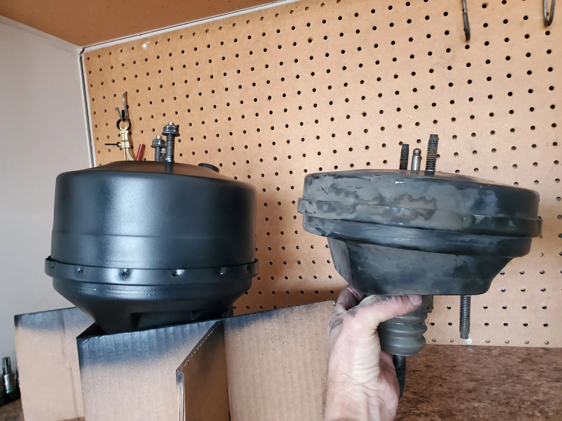

Finished the brake booster install today. Took me more time than anticipated and I ended up removing my driver's side seat, much of the lower dashboard below the steering wheel, the intake, clutch cable and the windshield wiper motor. I ended up cutting down the two bolts on the passenger's side of the booster and slotting the two passenger side holes. The booster slipped in with a little motivation. The most difficult part was figuring out why the brake switch would not work as before. It would stay upright causing the brake lights to stay on or too far downward and the brake lights would never come on. I ended up using the universal tool - a zip tie.
Overall the Cardone booster gives the car a more traditional and progressive brake pedal. Spongy at first with growing firmness and increased braking capacity as the pedal is pushed. The 4 cylinder booster was always rock hard. I'll have to get used to the new booster.

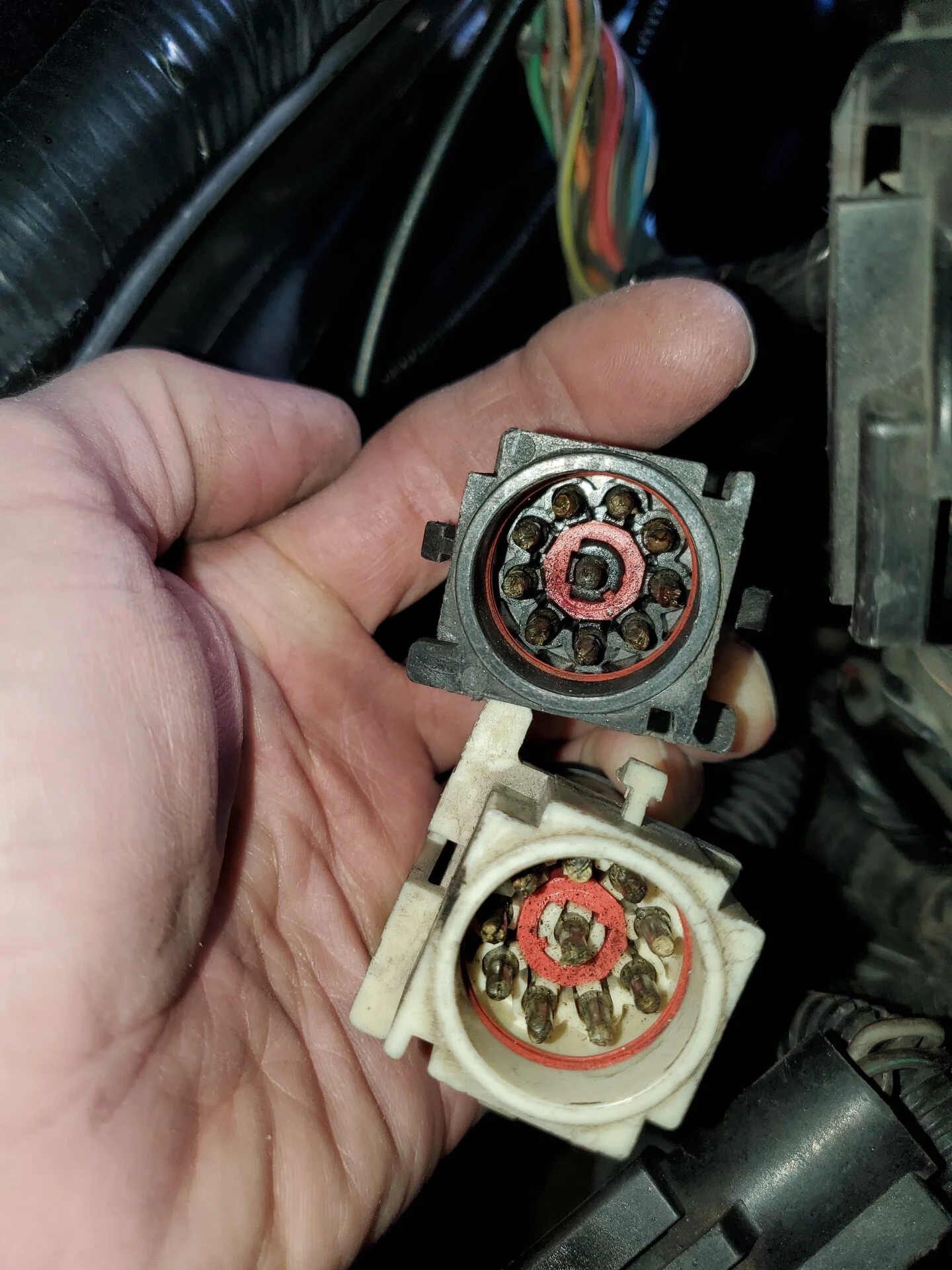

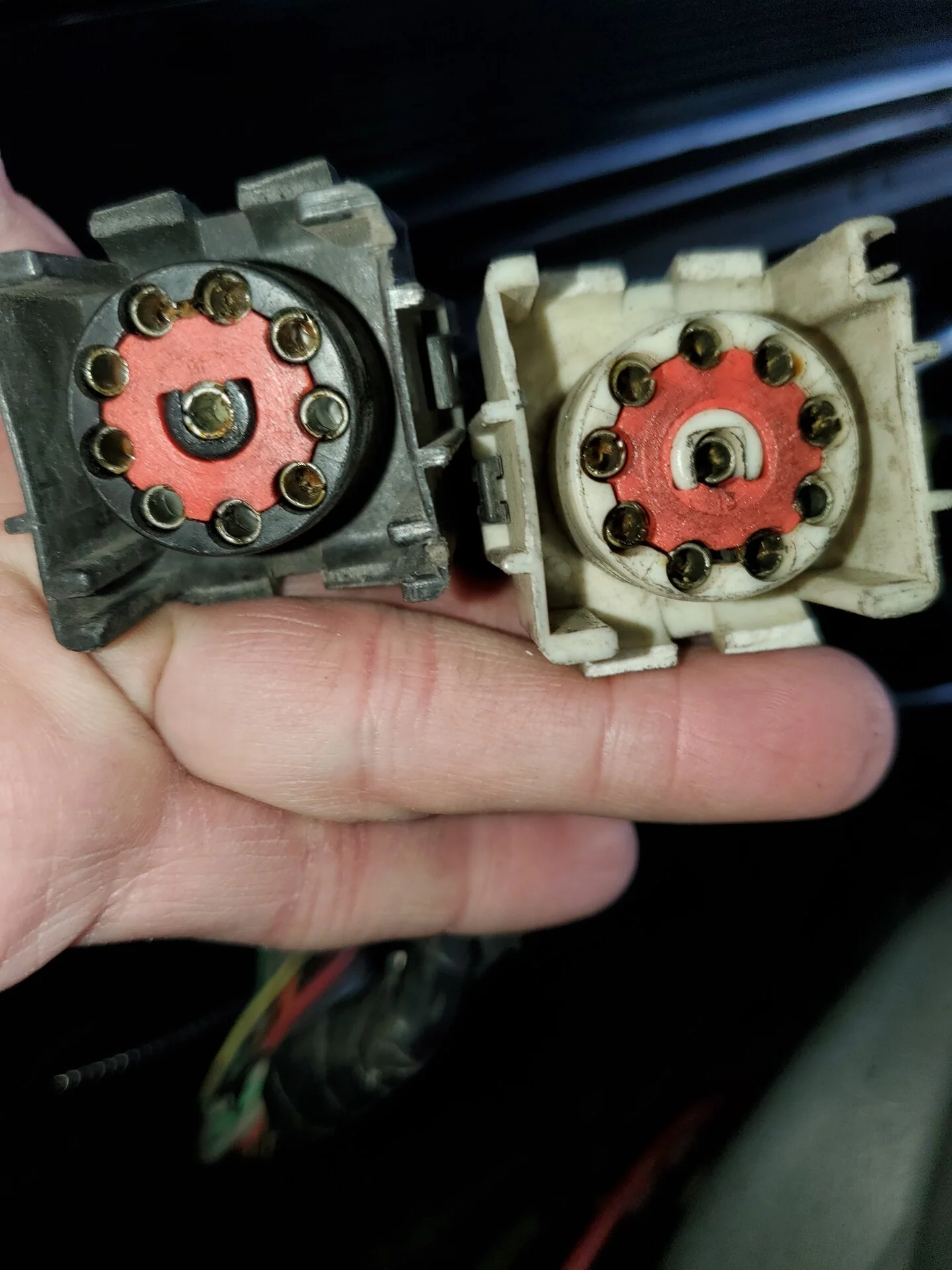

I can figure you have replaced the usual things and tightened the prongs on the ten pin connectors, have you checked the timing chain?
The hot engine 'studder' is rough to pin down but is usually a electrical connection.
The salt and pepper shakers are fully seated. Correct me if I'm wrong regarding the ten pin connectors.
I haven't checked the timing chain.
All electrical parts are connected and seem intact.
