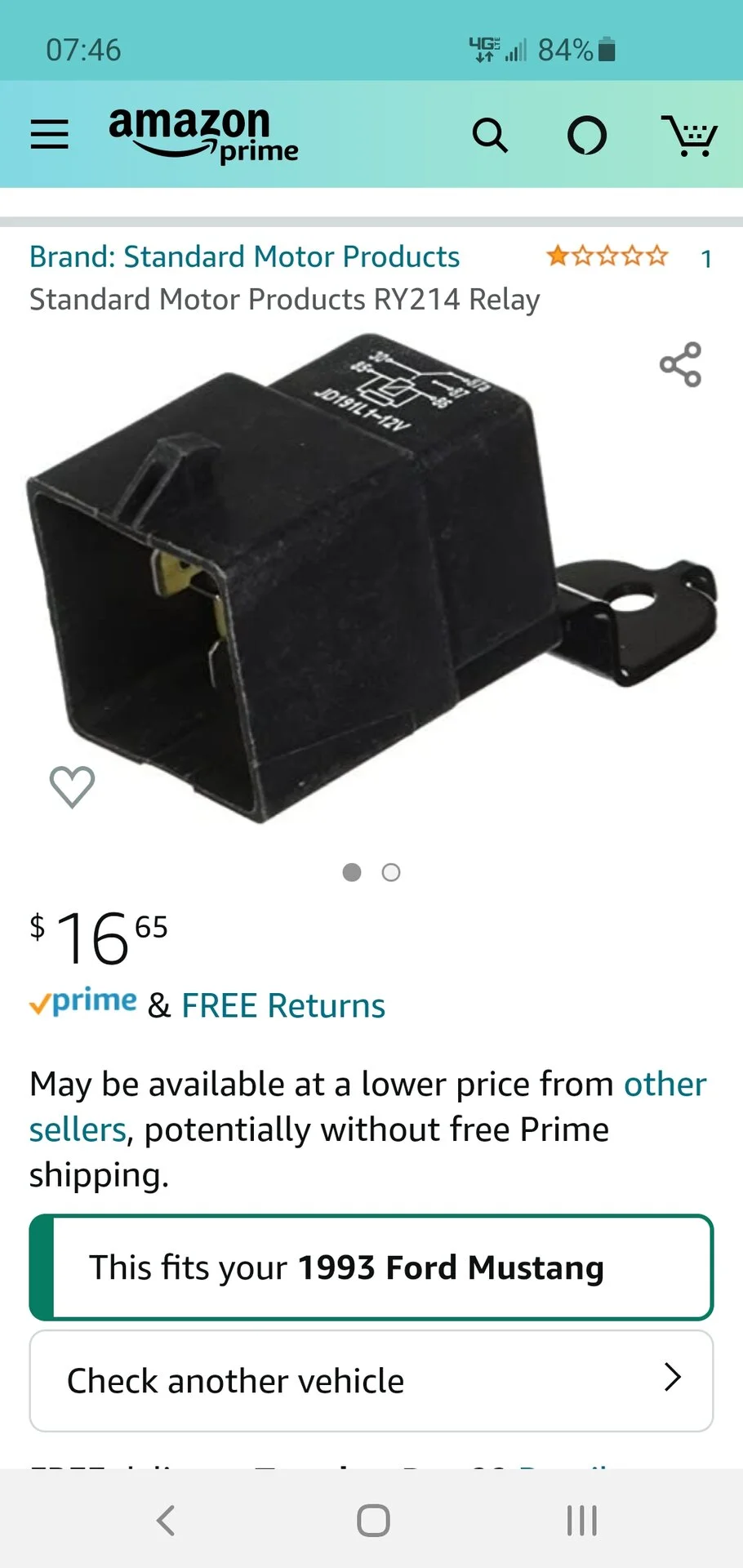

Maybe this thing is getting hot and not working as designed? IDK. It's an original part.

I was referring to engine temp, higher under hood temps could effect the relay/ wires, clean the contacts and install a new relay, the don't cost much.
I bought the fuel pump relay and will install it Friday. In the meantime my tuner advised me that my plugs are gapped to wide. They're at .55 and should be around .35-.38. Ill pull those and close the gap.

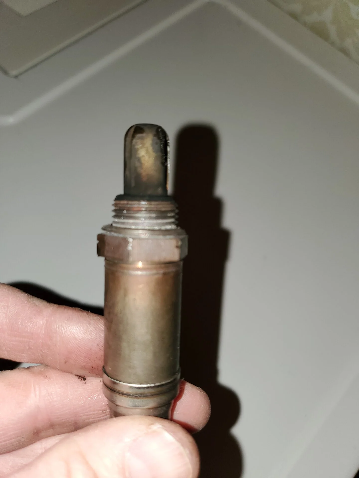

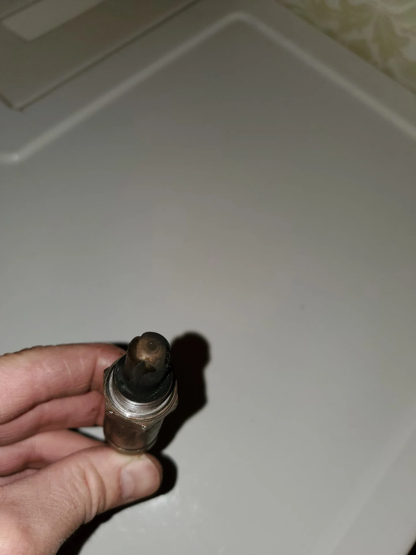

Pulled the plugs and reset them down to. 35 gap. Cold weather starting is a bit easier. Test drove the car. Same sensation. I could swear that the O2 sensors are bad because that is the bucking and hesitation sensation, but they're newer.

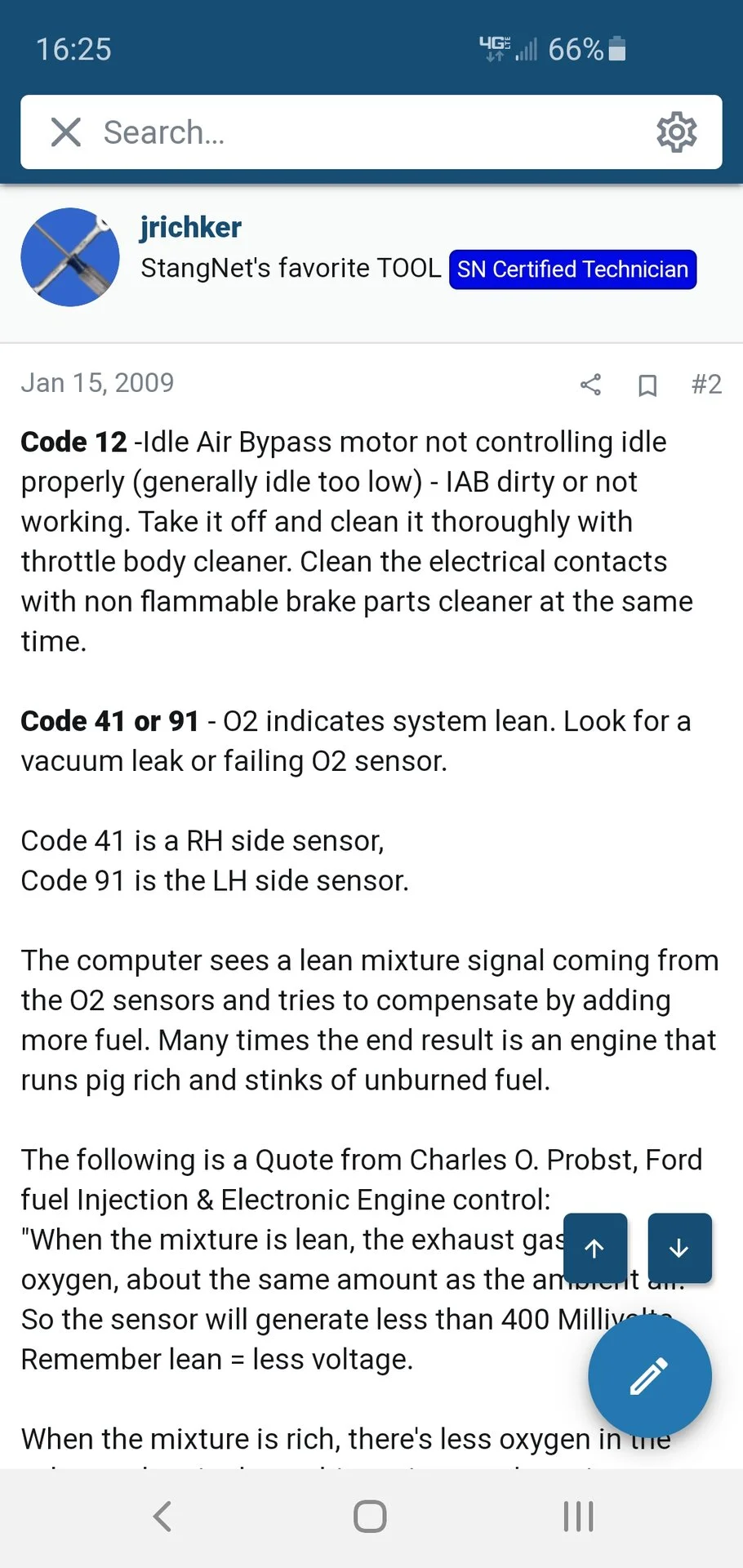

Threw another $80 at my car by installing brand new O2 sensors. Drove the car today and received the same fault code: "41 -Heated Oxygen Sensor (HEGO) sensor voltage low / system lean". Later, my check engine light came on and I ran codes again and received: "91 - sensor voltage low / system lean". The car acts in a manner consistent with dirty O2 sensors. What could cause bucking and hesitation especially while the car is hot if the O2 sensors are otherwise good?
Have you checked the wiring coming from the sensors? Just a thought
