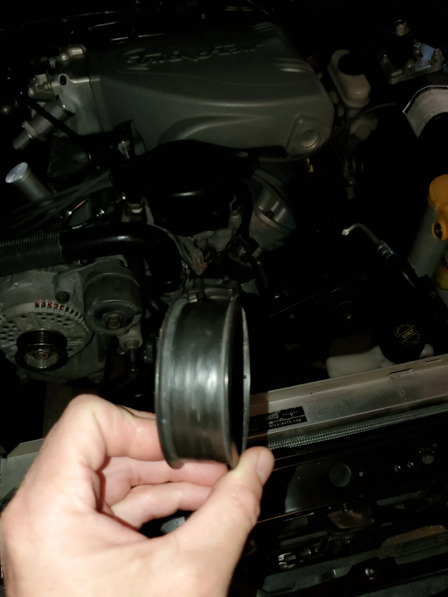

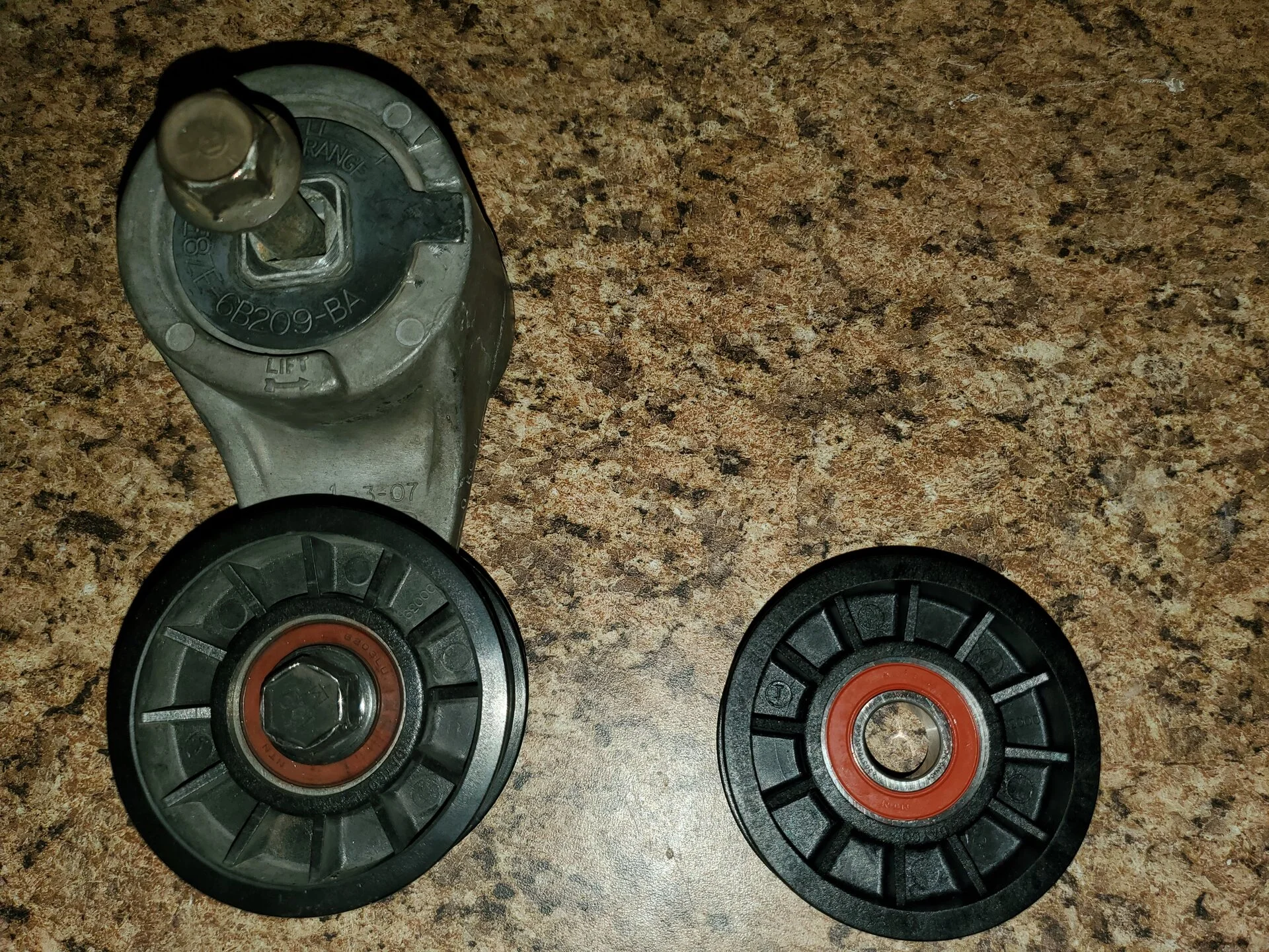

Had my water pump replaced under warranty yesterday as it was leaking from the weep hole. Mechanic encouraged me to swap out the tensioner pulley as it was making a bit of noise. Easy enough. Is the wear seen on the pulley somewhat normal? The bearing seems to spin fine, but it's a simple fix regardless.

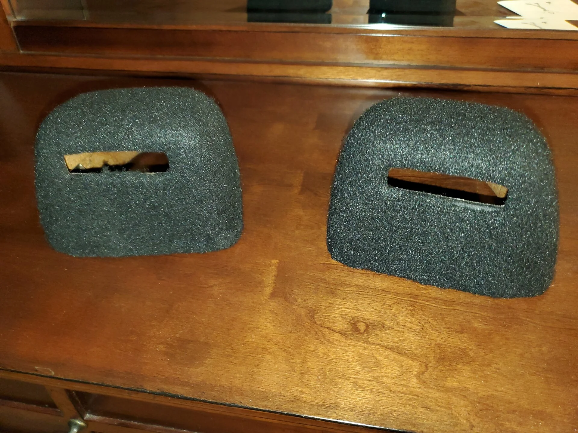

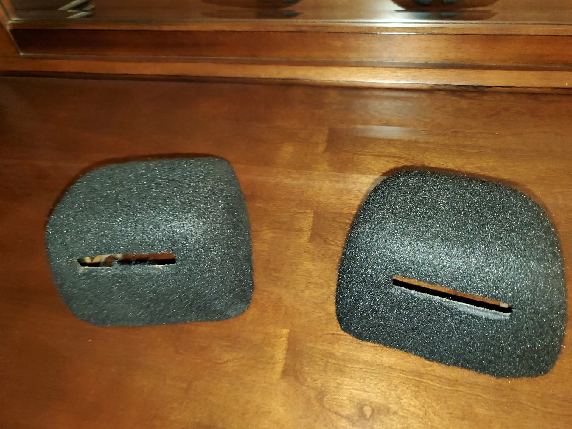

Finally got my rear seat belt covers back from the upholstery shop after nearly four months! Time to start back up on the car again.
And yes, I'm still planning on the Z2363 Crate engine and T-56 swap.

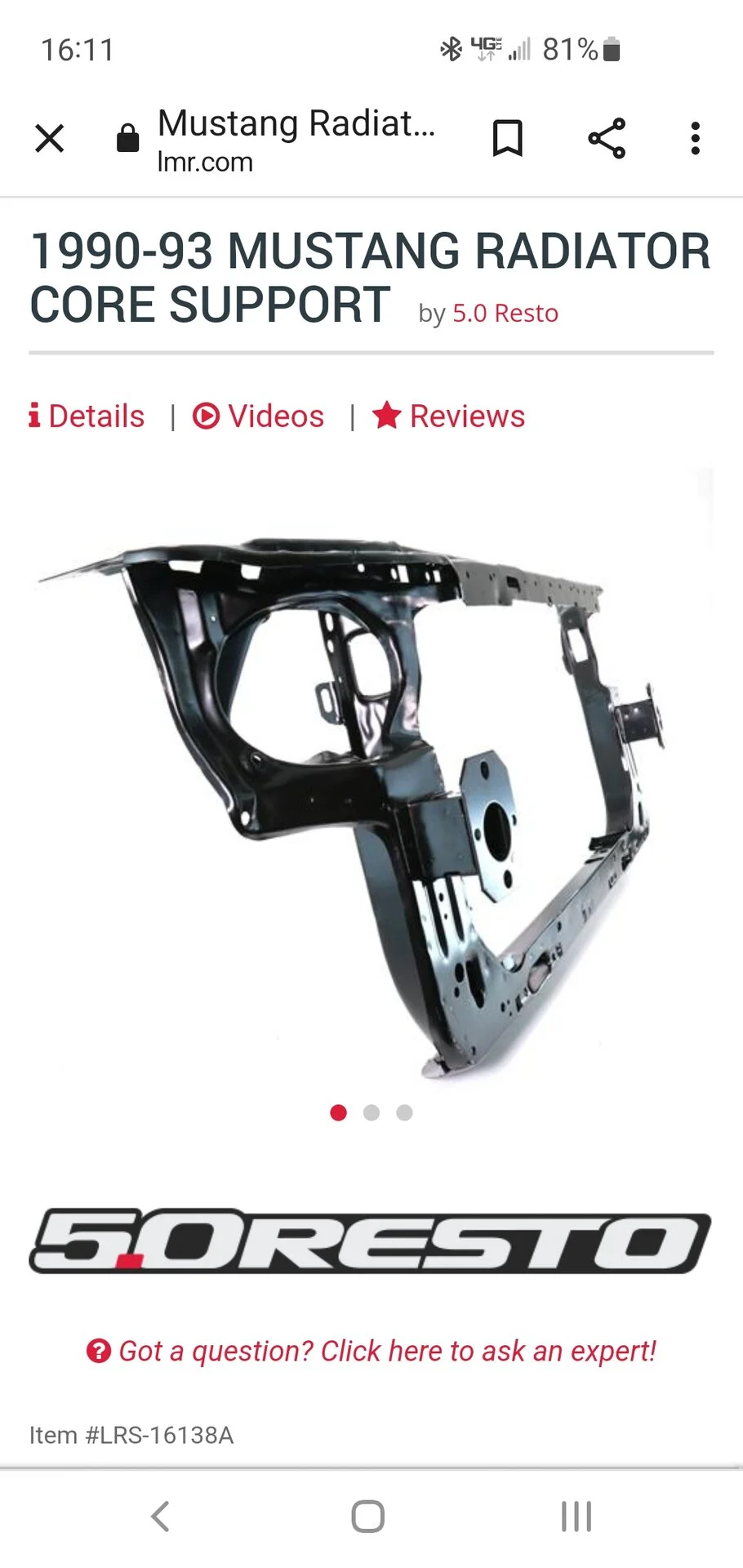

Has anyone replaced their radiator support? LMR says welding is required and I'd prefer to do it myself in my garage. Some yahoo tried to lift this car some time in the past from the radiator support and it appears to basically be a bolton.
