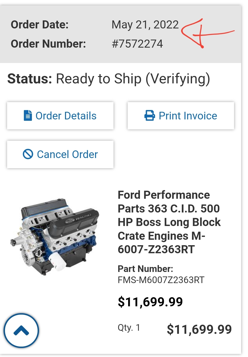

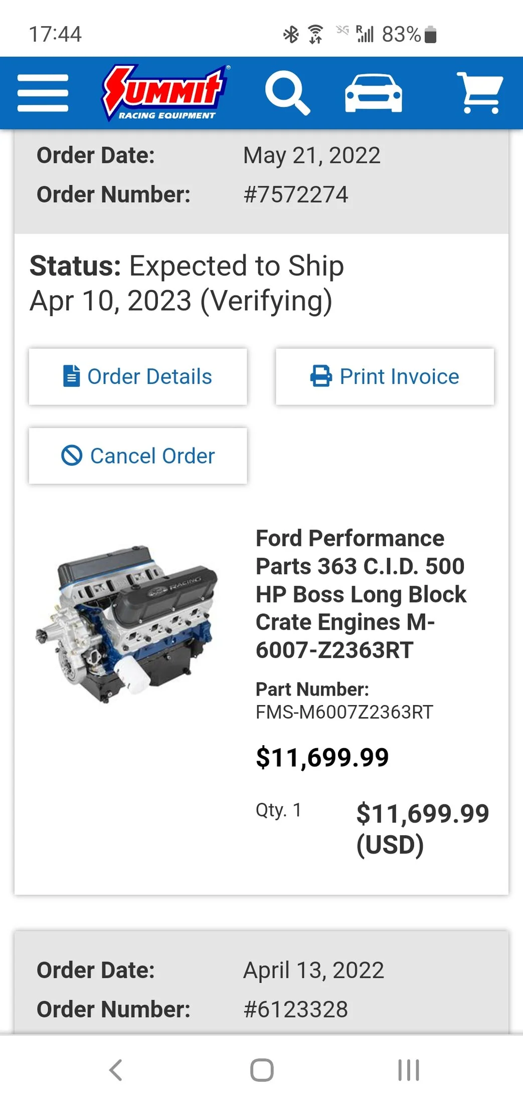

It's been approximately five months since I started purchasing my list of parts for the Z2363/T-56 swap. The Ford Racing engine is delayed until Jan '23 from an initial June '22 delivery. The BBK catted X-pipe is slow as well. Apparently the catalyst fibers are hard to source. And lastly, the JMS MAF extension is estimated to take another six months. Yep, patience is a virtue. Oh, and the engine price went up from $10,499.99 to now $13,300. Damn Putin Price Hike!
