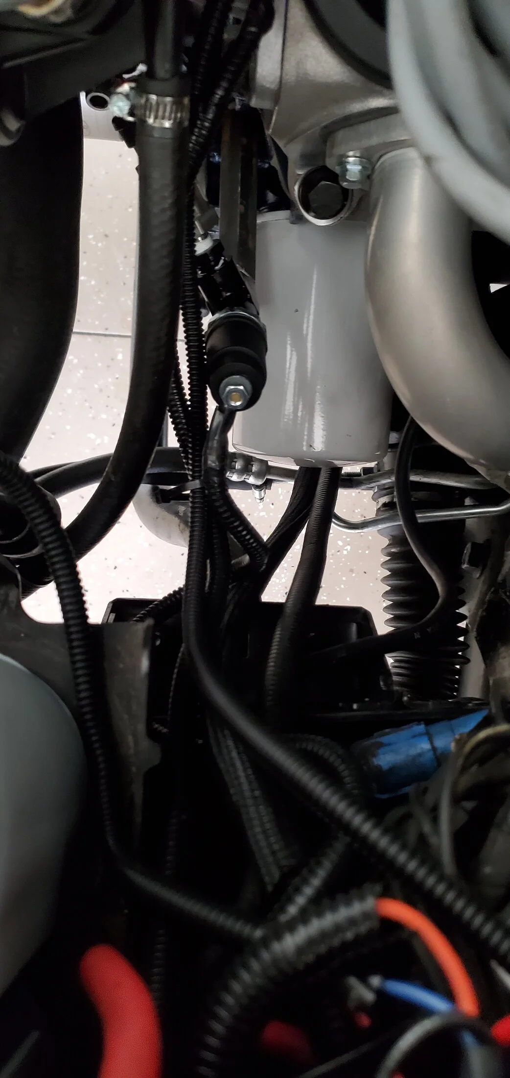

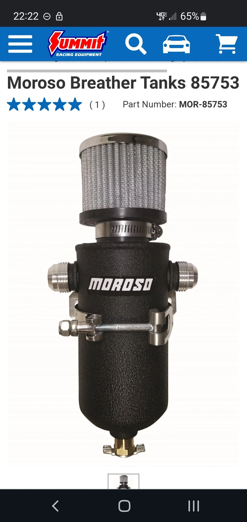

Mounted the oil catch can. Text drive complete and no more spewing oil.
Decided to go with the larger 12 AN fitting equipped Catch Can as I figured the larger fitting would aid in greater breathing. The limiting factor though is really the rubber tubing running from the PCV port to the catch can.

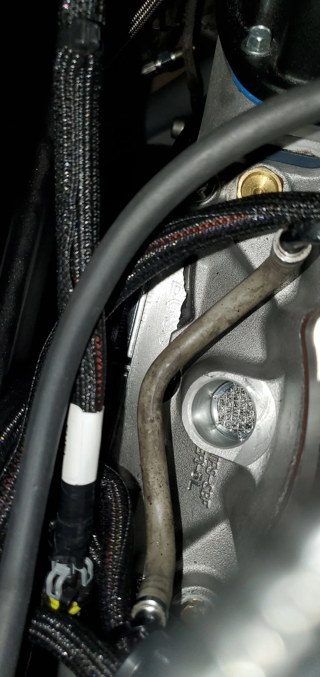

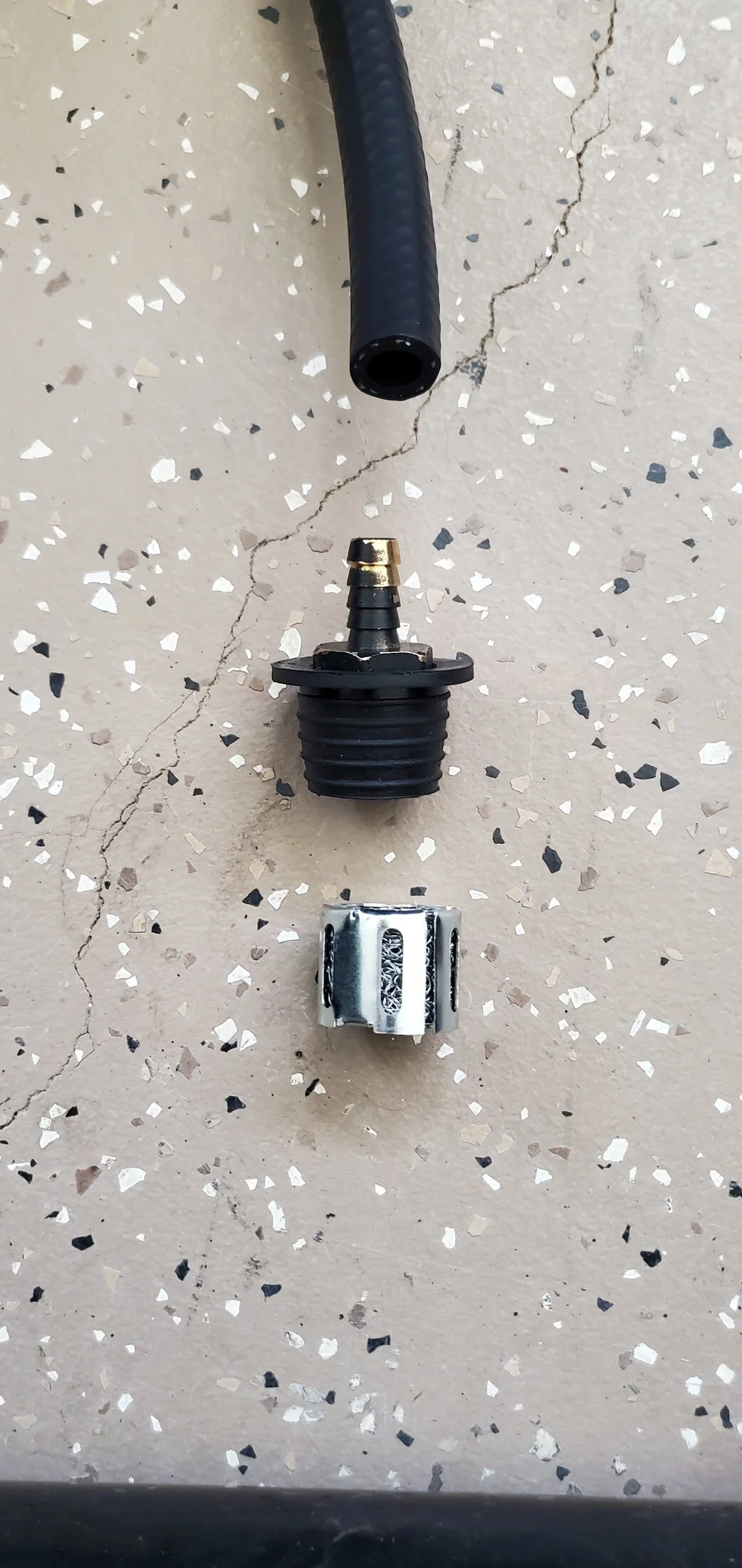

So, in the rear (traditional PCV) port area I added the missing screen, the rubber grommet, a 1/2" to 3/8" brass fitting spray painted black to blend in and then tubing to the catch can. On the passenger's side valve cover I did the same 1/2" to 3/8" brass fitting, rubber grommet to tubing to the other side of oil catch can. 14 AN fittings complete the securing of the rubber tubing and had to be purchased separately as the catch can did not come with them.
The problem I ran into was that I had to utilize a socket to screw in the brass fitting as it was so tight against the rubber grommet and PCV port(s).
I also used Rock Auto to purchase the screen as everywhere else was outrageously expensive. The Moroso Catch Can was purchased from Summit, and the brass fittings from my local hardware store.

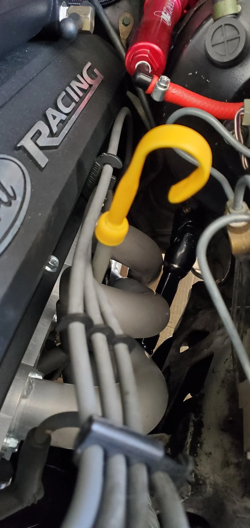

So I figured out the issue causing my new Ford Performance Z2363 engine to barf out oil at high rpm. The dipstick that this engine came with is a universal dipstick. Meaning, its current position is not the correct length to give an accurate 7 quart reading. I learned this after changing the oil this past weekend and checking the oil quantity at both the 6 and then 7 quart level. Both times the dipstick did not indicate any oil in the engine. I called Ford today and was advised the dip stick is universal and the shaft holding the dipstick needs to be trimmed down length wise for this application. I suspect my mechanic continued to add oil until the dipstick indicated full when in reality it was overfilled and likely had 9 or 10 quarts of oil. I asked FRPP to add a line in the instructions as the fault clearly lies with them.

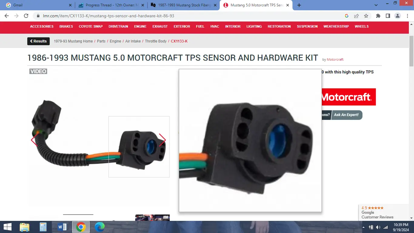

Installed my new stock height HO Fibertrends hood, but the TPS sensor STILL rubs against the underside of the hood. Has anyone attempted to reduce the thickness of the TPS sensor in order to clear their hood? It's simple plastic and I'm considering sanding it down with an orbital sander. This would fix my rubbing issue, but I'm not sure if my Holley Terminator X computer will freak out.
