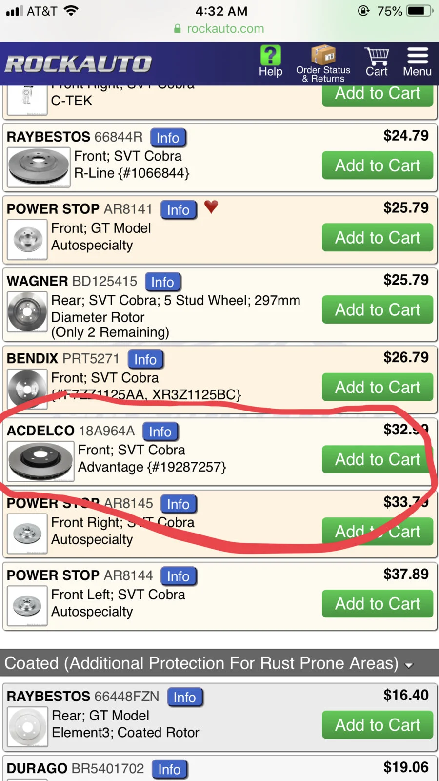

What are these for?

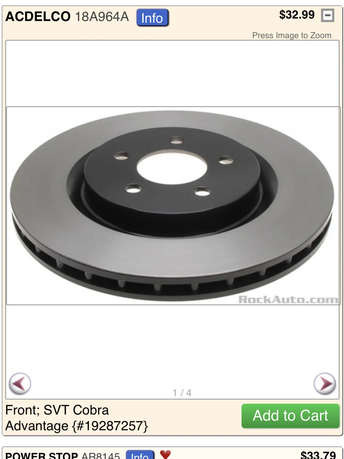

So I received the wrong front rotors from Rock Auto. The fronts are AC Delco 18A964A. While they were linked as '03-'04 Cobra brakes, at 14.5" diameter they clearly are not. I need some help if anyone knows the correct AC Delco part number for front '03-'04 Cobra rotors in 13". Thanks
I'm not sure. If you look at post #53 you'll see the parts list. These rotors are much larger than 13". The hat completely clears the front hub axle studs. I have a return in place and will call Rock Auto, but I'm still hoping someone on here has some insight. I suppose it is possible that some Rock Auto warehouse worker just pulled the wrong rotors although the box is listed as the correct part.
Wouldn't be surprised if someone swapped it out. I've gotten parts from RA that were swapouts.....including a cheap, broken, Chinese hub in a box when I ordered a pair of Timkins (one was correct, and the other was obviously different)

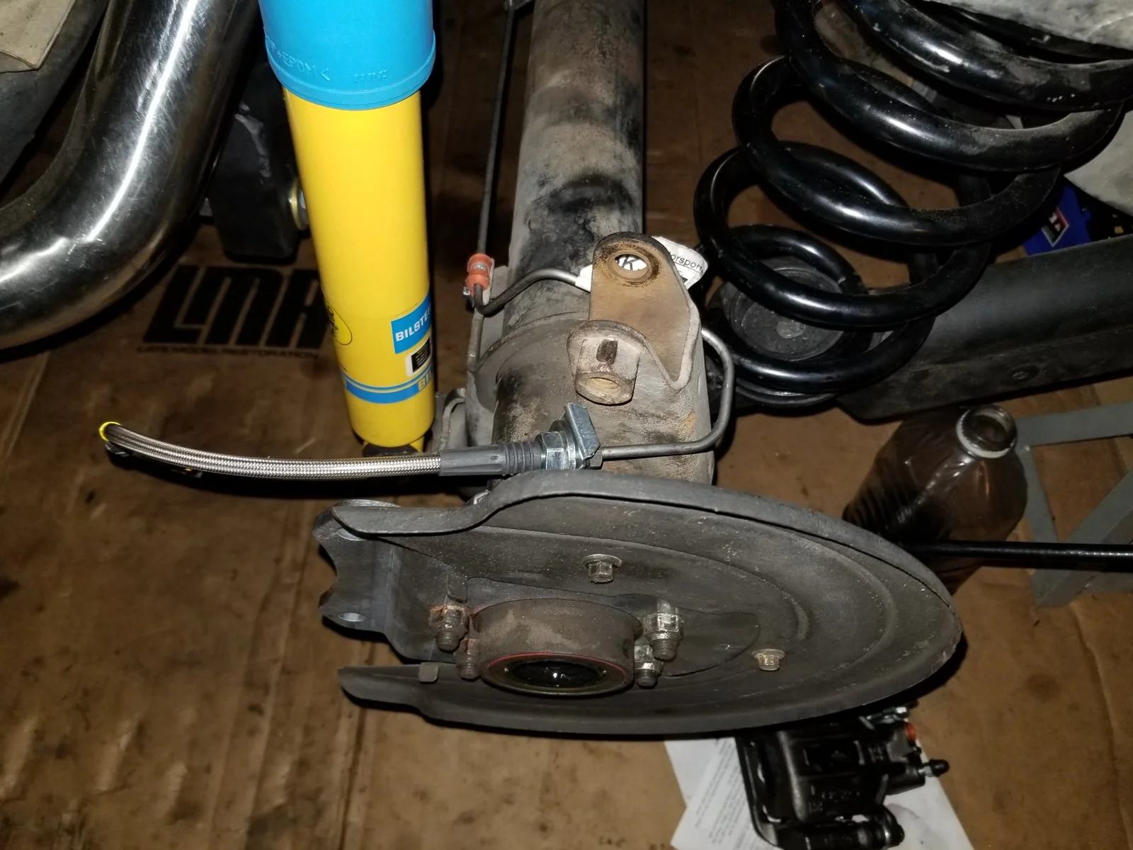

So I just dropped another $100 for two more rotors (AC Delco 18A964A). Hopefully Rock Auto will send me the correct ones rather than ones for a Ford truck (the ones they sent me were very heavy and 14.5"). Meanwhile I built the front and rear calipers last night, reinstalled the newly modded (welded) e-brake and ran the e-brake cables under the car. This project is really about 15 small projects.
Worked on the car a little more last night. Baby step progress. Ground out the front caliper brake line couplers. Further confirmation that my car was a previous 4 cylinder as Ford used different sized attachments for the wheel well caliper originating brake lines.

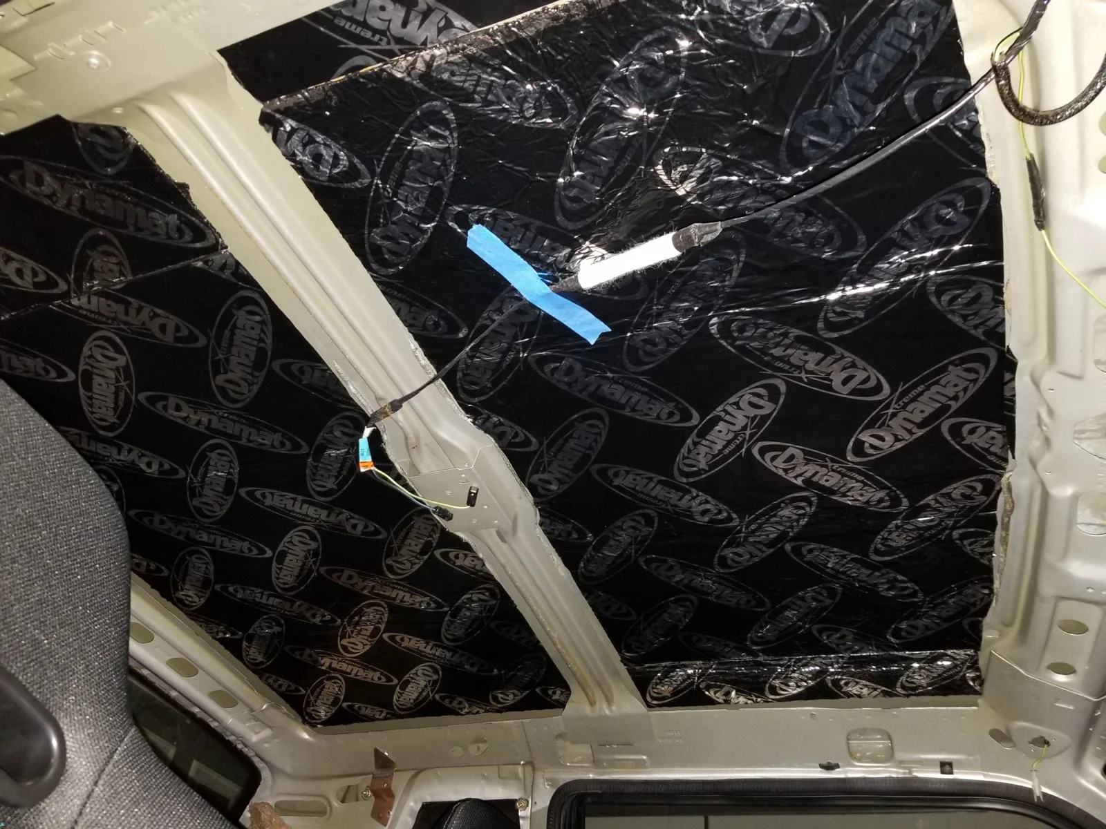

I started on the rear lines, but if you don't get the center point t fitting attachment point right the lines don't line up right. What a headache. I did install some dynomat on the ceiling which made a huge improvement. Easiest mod yet after the front hub installation.

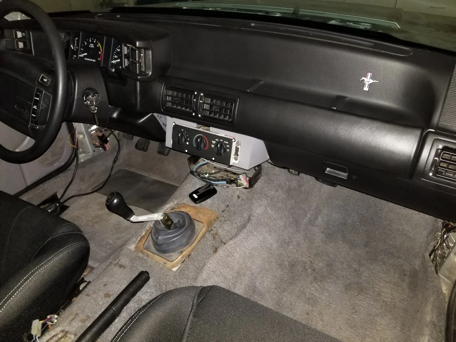

Black dashboard is in. Had to replace the speedometer. One of many bugs I had to chase down/figure out.
I have all the parts save for the black interior door panels and black floor carpet, but I'm going to wait until after the exterior body work and paint is done to reinstall the "new" interior. Of course I'll have to get my rear quarter windows restored as well.
