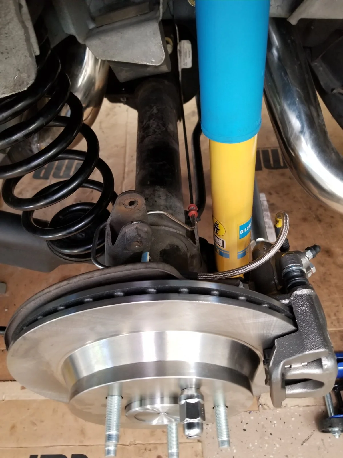

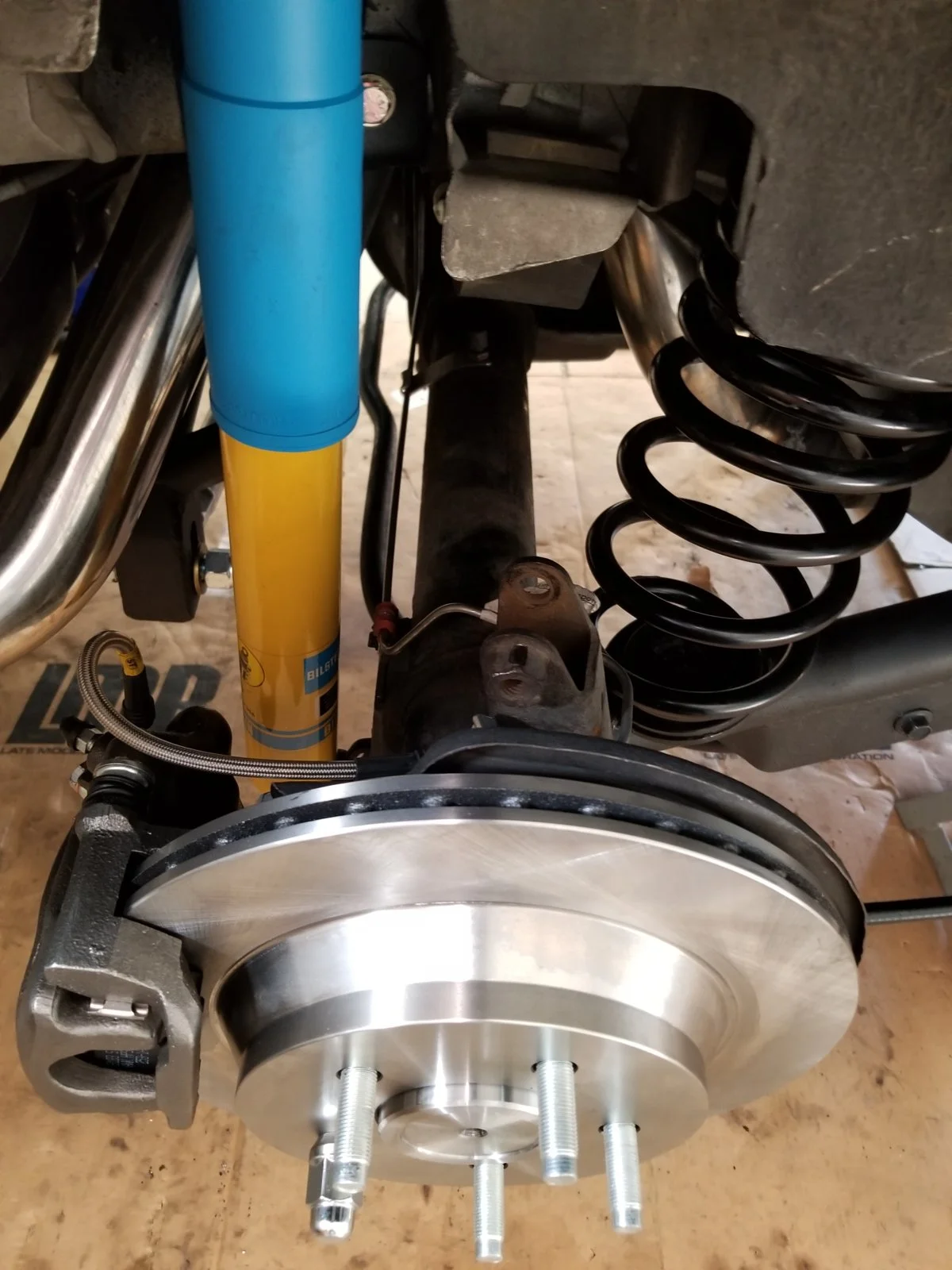

Other than filling the differential fluid with oil and bleeding the rear brakes, the rear is done. I broke a bango bolt tightening to "14 ft lbs" and called Maximum Motorsports with 15 minutes left in the business day. They're mailing me a new set for the front to be delivered on Friday. They rock and have great products. Got an alignment appointment for 4pm on Saturday. The finish line is in sight.

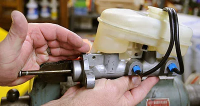

Good insight on the proportioning valve. Thanks. Is the bench bleeding necessary? Or does it just make the overall process easier?
If you are swapping the MC, you need to do it. The MC mounts at an angle and you'll never get all the air out of it unless you can jack the rear end of the car up VERY high to the point the MC is level
You don't even need a vice. I held mine in one hand, used a screwdriver to push the piston and braces the far end against a wall.
For all the work you've done, bleeding is easy. Don't get intimidated by it.
