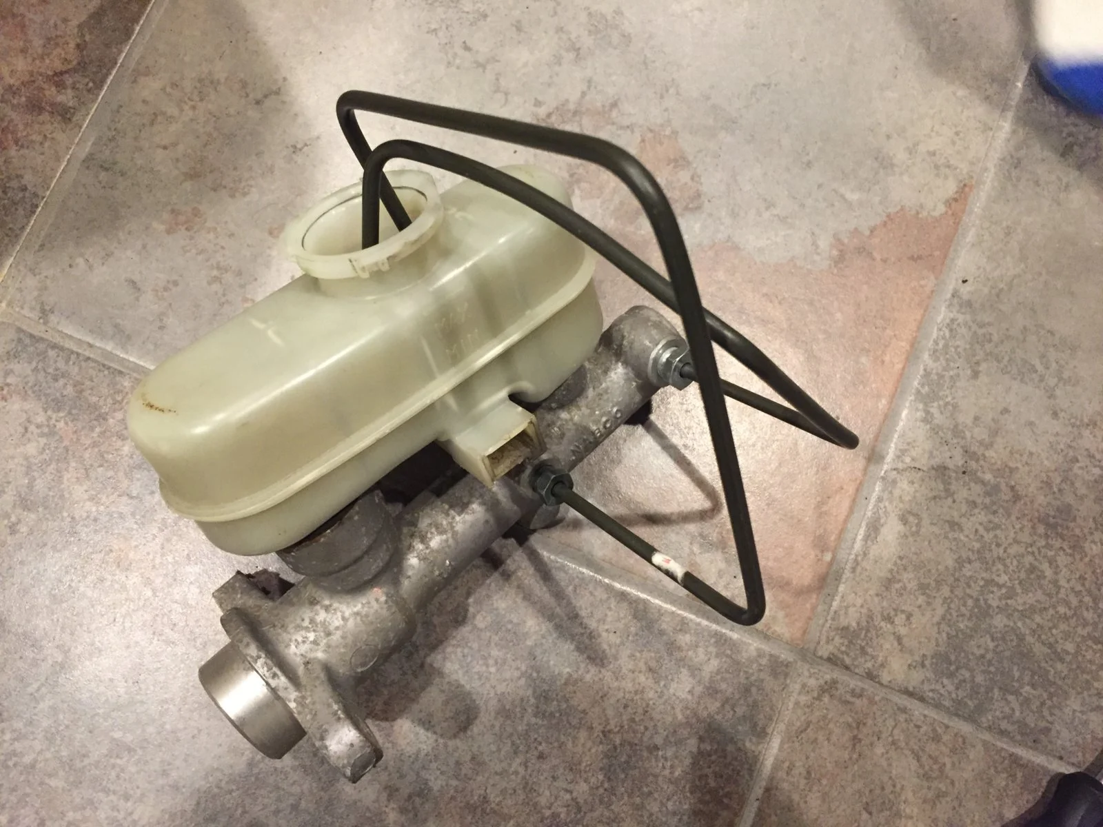

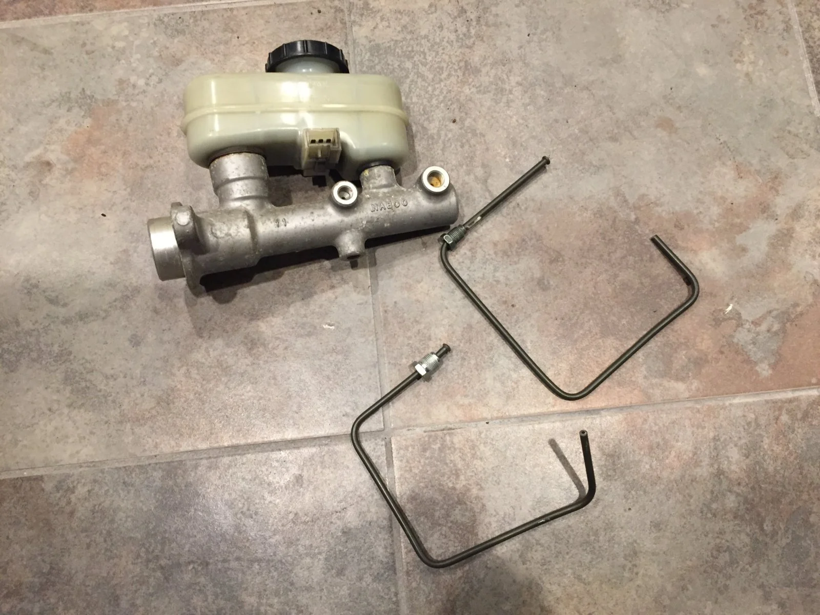

Had these parts readily available. Ignore the fact it's a 3-port MC. Pretend bottom port isn't there

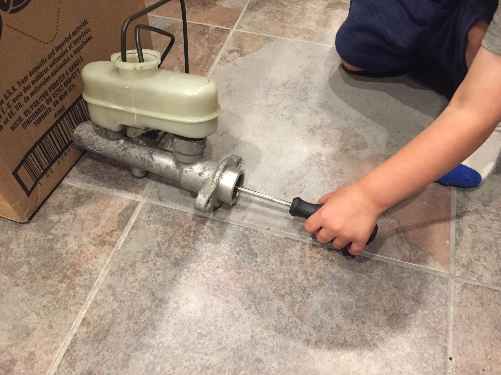

All you need are two lines, m12 and m10 bubble flare fittings. You can use hard or soft tubing but if you don't have a vice the hard tuning is easier.
Set up like so so that the end of the tubing goes into the reservioir. You want the end to expel fluid under the fill line so you don't draw in air.
Hold it level, brace against wall and pump piston with screwdriver under no more air is seen coming from tubes. Should take 5-10 pumps tops
Carefully remove tubes, and install immediately.
  • Useful
Reactions: General karthief
You don't even need a vice. I held mine in one hand, used a screwdriver to push the piston and braces the far end against a wall.
For all the work you've done, bleeding is easy. Don't get intimidated by it.
If I remember tonight I'll snap a pic of my bleeding setup. I might be able to find the fitting sizes too. Just need to pick up some 12" pieces from local parts store
Edit: M12 and M10 ISO bubble flare
I'm not intimidated by the process. It's just that I'm doing my research into this step and questions came up. I'll see if I have the fittings to "palm" bleed it myself. If not I'll have the local shop. Either way it will be completed.
Reactions: Olivethefet

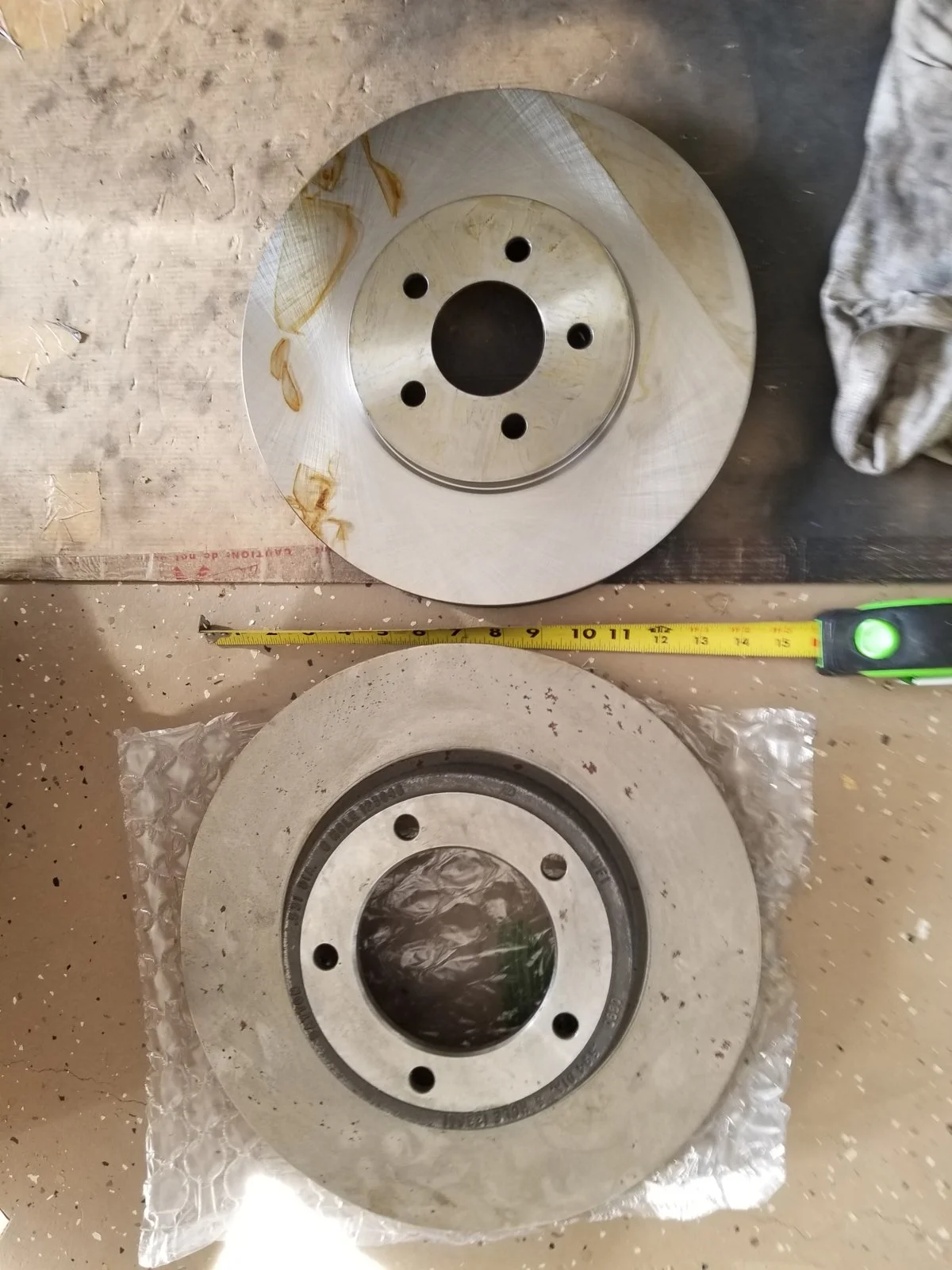

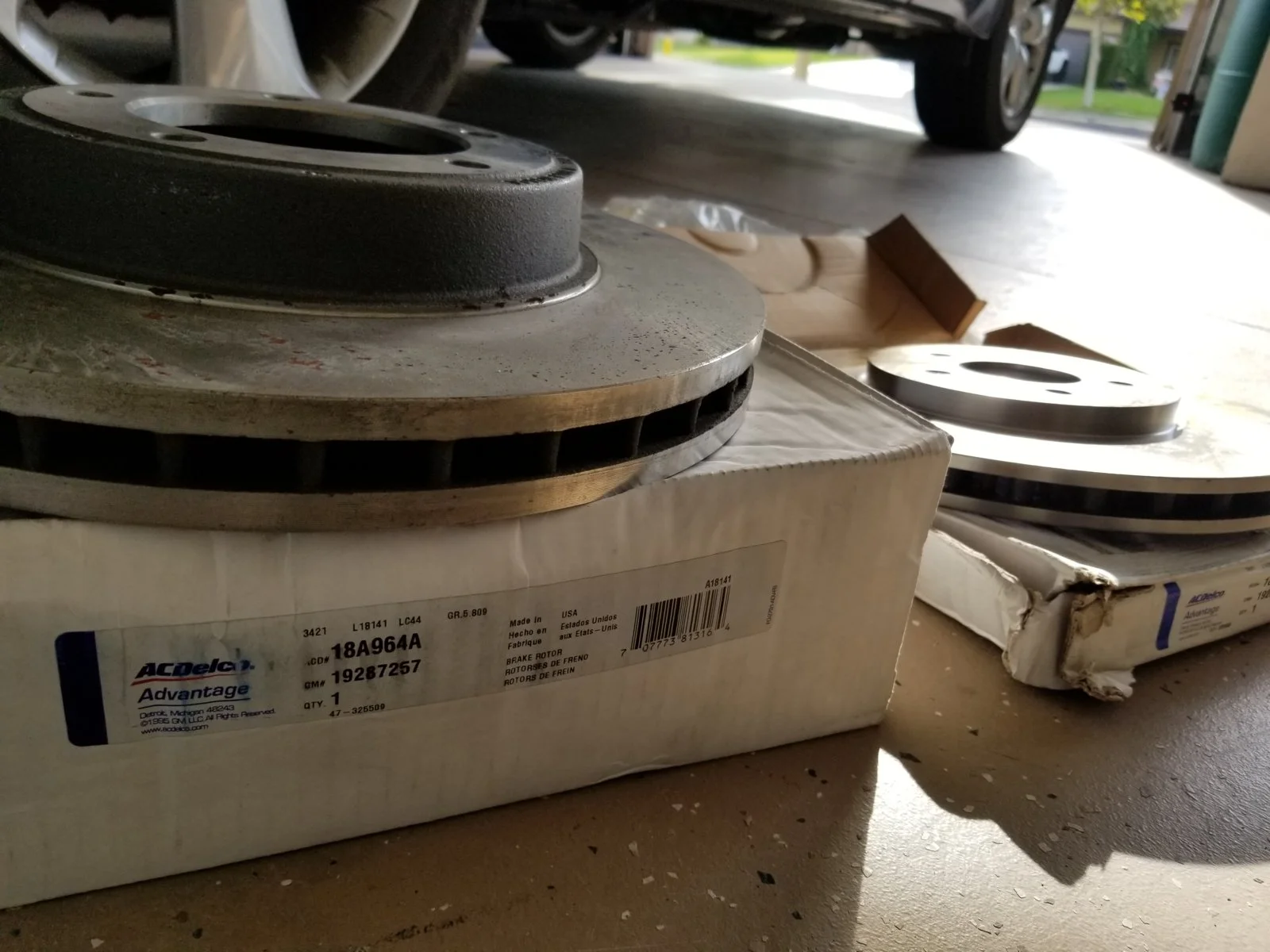

BTW, Rock Auto admitted to me today via email that the part they sent me was wrong and that they'll be reimbursing me the shipping cost. Nice.
That's a good point. I do have an email out to the guy in order to schedule an appointment so I can bring that up. Thanks.
They are stellar . I ordered about 70 plus of the wrong spark plug . They took them all back reimbursed me and i got the right ones
I actually went to a pet store today to buy the plastic tubing needed to bleed my brakes.i find that to be a little comical as no auto parts stores had 1/4" ID clear plastic tubing. Adapt and overcome.
The email I just sent to Rock Auto. Un-believable!

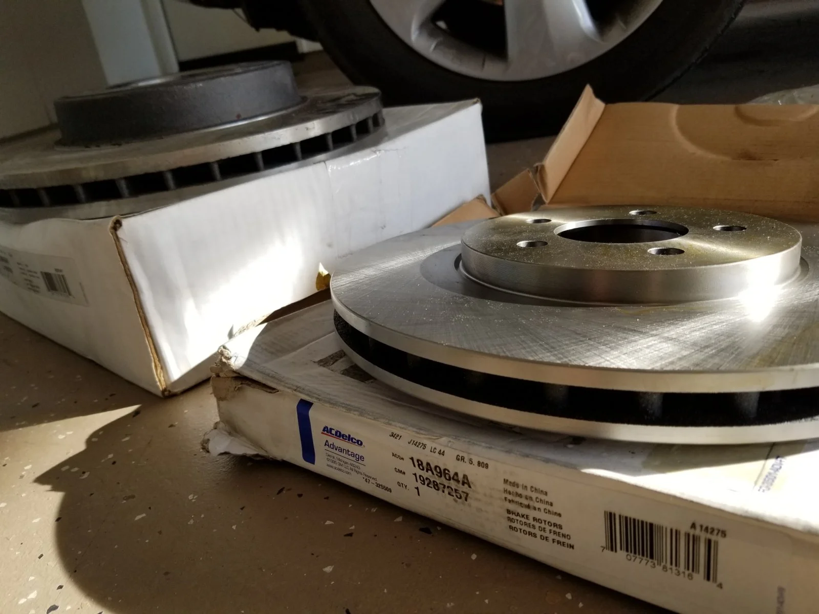

I anxiously arrived home today hoping to finish the front rotor install on my car. I had already confirmed the front door arrival of my two "18A964A" rotors, but was shocked when I opened the box and saw two completely different rotors despite the packing list indicating two "18A964A" rotors. This is now the second time I've received a 14.5" rotor which coincidentally is useless to me as I can't even install it on my car's hub if I wanted to. I now have one correct 13" rotor and one 14.5" which I can't use. I'm requesting that you mail me a single 13" diameter rotor for a 2003 or 2004 Supercharged Cobra (part number 18A964A) as soon as possible (overnight would be preferred). This is my first interaction with Rock Auto and I spent more than $700. I understand mix ups, but why ANYONE would ship two completely different sized rotors with the same part number when they are visibly different from each other and having different weights is beyond me. I've attached photos to confirm my statements.
