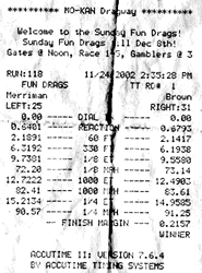

I can't quite make out what your 330ft is on your old slip, but you are definately picking your time up on the big end.
To me it looks like you are blowing the tires on the line. And either not getting out of it, or getting out of it too much and bogging. It all seems to be in the first half of the track.
I would love to see a video of your launch or see it in person. It's so strange to me that our cars could be that different. There aren't many AODE 94-95s where I live. :( Some guys think my car hooks because the timing is set so low that it's not making much power. But I can hit the juice from 2 feet off the line without much problems at all. :shrug:
Another question: Are you manual shifting to get the extra out of your intake? I push mine an extra 400rpm above where it shifts on it's own to get another tenth or two out of a run.
Here's one of my similar timeslips. Someone jump in here and do a comparison.
