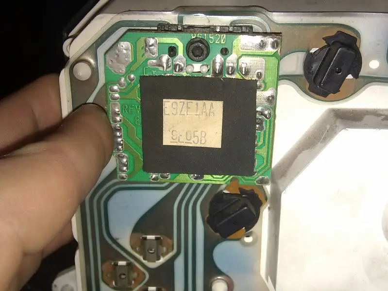

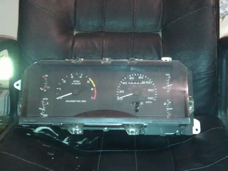

Hey all,

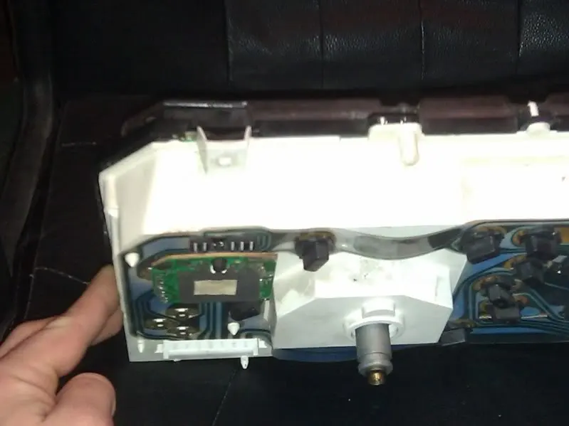

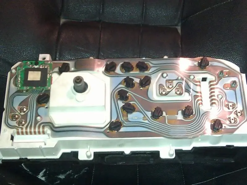

Just picked up an 89' 140mph Instrument Panel and all of it looks the same as my 88' (85mph IP) except for this weird chip located on the back of the IP.
I included pics and luckily enough the chip still has a PN on it.
(E9ZF1AA-9F05B)
Something in me wants to say, "slosh" chip thing for the gas and another part says, "don't guess just go post and ask..."
So here are the pics....pretty clean, i'm going to take off the cover and use the Latemo cover i got and replace the bulbs with my superbrightled.com wedge bulbs. Things make all the difference at night.
Anybody got any ideas? Thanks
That is the anti-slosh module for the fuel gage. It keeps the fuel quantity indicator from jumping around when you drive on bumpy roads.
