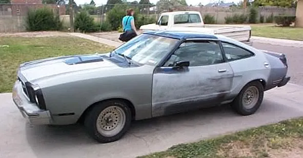

A couple of pics to show you my IIs stance... It's pretty low in the front. The saddle height on my floor jack, when all the way down, is 3.75 inches and I usually have to lift by the bumper with my shoulder a bit to get the jack under the main crossmember. So yeah... It's low.... probably a little too low. :rolleyes:

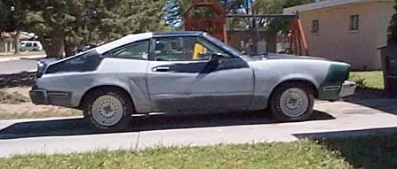

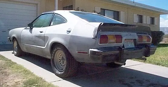

Here's some pics of my '78 Cobra II I had years ago in New Mexico. It's got 14x6 Roadrunners all around with P195/6014s on the front and P235/6014s on the rear.
Oh and if anybody asks, Yes both those exhaust pipes are functional and no I didn't remove or modify the fuel tank or anything else of the car to get 'em there. :) Just had a REALLY good exhaust guy.... (1 7/8 pipes ... V6 car)
