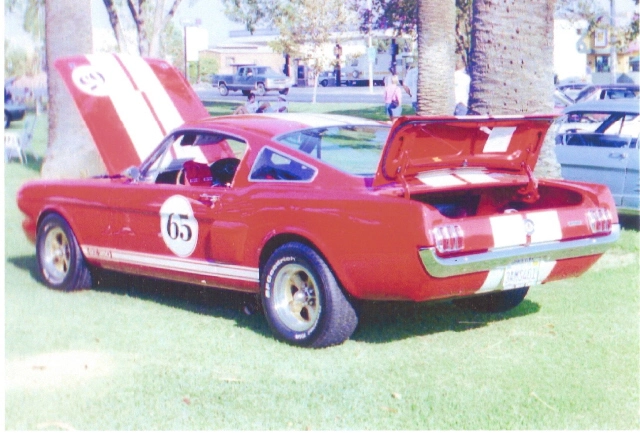

4 1/2 rear leaf with 1 inch shelby drop in the front 600 # springs the wheels were an origional set of 7 inch torque thrust d . the wheel lips were rolled and the sharp edge along the bottom of the wheel tub was slightly rolled away from the tire. never hit front or rear.65-66 is fairly narrow in the rear wheel tub not sure if 8 inch wheel will clear,4.5 back space may be very close to the leafs .have you tried a wheel by its selfe
just to see what you have for clearance? a tire with a more rounded outer edge like the B.F.G.s i had will help a little

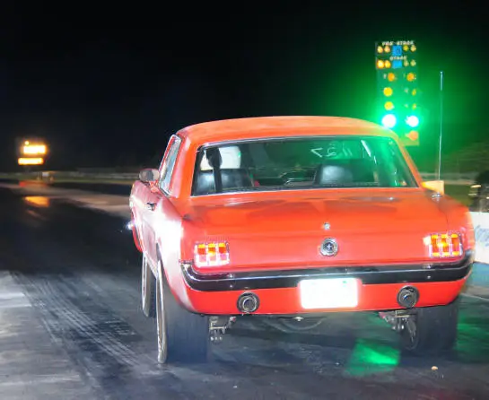

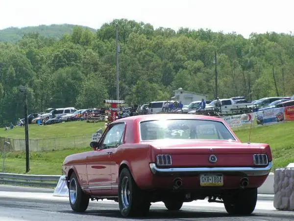

An 8" with 4.5" backspace on a 15" rim will clear the leaf springs. I used a set on my car before the mini tub with zero issues with the springs or inner wheel well. The drag slicks that were mounted to them were 26" tall and 10" wide and the rim was 15". Sectional width is supposed to be 11.2. Its the overall cross sectional width of the tires that can cause an issue--mostly at the quarterpanel with these rims. My quarter panel was "stretched" out 3/4" with a hydraulic jack and the wheel lips were rolled some 30+ years ago when I first did the body work.
The following photos show the car with the 8", 4.5bs rims and the 10" tread tires:
Look closely and you can see the clearance with the leafs:
