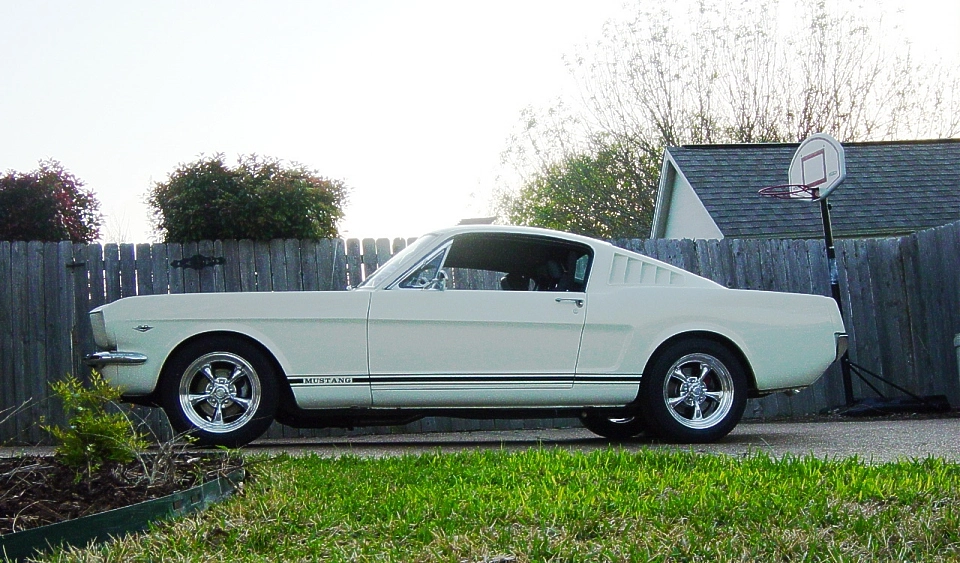

Hey, I am about to purchase some tires and wheels, but after researching many wheels I've changed my mind about getting 15 inch wheels and I'm leaning towards 16's. Will 16X7 225/50 fit on a stock 66, except 620 springs, without rolling fenders. And if they will fit, which backspacing would be best. Also, if anyone is running this setup could you please post a pic.

For a '65-'66 you want 4.5" backspacing on a 16" X 8" wheel. If you go to a 17" X 8" wheel you can go to 4.75" backspacing.
The general consensus here is:
16" X 8" wheel with 4.5" backspace; 225/50/16's on all four corners
17" X 8" wheel with 4.75" backspace; 225/45/17 front and 245/45/17 rear
You may have to do some minor grinding or rolling of the fender wheel well lips, but not much.

These are 16x7 TTIIs, 4.00" BS, with 215/55-16 Toyo Proxis tires. Fit great...

Here is the 17x8 TT II's w/ 4.75 b/s, 225/45 front and 255/40 rear..
