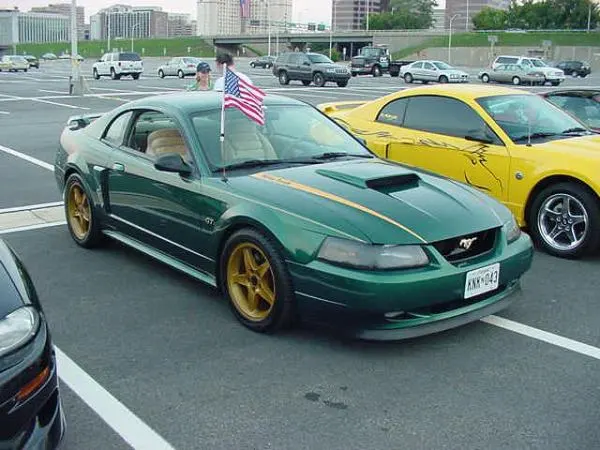

17'' fronts/18'' rears come in
17X9 up front with 265/40 tires and 18X9 in back with 285/40 tires.
