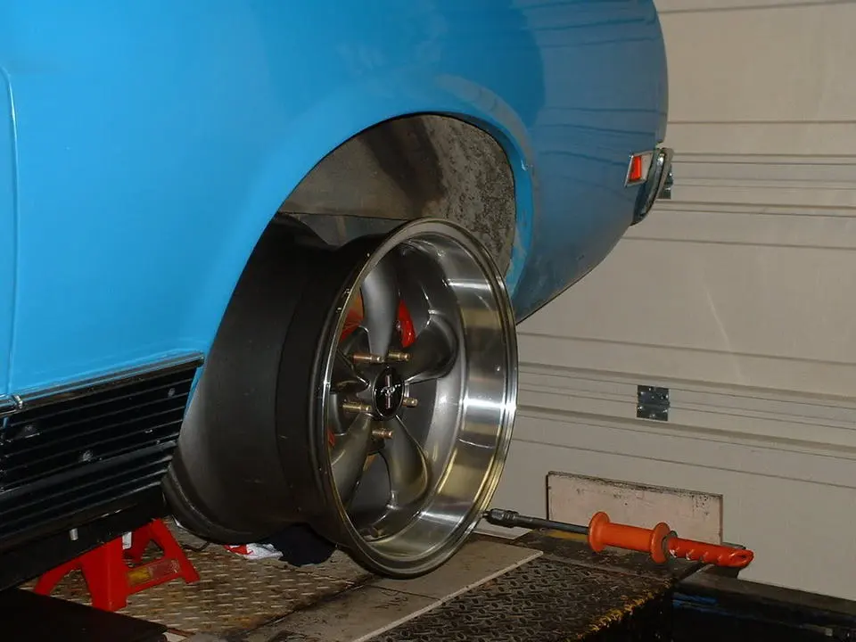

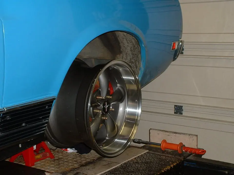

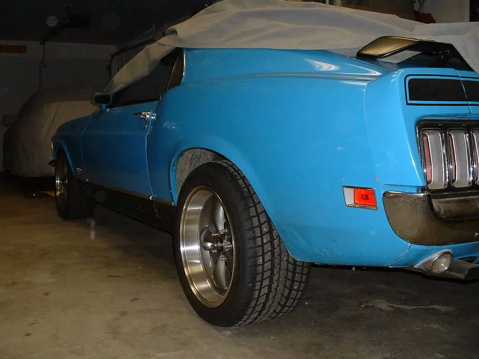

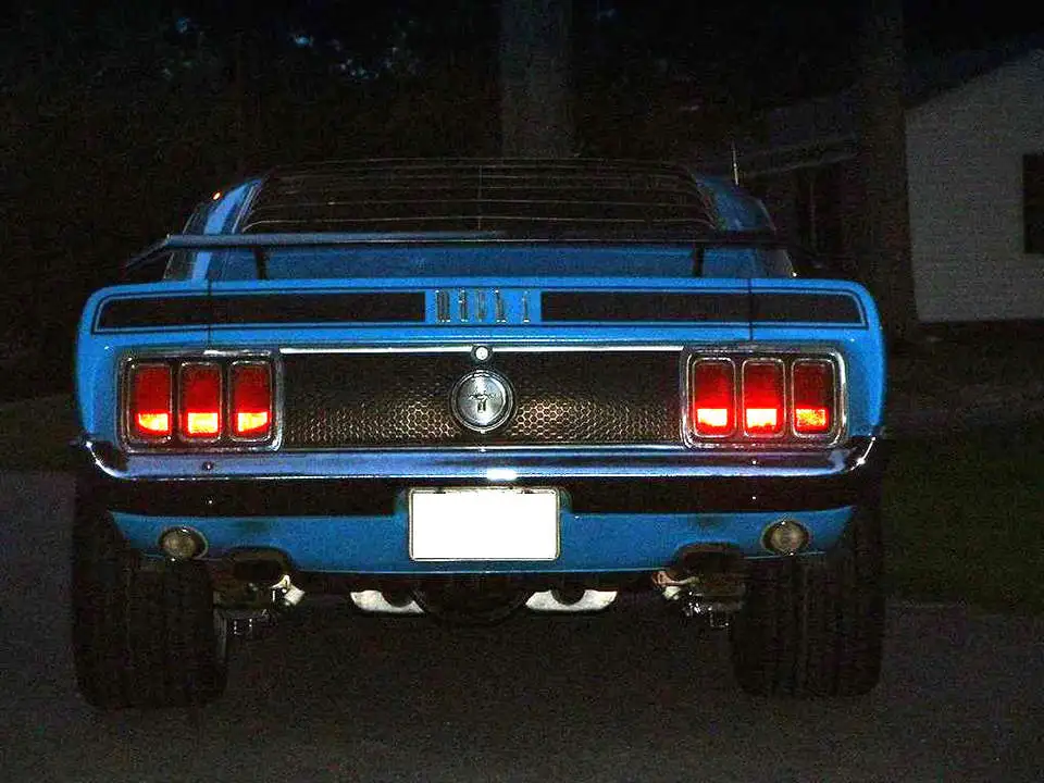

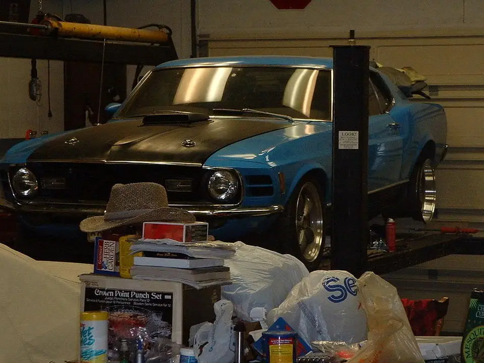

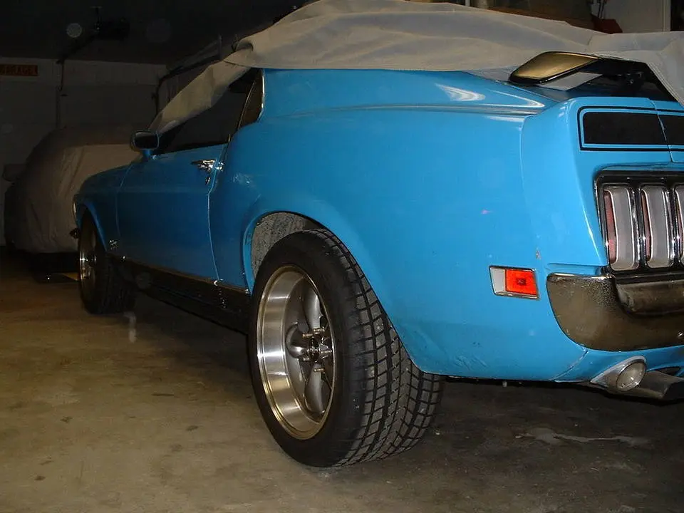

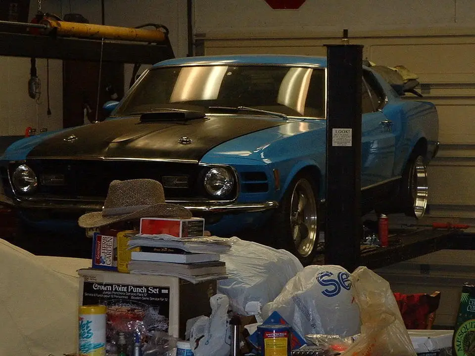

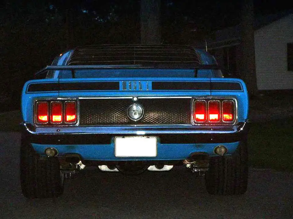

I'm running 17x10.5 in the rear of my 70 with this setup.

Grabber70Mach - that setup looks awesome! :nice:
Can you give details on backspacing and tire size please?
Thanks, here's the specs
Front: 17"X8", 5.72"BS, +30mm offset, 245/45/17 Sumitomo tires
Rear: 17"x10.5", 6.8" BS, +28mm offset, 315/35/17 Sumitomo tires
I'm using brakes off an 03/04 Cobra, these use the kit from Vintage Venom to adapt them to the car. It uses a 1" front and 7/16" rear hubcentric spacers.
Let me know if you want any other info.

Thanks for the pictures and the info!!! Your car looks badass man. Why do your lugs stick out so far on the rear? Your set-up is also what I want to do on my 67 fastback but I don't think I could pull off the 10.5's in the rear like on your Mach. I would however like to do an 8inch. in the front with a 245 tire and a 9 inch in the rear with a 285 tire.

Thanks. The studs in the rear are what comes with the kit. You can cut them shorter if you would like to, I just liked the look of them sticking out. Kinda gives it a Trans-Am look. That setup would look good on your car, good luck with it. :nice:
