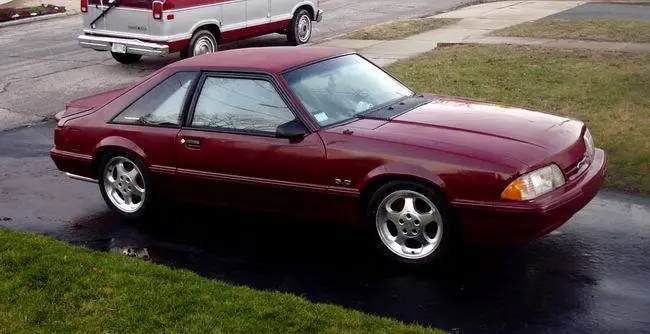

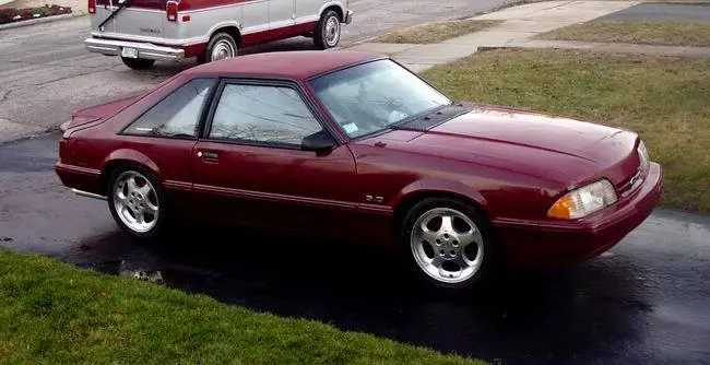

my P.O.S. is lowered , and even with spacers now, and no problems :)
