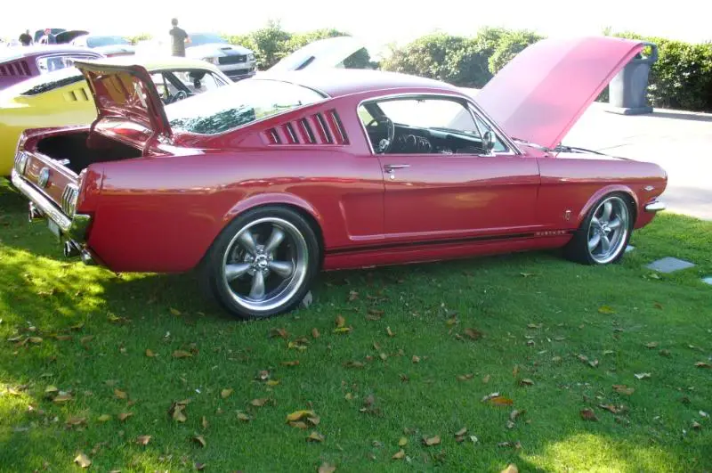

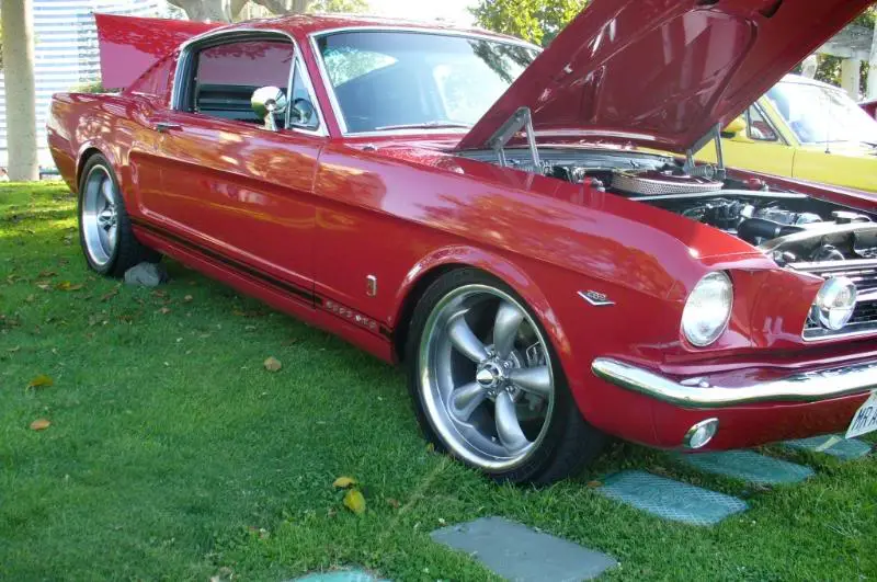

i have a 66 fastback !! i did buy the plates from mustang steve . gona end up being a lot cheaper goin with big brakes this way
car looks awsome !! i have looked at those wheels and like them !! what size wheels & tires and brakes did you set it up with ?
Thats not my car. I was just trying to prove a point that most people will NOT like bigger wheels nor can they tell what size they are.I have had my 17's for about 18 years and would go to 18's, but its not on my to do list right now.
As far as i know, the car had cobra brakes and the wheels are 18X7 and 18X8.
It's pretty easy to spot an 18" wheel on a '65-'66 Mustang. They look like 20"s because of the proportions of the car. 17"s can look like 16" or 18" depending on the stance of the car, backspacing, sidewall height, etc...
