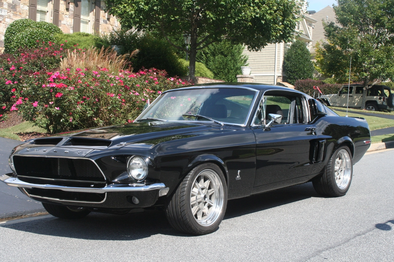

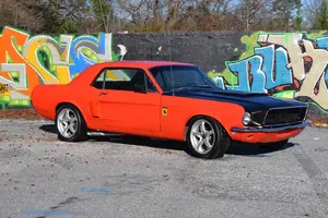

This is 17 rear 16 front. I dont think I'd want 18's myself.
thats a nice stance,looks great. i agree with you ,17s would be the max for me as well. i kind of like to see some tire. the taller the rim the less tire. there is a crown vic runs around my area,must have 20s on it . it reminds me of a coverd waggon.the wheels are so big they look like waggon wheels ,or one of those antique big front wheel bikes. also the less the side wall the harsher the ride.

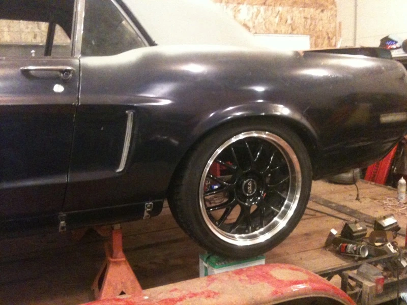

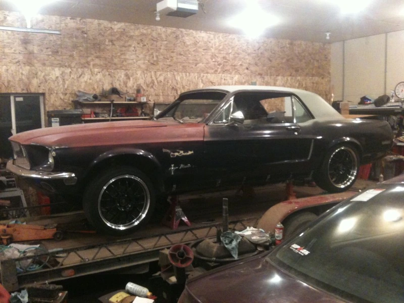

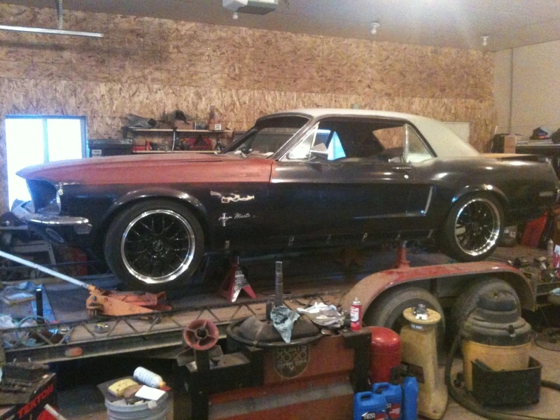

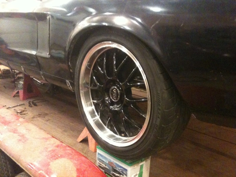

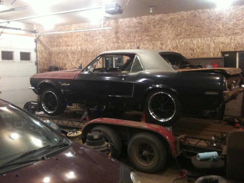

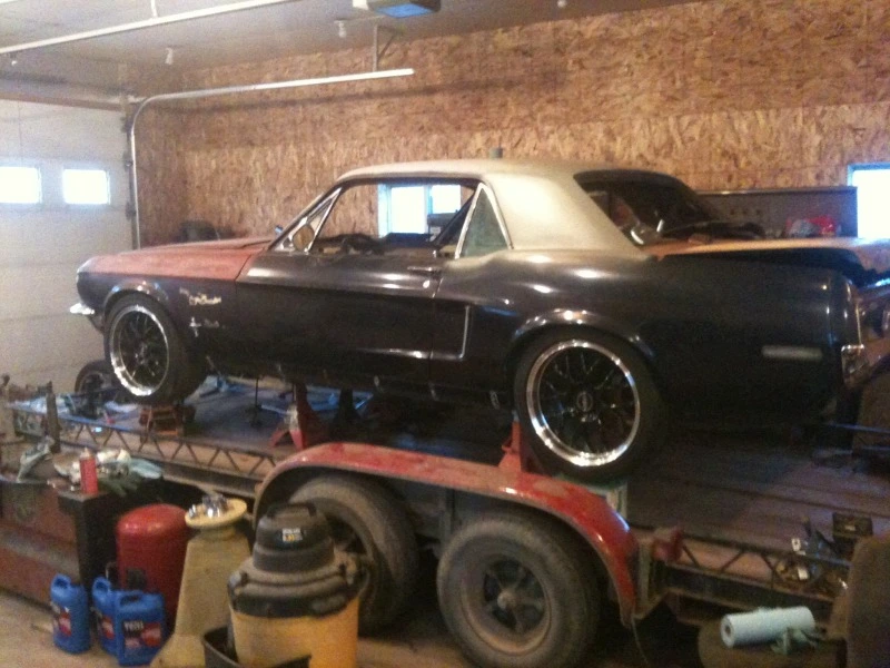

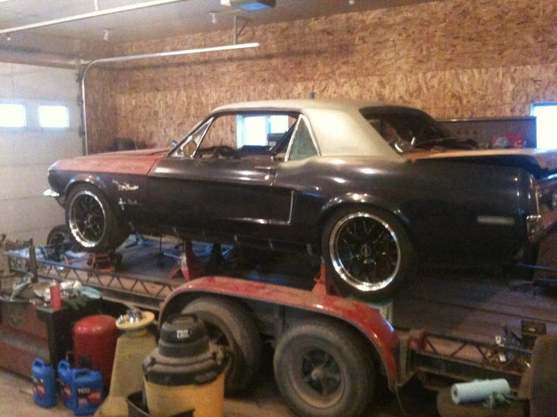

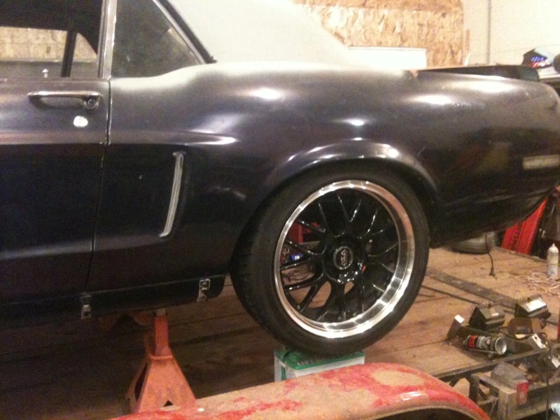

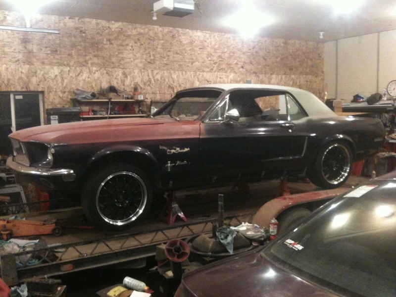

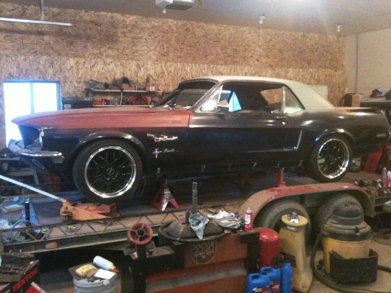

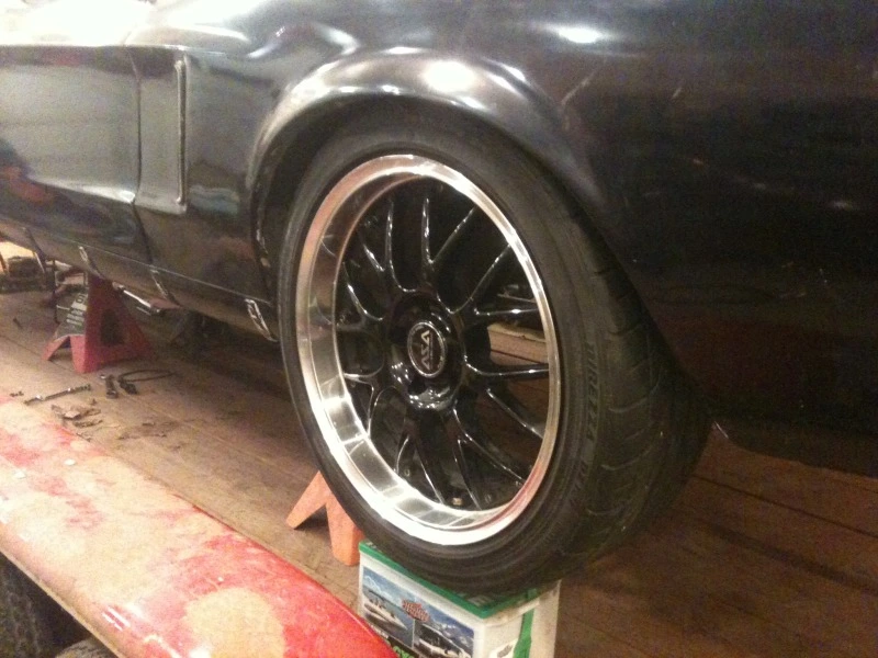

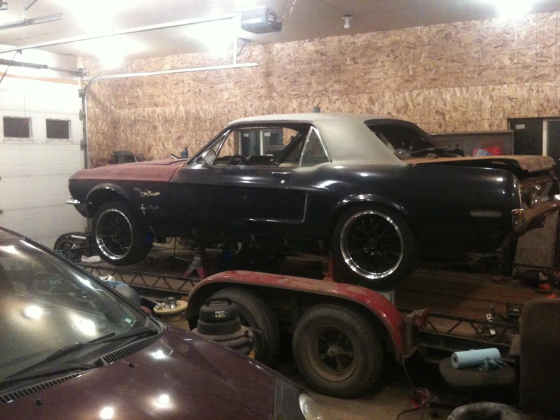

I'm firmly in the "17's are just right, anything else is too big" crowd, but I got offered a set of 18" ASA Revolution rims with tires for a price I absolutely couldn't pass up. I'm going to try them on my '68 Coupe, and if I can pull off the look, I'll keep them, if not, I can resell them easily. I'll try and post a couple pics if I can get them mounted this weekend.
Here are a couple mock up pics, 18" ASA Revolutions with 225/45R18's. I really wish I had the rear axle installed and the car on the ground so the front wheel wasn't hanging down. I think the car pulls off the look quite nicely, I was worried that they would look too big. I don't know if that's as far as I'd lower the car, but we will see.
