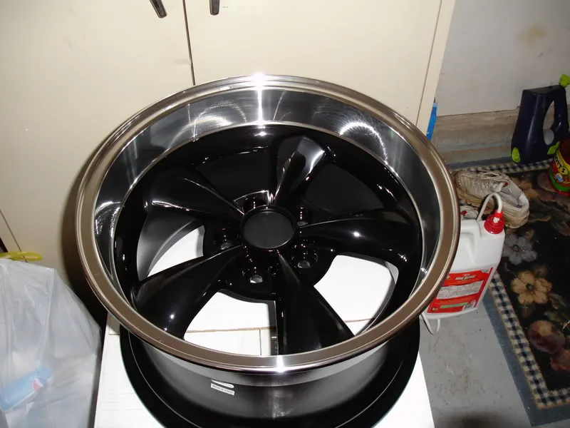

To all you guys that have 17 by 10.5 in rims what tires and tire sizes are you running. I am looking at getting some DD rims soon and dont want to run somitos or drag radials. and I am wundering if i can run something smaller then 315s. thanks

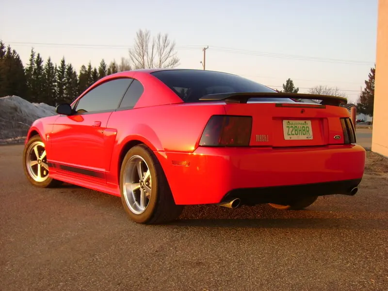

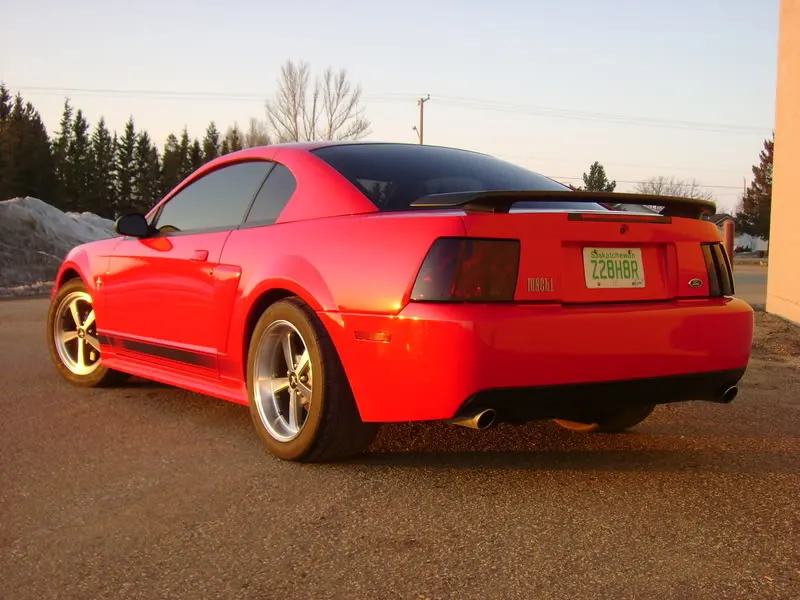

heres mine with 315 nitto drags. they fit just fine.

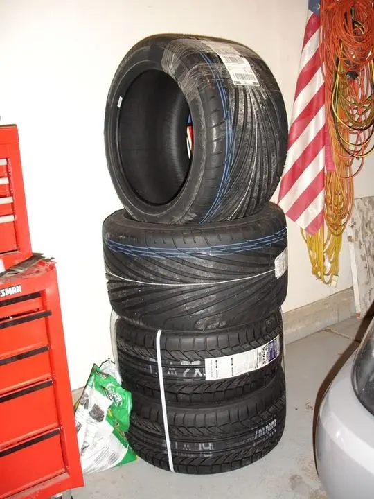

I run both my cars all summer on drag radials with no issues. the bfg's hook a bit harder but the nittos last longer and have better street manners.......if you cared to know LOL. I ususally get 2 summers out of a set btw

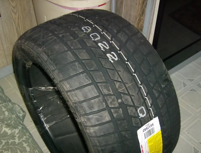

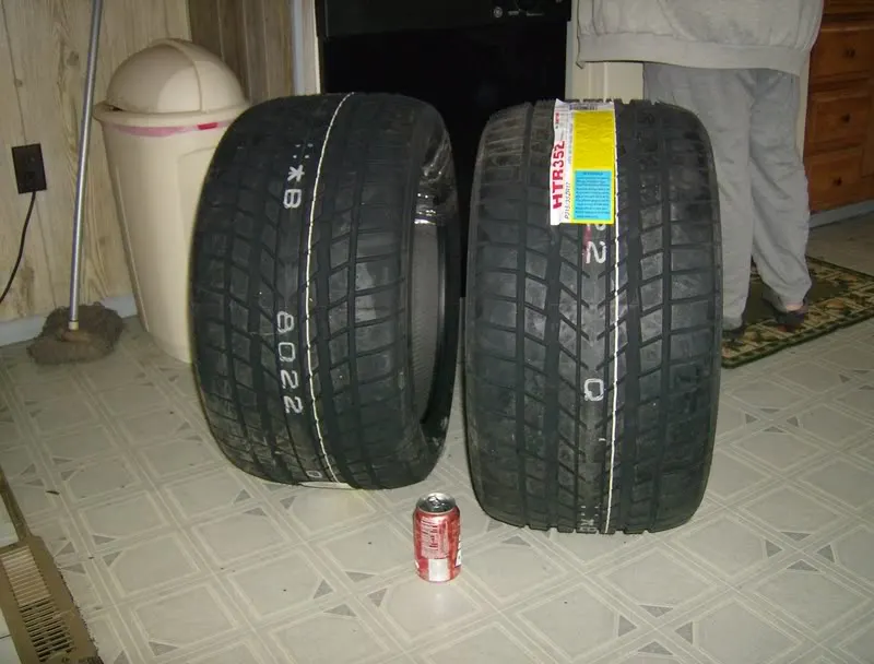

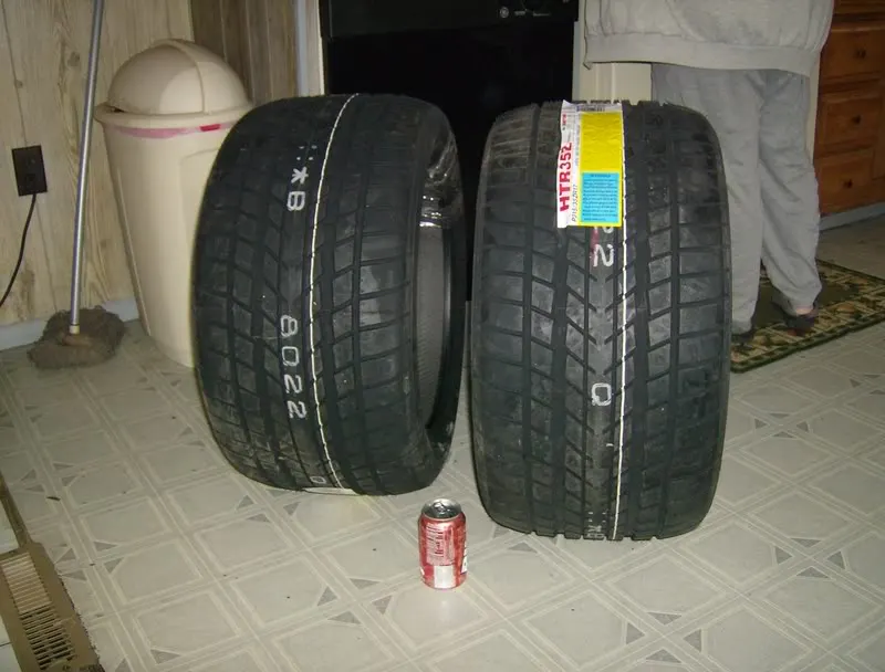

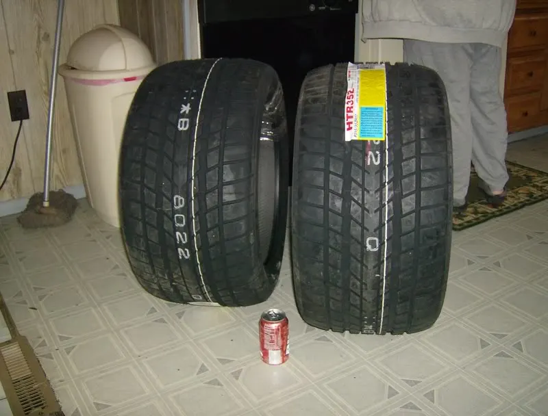

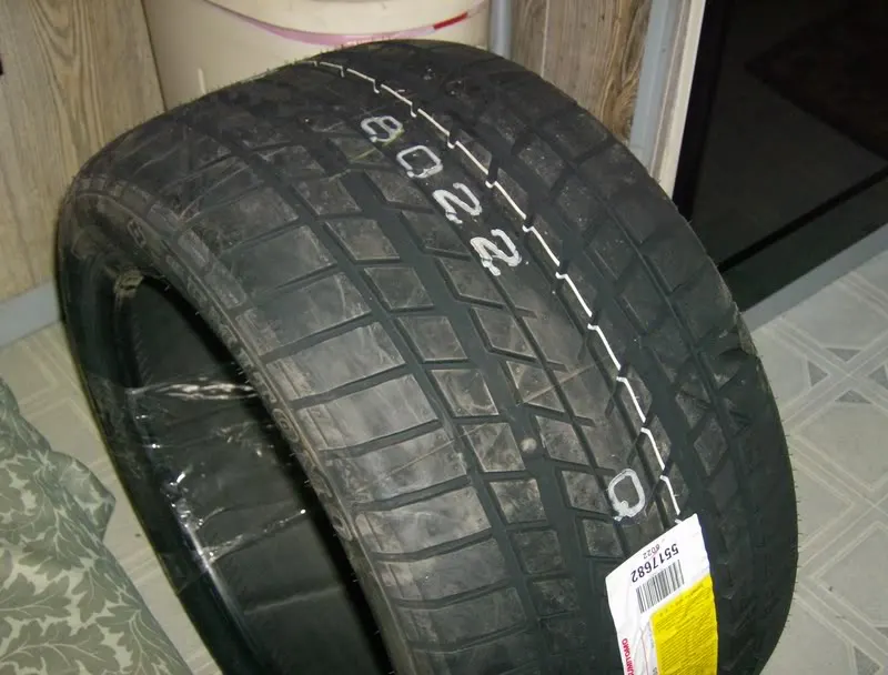

I had a set of those on my car for 2 weeks. I took them off and sold them. The have the biggest thread gaps I ever seen. Hooked for poop and had poor handling. Ok for just cruising. The smaller sizes are better though because the have smaller thread gaps with the same pattern.
The Nitto NT555 "Not a DR" P285/40 ZR17 specification for rim size width is 9.0 - 11.0 inches and 10.0 being the perferred size, but they will fit on a 10.5 inch rim.
I happen to have 2 of these tire's with about 5K on them. PM me if your interested, I will let them go cheap.

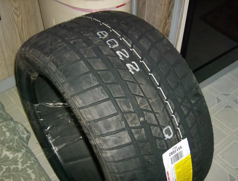

Yeah, they are not the best tire out there but they do the job ok for my car. Ive never had any extraordinary tires on either one of my vehicles (beside mud terrains on my Cherokee) because I go through them too fast. My biggest complaint is the tread wears fast. I had just as many burnouts on the 245/45/17 Federals with the stock wheels and they still are on the car (front tires), but these Sumitumo's shed tread like its cool.
