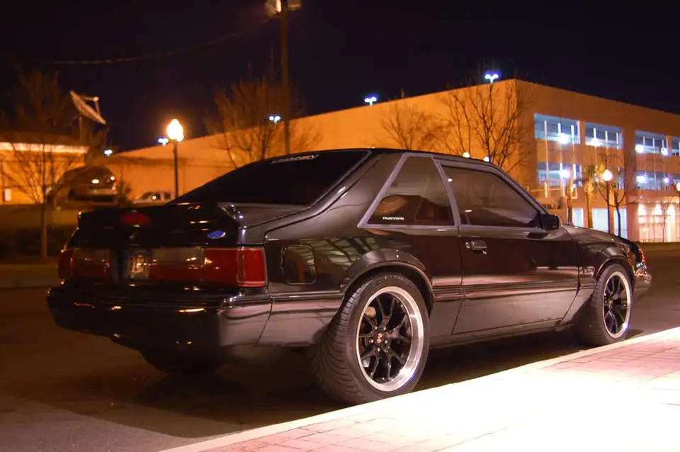

Looks at Novi's car. Black notch 17X10.5 DD FR500's with a 275-40 M/T. Looks perfect!!!! Not stretched at all.
Fox length axles are a must. They sit right to the ege of the quarter, so rolling the lips with H&R springs is a must. I would think it's a must anyways.
its a tough line to walk, and solid info is hard to find. you can maybe keep your tail pipes. but inner fenders and fender lips are gonna be a must. unless you want like 4" of fender gap. some cars look great with the 10.5s, but most ive seen dont look right or natural. 285 is alittle small too.

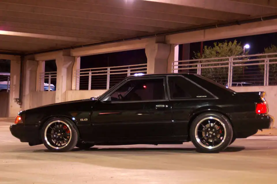

i dont want to pic whore... but i will anyway. can always run an 18x10.
http://s176.photobucket.com/albums/w174/ClemsonStang/mustang/
