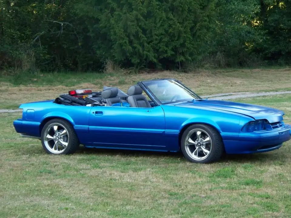

I have 17's in front and have problem hitting a arm 18 in rear no problem with clearance nor did i bash the inner fender in. Here is a pic
