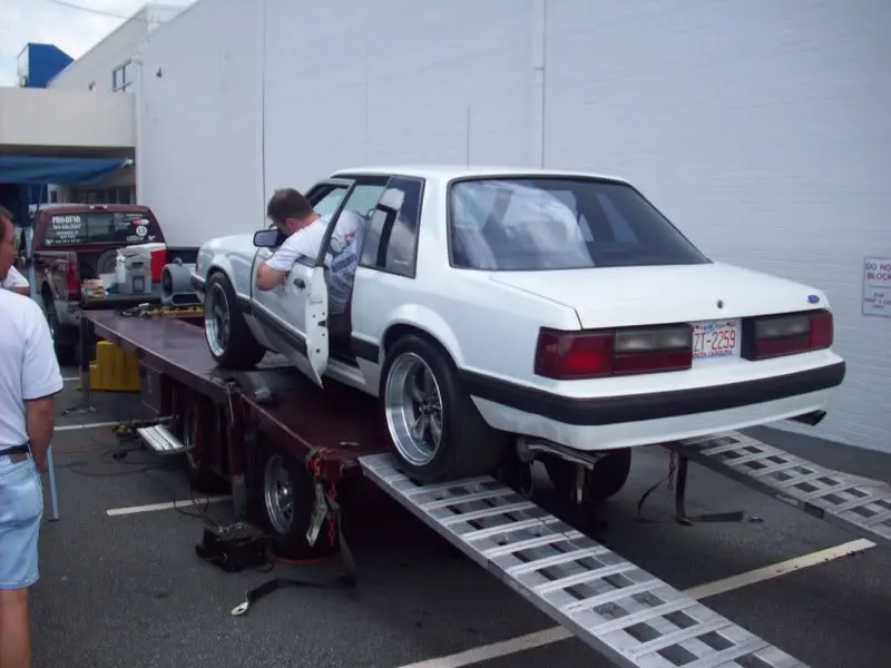

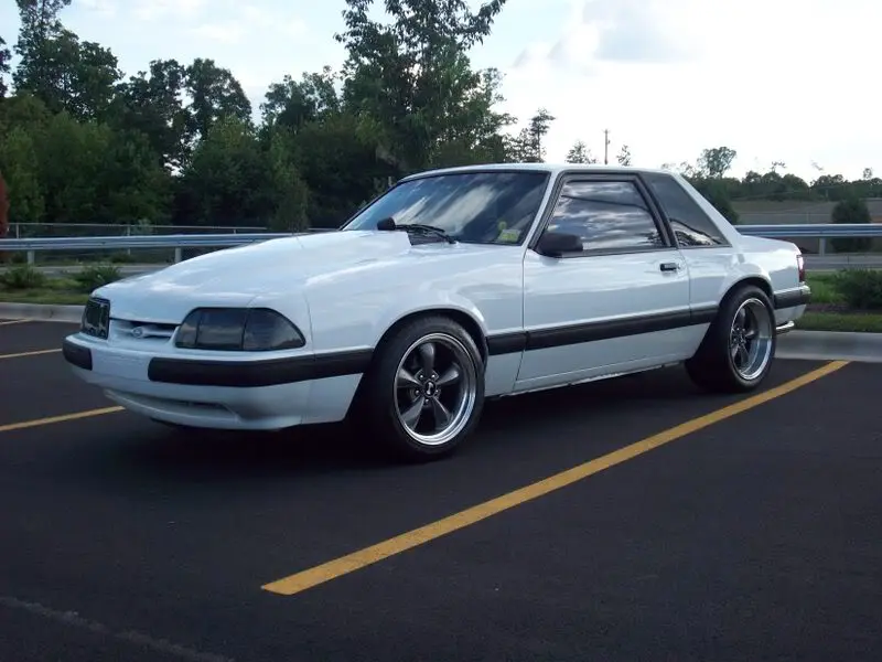

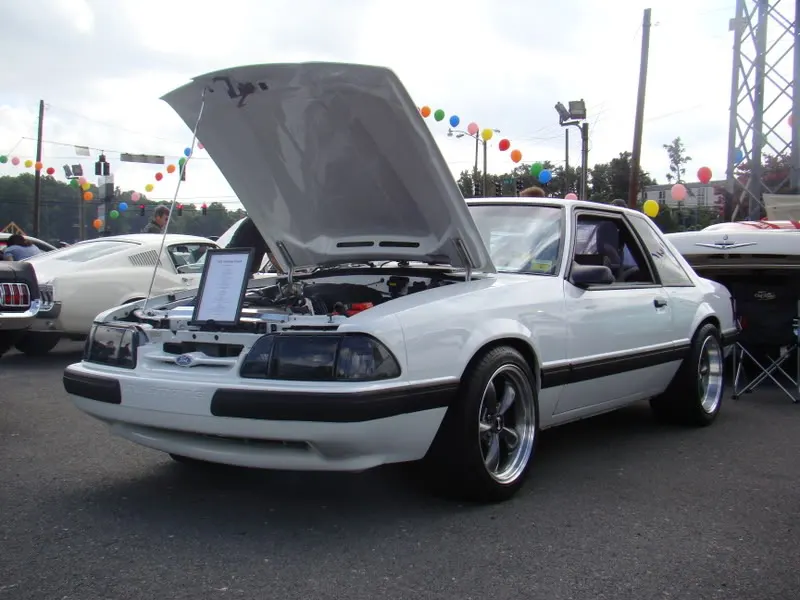

I just installed some 17x10 Pony R rims with 315/35 Nitto DR on my 88 notch.. its lowered with BBK springs, I had to roll the fenders and flipped the quads. Have some 2.5 flowmaster tailpipes but haven't had time to install them. So not sure if any modifications need to be done for them to fit.
