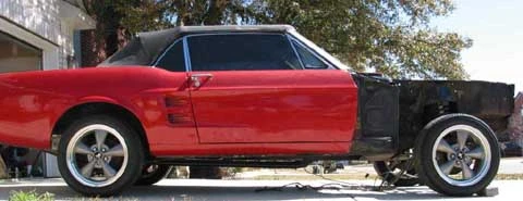

The mission: To Install my new 17x8" chrome bullet wheels on my 66 mustang. 245/45 nitto 555Rs in the rear and 225/45 hankoon tires in the front. The wheels have 5.5" backspacing so I ordered a set of custom wheel adapters with a 5x4.5" lug patter, 3/4" thick. I also picked up some Metric locking lugnuts with a key...see pic. I got some gorilla lugnuts with a NICE key with my new wheels and tires, but they were standard and the adapters were metric.
First, loosen up all of your lug nuts on all of your wheels...DO NOT remove them...just break them loose. Thank good ness I had an impact wrench (the weather was really bad today) - it saved me a lot of time.
Jack your car up....depending on what wheel you are working on...this writeup is for one of my rear wheels. Once the car is jacked up, with the tire off the ground, remove the loose lugnuts for that wheel. Then slide wheel off.
If you have an adapter slide it over the stock lugs. See pic. Next loosely tighten down the lugs onto the spacer...remember to use a criss-cross pattern. You may have to grind off the end of the lug and lug nut in order for the mounting surface for the wheel on the apdater to be flush. I ran into this problem...fortunately...my wheels had a place for the extra lug nut length to go...see pic.
Next, torque down the lugs...and the key lug nut. Again, remember to use a criss-cross pattern. Next, place wheel on. Install new lugs through the wheel, onto the bolted down adapter. Repeat procedure as you did to install the adapter. Once everything is torqued down, slowly lower the car back down!
Viola...el fin!
I have some space...maybe enough...between my wheels and my fender lips - see pics. My car sits lower on one side than it does the other...I think its because of some worn out leafsprings that the PO tried to 'fix' by putting on different length shackles...aka...third world engineering.
The rear looks like it is sitting low in the pic...and...it is...I have 75lbs of exhaust tubing and mufflers in the trunk, and there is NO weight on the front end. See pic.

this is the end product.
Maybe someone can blow up the pic a little more. For some reason, it keeps coming out SMALLLLLL.....
SHe aint pretty anymore....but id rather have her mechanically and structurally sound before she is aethsetically sound.
Two more months and she should be about finished.
