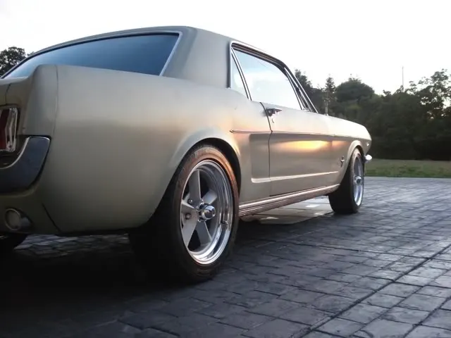

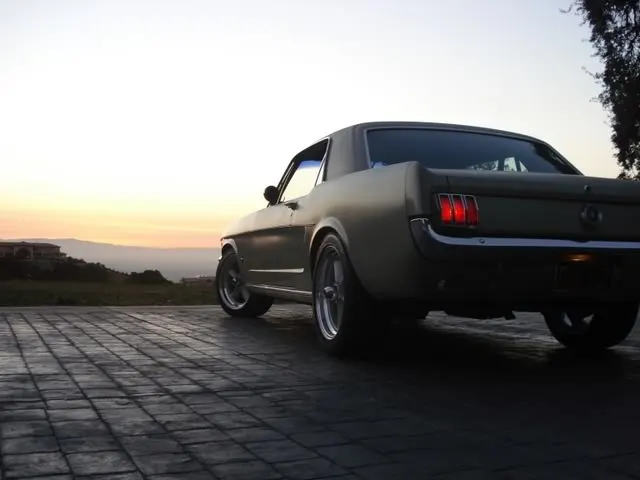

I have 17x8 with 4.75BS 225/45(front) & 245/45(rear)on all 4 corners, my fenders are not rolled or flared & have NO RUBBING AT ALL! :nice:. Ill take some pictures today and post them up in a little while. I also have -1/2 degree chamber.
Sorry, I didn't get a chance to take some pics. today, but here are a few I dug up from my file...
I plan to do the shelbydrop, which will drop my front my front end ~1/2". I will then need to roll or cut my fender lip to stay away from rubbing.

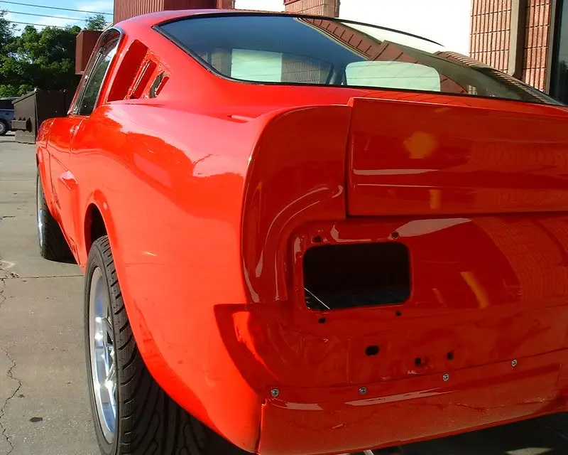

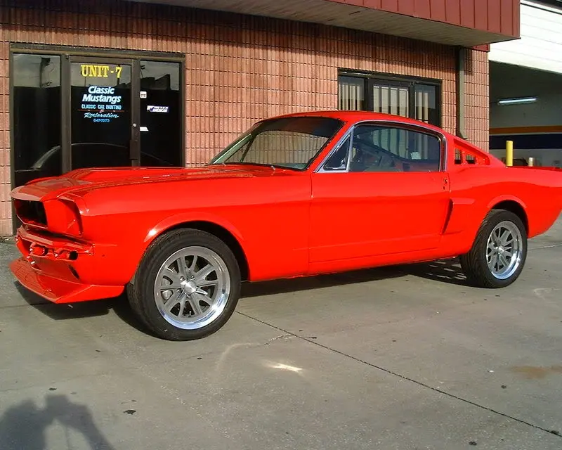

I painted this for a customer and we tried my wheels and tires. 245 x 45 x 17 on 8" rims with 4 1/4" offset. I rolled the fenders and worked on the lower front edge for more clearance. There was 1/8" clearance between the lower front fender edge while turning. He went with 8 " 4 1/2" correction 4 3/4" offset and 225 tires (I believe). It was painted Viper Red using Southern Polyurethanes (SPI) primers, base and clear.
It will sit lower when he is finished and we did not have the latch for the deck lid.
