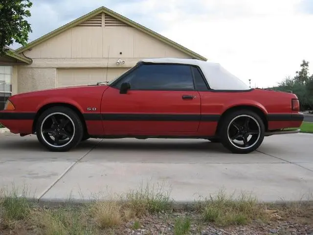

OK, I'm not sure if they have same offset but here is what I got on my car. 17x9 245/45/17. If I turn the wheel all the way it will rub a bit. In the rear I had to flip both quad shocks to eliminate slight rubbing.

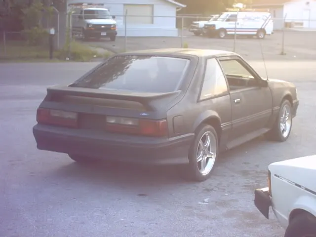

Update
Got my Cobra R's on!!!!! Not happy with the 235/45/17 tires though! They were brand new and got em for a steal, so will live with them for now. I did notice the front is just at the outer fender lip and the rear is slightly inset, just barely. Don't want to mess with spacers so I will live wit it!!

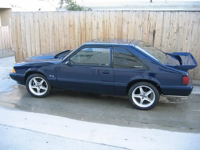

Mine are 17X9 Saleen's. Had to use a 1/4" spacer on the front because the center cap was being knocked out by the grease cap. Also the wheels would not go on without hitting the strut. Did not need the spacer on the rear, but installed them anyway to make it even. Wheels sit pretty flush, I like them. Had many compliments on the appearence . Not a great pic but hope it will do. O and it's not a LX either.
