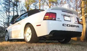

Im planning on getting a set of these wheels for my 99 cobra, But the problem im having is what size tire to run. I see alot of package sets sold with 245/40's in front with 275/40's out back. Does anybody have pics of bigger tires being used? I only wanna spend the $$ once. Thx for your help.
You can check my profile. The max size for an attachments are 78kb, which is tiny. I'm running 18x9, 18x10, 265/35ZR18, and 295/35ZR18. I know on my car I had to add 2 clips on the rack because the 9" rims on front were making contact withthe rear of my control arm under full left or right steering. The extra clips on the rack keeps the wheel from traveling as far left and right.

I have Kenny Brown springs which if I remember correctly, was a 1.75" front, 2" rear drop. Might be more. I know it sits pretty low but not slammed by any means. I went with 35's. They are a little lower profile, but finding 315/35's are a PITA, and super expensive! So I went with 295's. I bought Kumho MX tires. They are the best street tires Kumho makes. About $900 for the four. But they are soft, so if your car is a daily driver you may want to go with a different tire. Mine are also white, go try to find a set..... you won't. LOL, I had them custom done.
